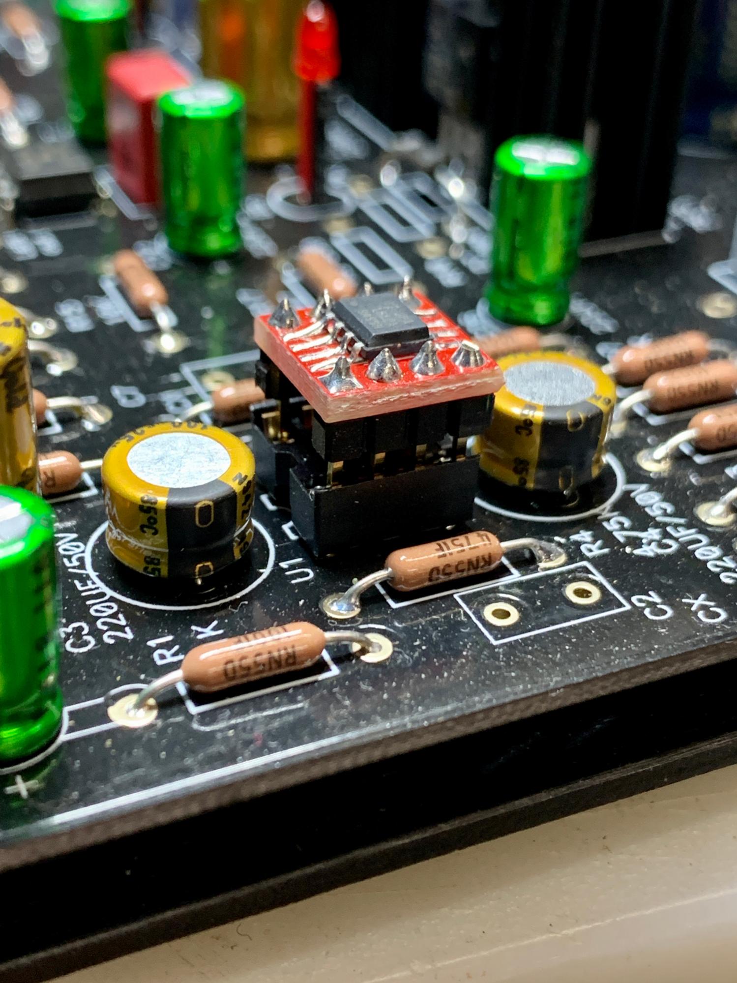

I just picked up a "Brown Dog" to try the OPA1612A and there's definitely a subtle improvement for my setup. It seems to liven the amp up a bit more and provide a bit more impact and detail.
Quick question, I followed the recommended build from the guide on the 1st page, and measured Vcc (Pin1 <-> Pin8 on the DIP-8 adapter) to be at 15.99VDC. I know 6L6 mentioned there should be 17V across the rails in the standard configuration. The OPA1612 datasheet states "Wide Supply Range: ±2.25 V to ±18 V" so I'm sure it's fine (and sounds great).
I just wanted to check in to ensure there wasn't something else (resistor or cap) that I needed to worry about with this particular opamp. And I'm also curious now why I'm seeing 15.99VDC instead of 17VDC.

@avdesignguru, have you noticed any additional noise when using the OPA1612?
My build is dead quiet with either the OPA2134 or the OPA1612. I'm using the Hammond chassis.
I'm not familiar with the Brown Dog adapter. I used a cheap one from amazon:
https://amazon.com/gp/product/B07R5QR9P3/ref=ppx_yo_dt_b_search_asin_title?ie=UTF8&psc=1
I used the big square pins that came with the adapter and soldered them to a socket. That assembly then plugs in snug down to the top of the electrolytic caps with the top edge of the plastic capacitor sleeves providing some insulation from the tiny PCB edges.

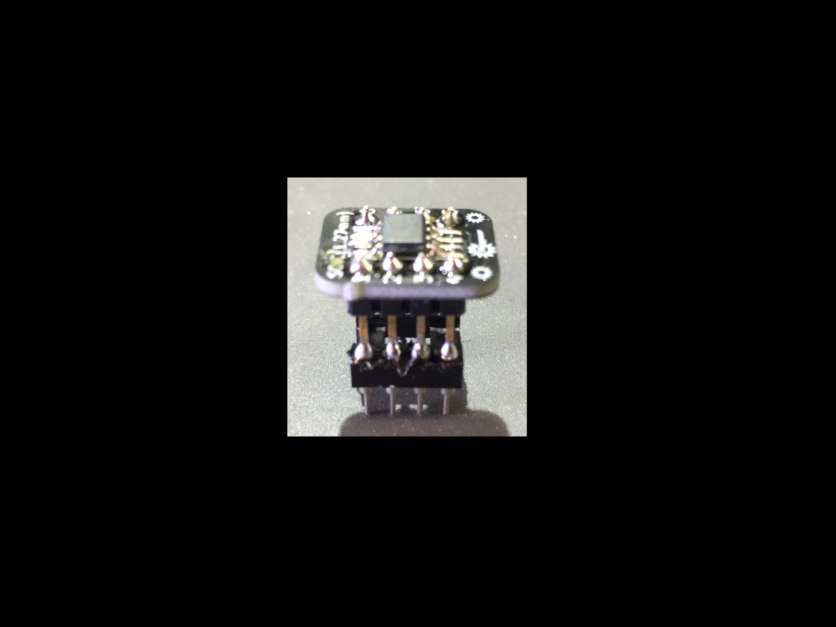

OPA1612 is my current favorite—sparkfun board and added some pins (Also love OPA627—2 singles on browndog adapter, and OPA2107). It's probably some combo of phones and music styles who knows.
Both of my builds are dead quiet. The current one with the pot soldered to the PCB in a 1U has less noise I can hear when messing around inside the the case—signal wires to pot vs none—both are quiet when sealed up. I make sure to rough up the anodizing (Modushop/DIY store aluminum chassis) between all connecting parts, evaluate noise with lid on. I built as speced with cap on inputs. Both builds have wood fronts and both of them I ran a ground wire from the pot to the star ground point (big ring connector that I sandwich with the washer for a tight connection)—If I didn't I'd get some buzz when touching the vol knob. Had the same issue with BA18 Pre.
