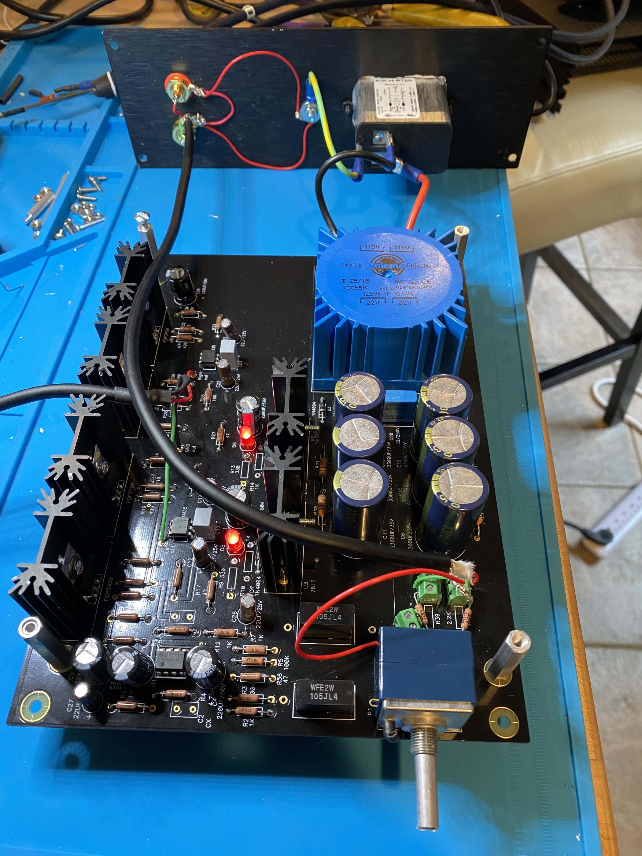

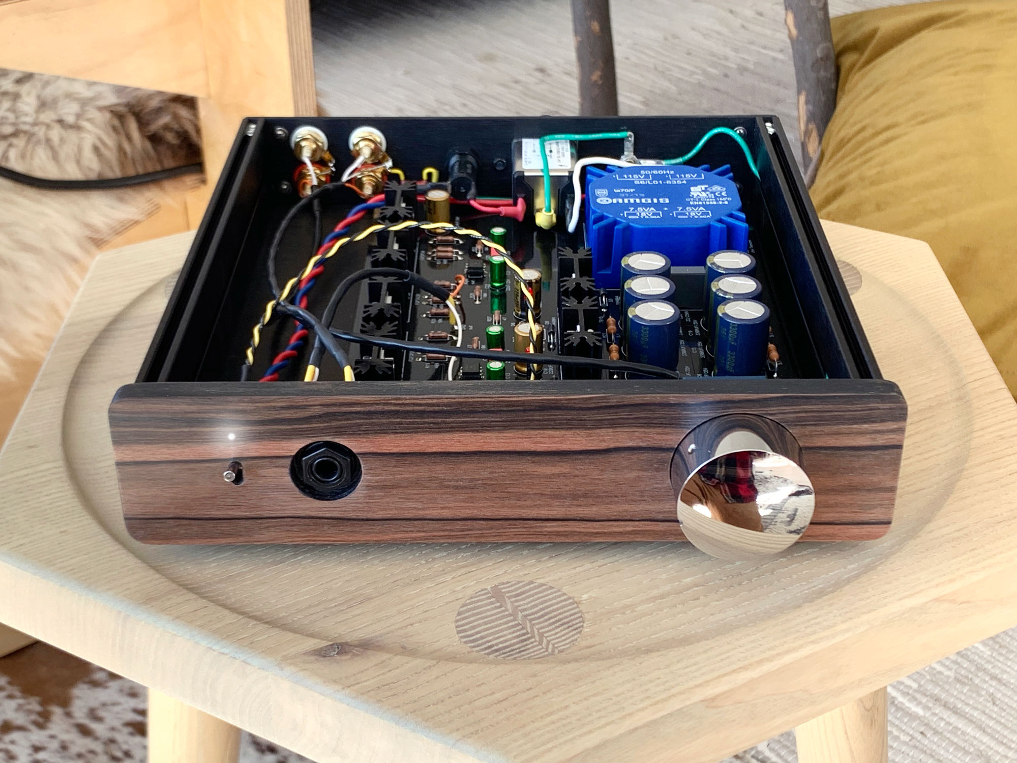

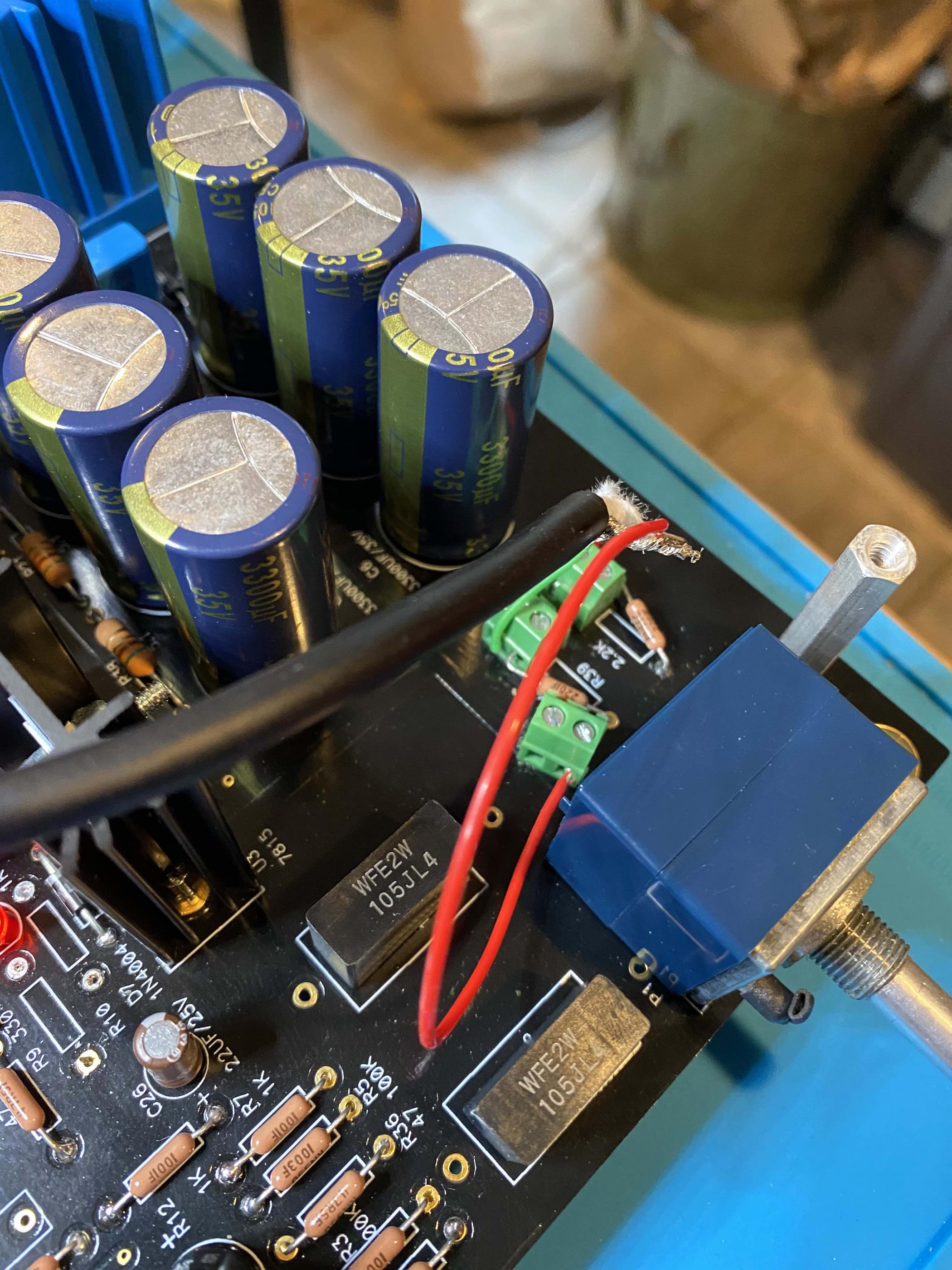

I think that's your problem. You don't have the RCA grounded to the input of the amp. The signal circuit is incomplete. The RCA grounds (tabs) go to the cable's shield and then the shield is connected to the ground hole (which is inexplicably unlabeled on the PCB...) at the input. Photos and captions from this thread, post #3 -
Input at RCA jacks.
Input at PCB. In this photo the ground wire is mostly hidden by the jacketed cable.
OHHHHH so you DO connect the ground shield on the input side to that point on the board. I was confused because the figure isn't very clear that it should be connected. The text in the build guide just alerts you to the fact that you cannot see it and its not clear that it is connected, so I interpreted that as leave it floating.
@6L6 can you please update the build guide to add this bit of clarity (or I am happy to if I can edit it just let me know how)
As a pretty big noob to all things electronic, obsessed with Whammy (and HPAs) and having built 2, I wasn’t confused by the build guide at all, and you can see the connection with a little selective zooming in for final confirmation.... YMMV.
WAY more importantly—Glad you got it sorted!!!!! How does it sound to you? Definitely read through this thread completely (if you haven’t) and try out opamps. Way too much fun.
Looks like the missing ground to the board was the culprit. Once I connect the RCA input ground to the board everything works. The preamp is silent without the cap to the ground nut, but I'll add it back when I redo the wiring.
Thanks everyone for your suggestions and help!

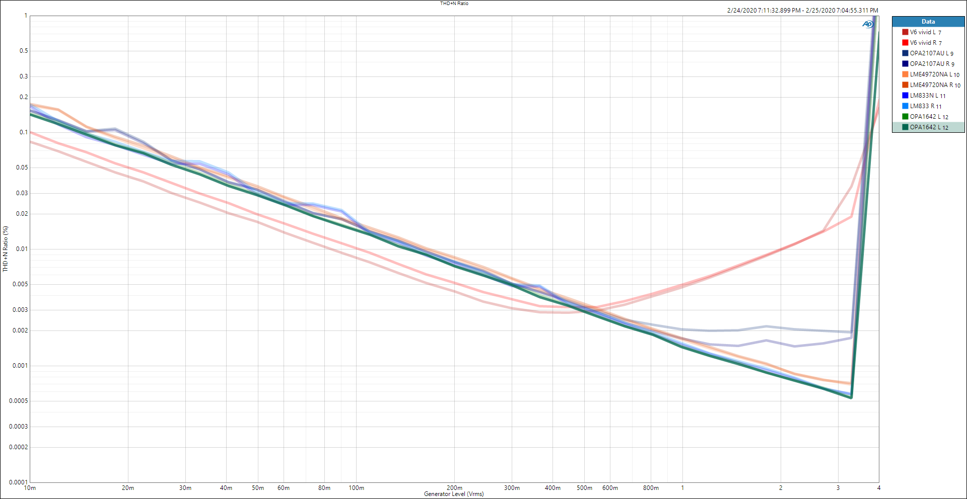

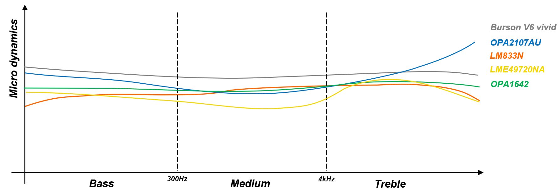

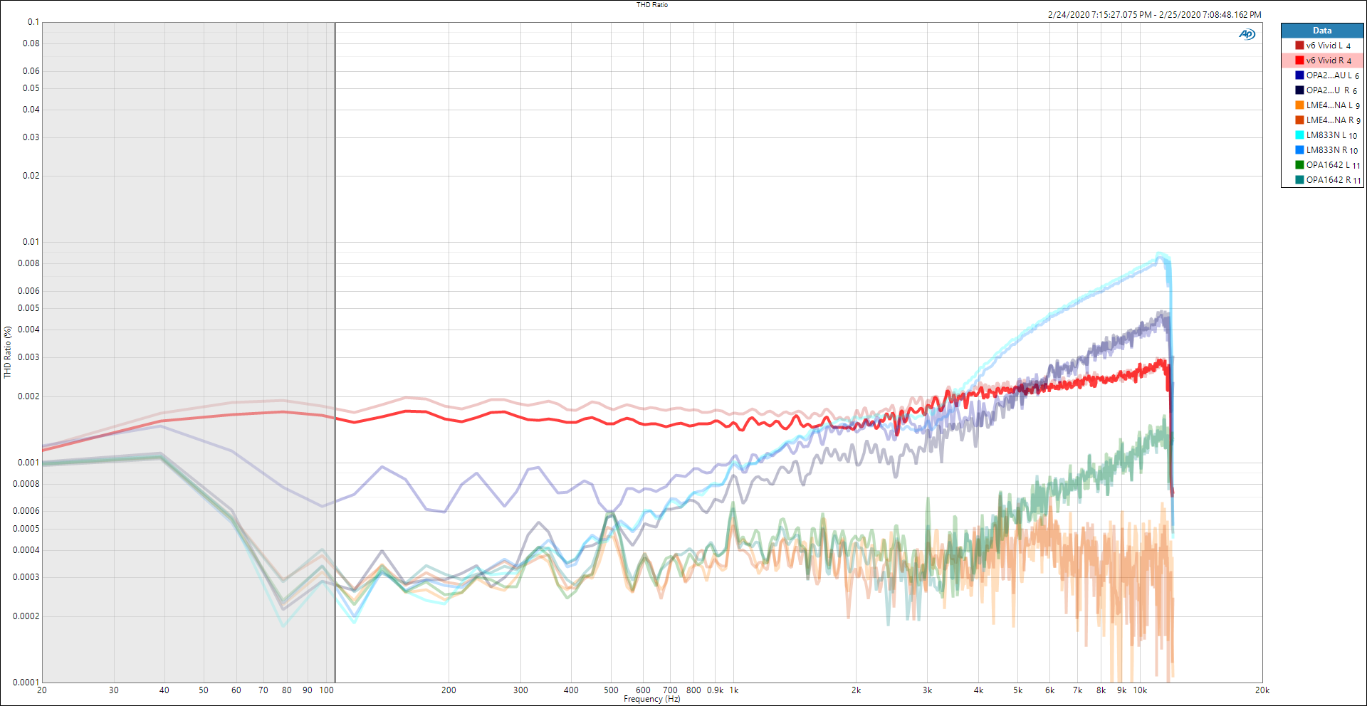

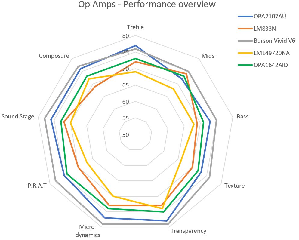

I've been measuring various Op Amps on my Whammy (Burson V6 vivid / OPA2107 / OPA1642 / OPA2156 / LME49720 / LM833N) with Audio Precision APX555.
Detailed objective measurements are available on my blog.
That's my first attempt at using Audio Precision. Any advice is welcome 🙂
Overview:
THD = f Hz OP AMPS V2.png (2Vrms output, fixed)
THD+N = f Input Level OP AMPS V2.png (1kHz)
Sighted subjective comparison was also performed. (blind testing still pending).
Yes, the V6 burson has higher distortion at highest output levels (above ~5Vrms), which realistically is never used in my case.
I have yet to perform better measurements and identify criteria that could correlate with my subjective impressions.

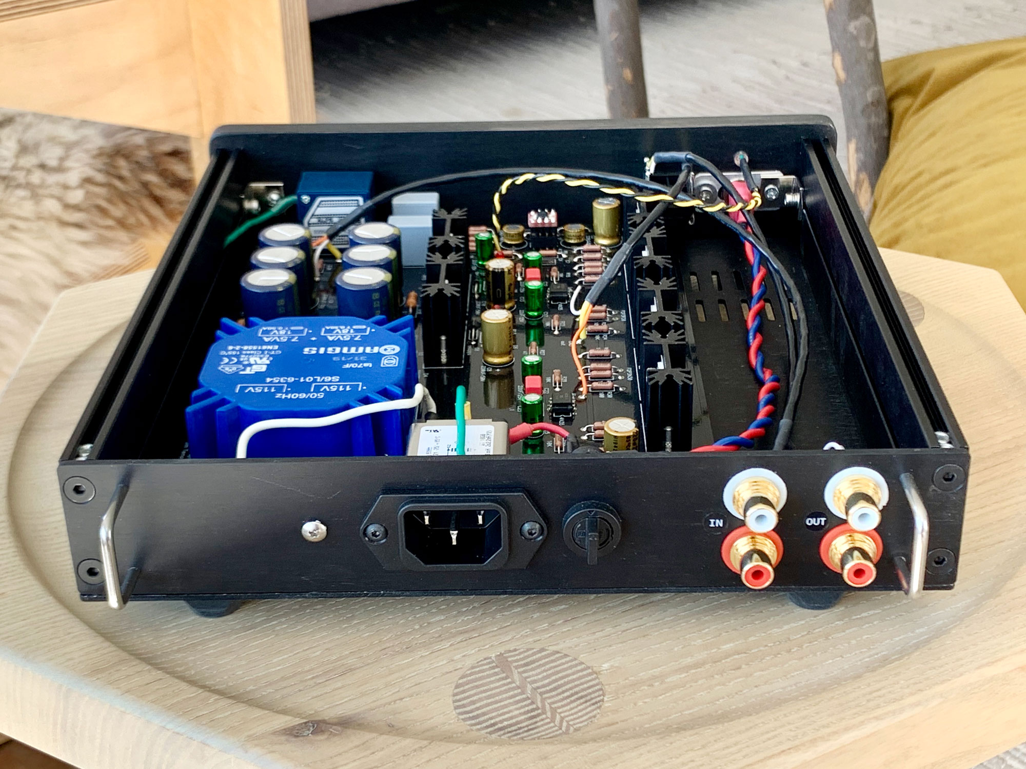

Whammy OCD continues...
I'm not recommending anyone try this—In my quest for smaller is better... But here's a dead quiet (just the like the first one I made) Whammy in a Modushop 1U Galaxy 230mm square chassis—with blind attached front plate. There was some luck involved here! It's TIGHT in there. —not the kit heat sinks, nor the kit transformer—they are both too tall for a 1U—I think I changed the PSU caps too.
Man I love this amp! Thanks Wayne.
Your work looks really nice! That chassis is too tight of a squeeze for me though. Mine sits out in the open on a piece of wood until I find a chassis that will be big enough for some things that I'd like to add to mine. Finding chassis for my projects has been difficult for me. Searching ebay and other sites brings up so much random things to sort through it's a chore to look at. I've got an Audio Note Dac kit that I want to move the power supply into an outboard chassis but can't find anything that matches it. I see Chinese chassis that look good for the Whammy but have punch outs and holes that don't match what I need to do. The chassis part of things seems to be the hardest part of DIY. I've still got Aikido preamps and a Millet NuTube buffer that sit open air on wood! I love my Whammy too!
Haha! And some deep knee bends. Thanks Mark!
(I have it on good authority you will stoking my [our!] HPA problem... hopefully ASAP ;-)
Re: chassis @YouAgain/
I would say 6L6’s original build from the guide in the hammond chassis is actually a tighter fit than my 1U. Plus it fits the kit parts in terms of height. The Hammond chassis is nice. All the Modushop stuff is also very nice. I was just tying to pull off a small layout I liked w front power switch and preamp outs and having the pot mounted to the PCB since in the my other Whammy, 2U those signal wires need careful routing for quietness....
I want a larger chassis to house a pair of stepped attenuators instead of the ALPS pot that doesn't track left to right well enough for me. I'm sensitive to small level differences and it annoys me if I can't control that. I also want to have space for larger input coupling capacitors and would like to have a switch to choose between two different pairs of coupling capacitors or no capacitor that all. Next is that I plan to use my Whammy to drive a MoFo amp where I'll need the +/- 24 volt rails to make that work (I have the transformer for that). But also want to be able to use input op amps at +/- 16 volts so I'll need outboard voltage regulation (I have super regulators for that) to make that work. Also I have several different flavors of discrete op amps that I use in microphone preamps that I'd love to try in the Whammy. I'd have to build a daughter board to make that possible. Last is I have some good Jensen line input transformers that I want to use to switch the absolute polarity of the input signal. Those can also at the same time provide a balanced input option. So my family of ideas would not fit into the tiny apartment of a chassis that everyone seems happy to build with.
Looking again at your front panel... is that rosewood?
I’d like to see all of that! Mofo is super sweet. On the build list.
Front panel is marble ebony.
