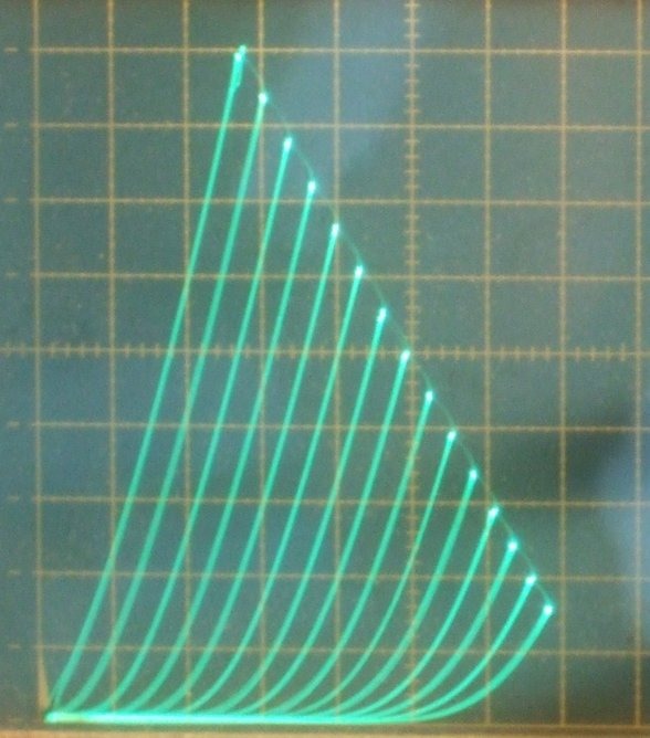

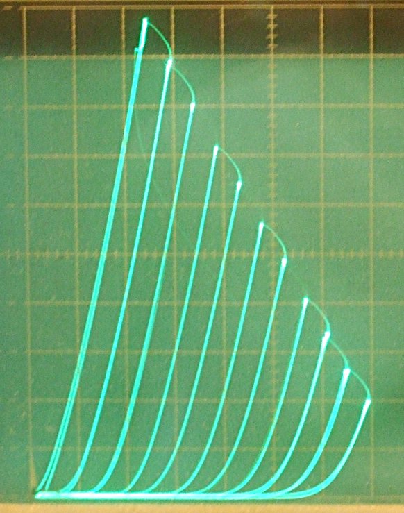

This is precious! A linear driver triode with mu of 50 and Rp of 2K (is that true?) and 350 plate volts? Am I day dreaming? Two-stage 845 or GM70 made possible?Ummm, how much is a WE 12AX7, KT88, 6L6GC ..... going to cost? $$$$
For DIY you can still get a 21LG6A for $4.
6CB5A or 6EX6, 6LU8, 6GF7, 6EW6 for $5.
21HB5A, 17KV6A, 25HX5 (E235L sub), 6JC6A for $6.
12GE5, 8136, 38/12HE7, 12HL7 (best driver tube and top notch triode mode ever made), 38/12HE7, 6KR8, 6KV8 (2nd best driver tube ever), 6LY8, 6LQ8, 6HZ8, 6197, 9KC6 (D3a sub), 10JA5 (EL506 sub), 6BN11, 6GF5 ......... for $3. And Soo many others.
And they don't take months to arrive. Who cares about Russian tubes?
1st pic 9KC6 with +24V on grid3, 36000 gm:
2nd pic: 12HL7 in triode mode, 20000 gm, mu 50:

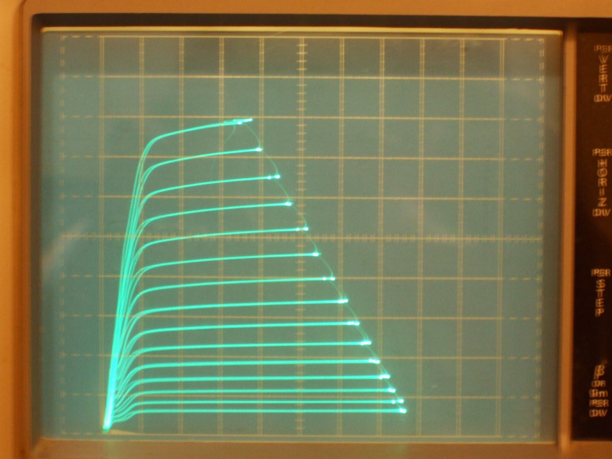

3rd pic 6LQ8, 6KV8 pentode in triode mode, gm 21000, mu 50:
View attachment 1036050View attachment 1036051View attachment 1036052
But there must be some caveat. With 30 mA/V transconductance, wouldn't oscillation be a problem?
Indeed, who needs Russian tubes or whatever pretends to be Western Electric?
Now 12HL7 can be had on eBay for $4 if one isn't picky. Inflation...
The more the merrier. Any production at all, even at a niche high price point, will drive the entire market to be more affordable.Ummm, how much is a WE 12AX7, KT88, 6L6GC ..... going to cost? $$$$

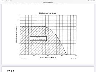

Unfortunately, you are dreaming. Even in triode the screen grid does conduct some current, and going above 300 probably isn’t smart. At 330 the rating goes to zero - on most TV tubes its the screen that limits the useable triode operation range. $3 on vacuumtubes.net - at least the last time I looked. I still prefer the 6KV8 because you get a useable triode for free in the bottle too, and 20 mA/V is plenty.This is precious! A linear driver triode with mu of 50 and Rp of 2K (is that true?) and 350 plate volts? Am I day dreaming? Two-stage 845 or GM70 made possible?
I don't think that's a big problem. At 200 V, the screen still has full dissipation rating of 1 W. Appropriate value resistor between plate and screen will ensure safe operation, without significant effect on triode characteristics. I believe stability is a problem with such tremendous gm. Matcing tubes may be also problematic.Unfortunately, you are dreaming. Even in triode the screen grid does conduct some current, and going above 300 probably isn’t smart. At 330 the rating goes to zero - on most TV tubes its the screen that limits the useable triode operation range. $3 on vacuumtubes.net - at least the last time I looked. I still prefer the 6KV8 because you get a useable triode for free in the bottle too, and 20 mA/V is plenty.
