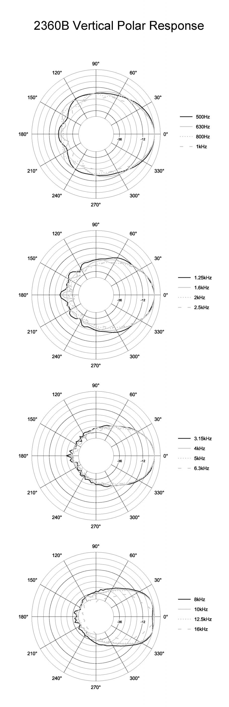

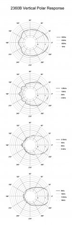

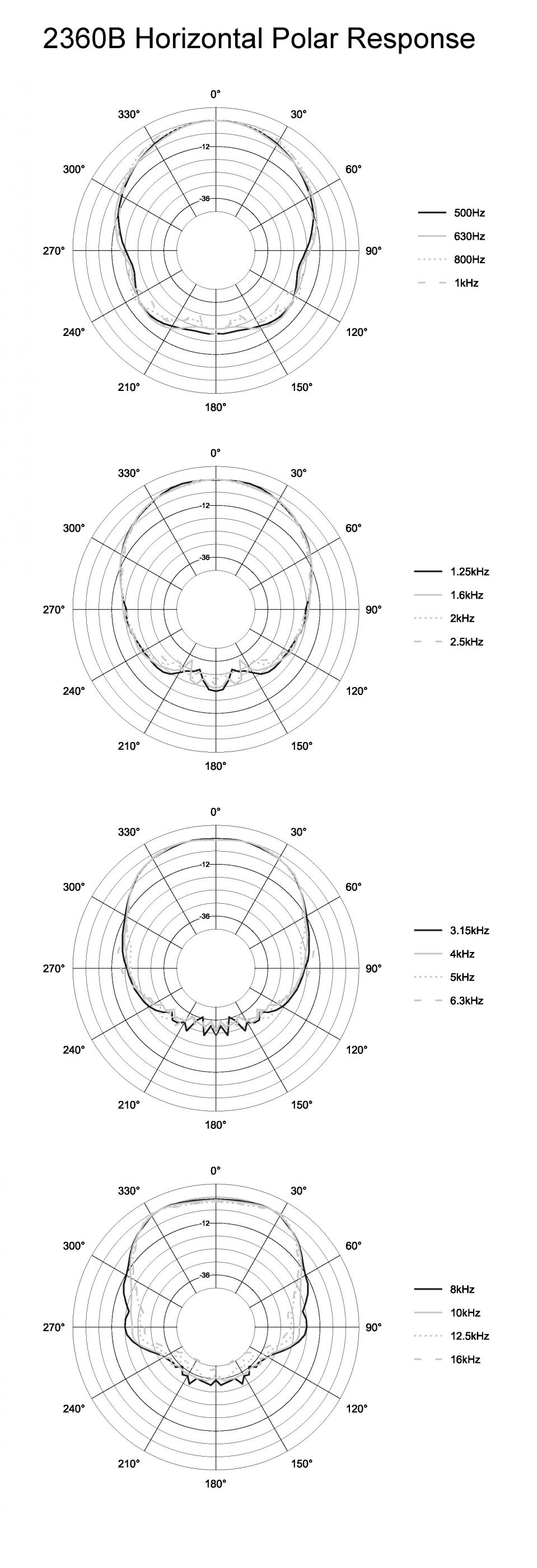

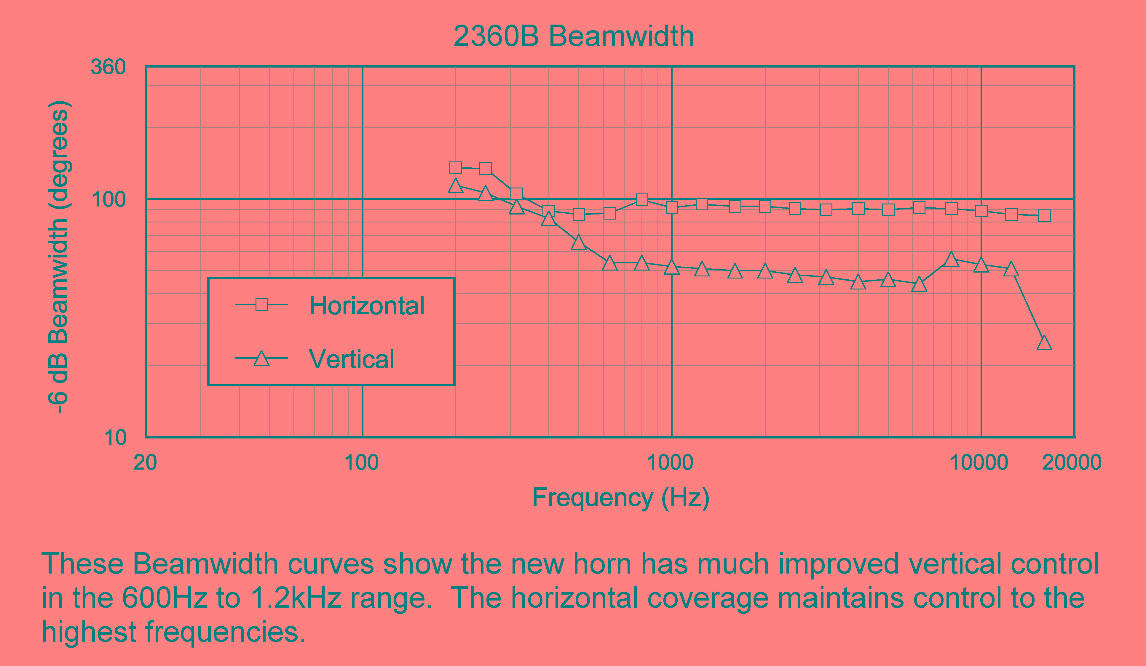

Thanks for the polar curves. They should be compared to the modern (1980's) equivalent.
David S.

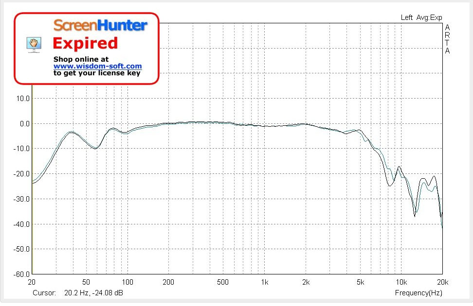

The site will not let me d/l the image. I requested a copy of the jpg from the original poster to put up here.
here it is
Snagit

Thanks Zen Mod,
Those are decent curves and also a pretty good pair match.
Note that these are impedance tube measurements. That means they represent the response into an ideal resistive load. In the end the frequency response of the horn/compression driver combo is the curve shown, modified by the bottom end response of the horn, then by the top end beaming of the horn, plus any polar curve stuff going on.
They are about 20 dB down at 10K, so horn beaming won't likely EQ them to flat on axis, at least not much above 6kHz.
Still, pretty decent.
