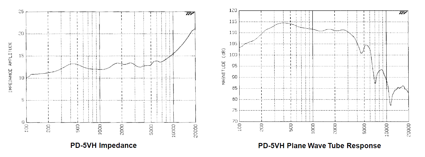

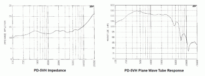

Anecdotally, I have heard that the Atlas K-55-V, introduced in 1961, was supposed to be a 555 clone, albeit with a perm. magnet and phenolic 'phragm. It's no longer it production, but its direct descendent the Atlas PD-5VH is.
Here's the PWT curve of the PD-5VH.
