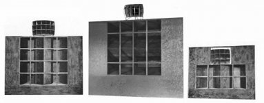

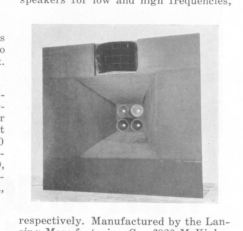

2 Shearer prototypes that were shown in the January and March issues of Electronics Magazine, 1936 (Courtesy of Steve Schell).
Yes, it's a rare beast.

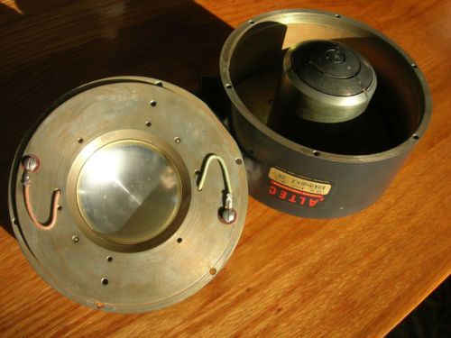

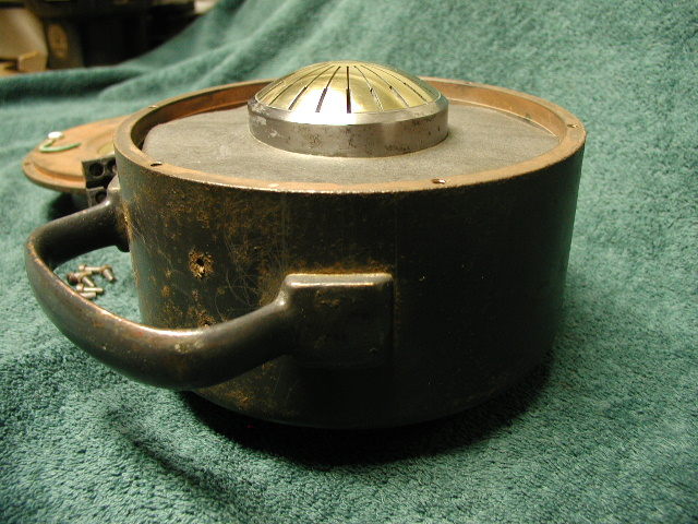

Here's some info on the 284.
Some images of the 285's radial phase plug versus the concentric annular ring slots of the 287's plug.
