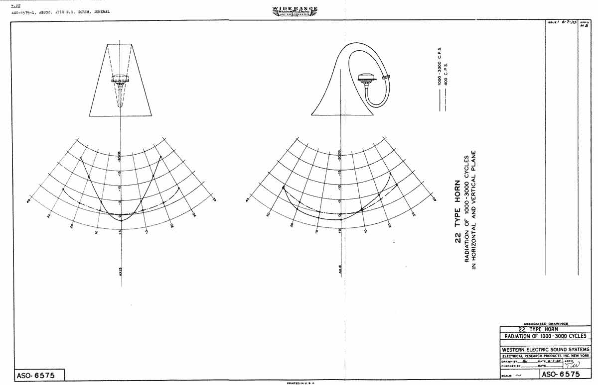

He is a WE sheet on the dispersion characteristics of the "small" 22A horn, showing the skewing of HF pattern. Not a problem unless you are in the cheap balcony seats.

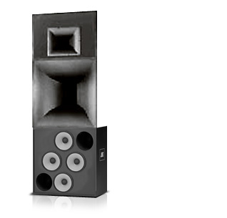

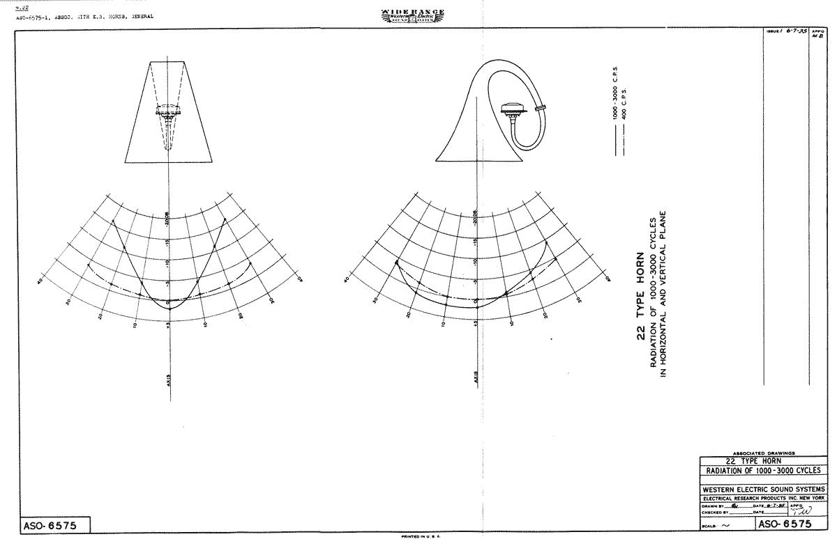

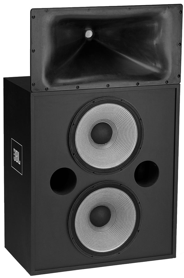

These 22As were sometimes installed in side by side pairs with a visual aspect similar to the twin driver 16A octopus horn, yielding more regular vertical dispersion at the expense of horizontal beaming...but I suppose the geometry of the room determines whether that is a good tradeoff.
Who was saying that they couldn't measure frequency response until the 1940s?
