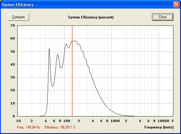

50% is just the theoretical maximum for the perfect horn system.
Re. a 50% maximum, I may be guilty of spreading obsolete theory here.
I went looking for the origin of this. The early Olson (RCA) articles don't support it and he shows some theoretical plots with motional resistance as the numerator term and the ability to approach 100% if Rm is much greater than Rd ("damped resistance of voice coil"). His practical example, which appears to be the "8" full range horn unit" that Shearer and Hilliard rejected, hovers around 30%.
Beranek assumes a higher Rg (amp source resistance) and factors that into efficiency. He gives and example with 24 ohms drivng it (!) and, with an optimized throat size he achieves 22.1% efficiency. He recalculates the same system with a 1 ohm driving source and sees the efficiency drop to 2.4%. He concludes that "for maximum efficiency the amplifier impedance should approximately equal the loudspeaker impedance."
If it is as simple as that, then this would get us to the usual generator/load relationship where maximum power transfer is when the load resistance equals the generator resistance. If the load is higher, then it will get more of the open circuit voltage but less current will flow. If it is less, then more current will flow but the loads voltage will drop. Maximum power transfers when the load equals the source and both share half the power, i.e. 50% efficiency.
Keele initially repeats the 50% maximum and calls it "power available efficiency", still assuming that the maximum power transfer will come from matching of source and load.
http://www.xlrtechs.com/dbkeele.com/PDF/Keele (1976-05 AES Preprint) - Efficiency, Horns vs DR.pdf
Leach does a good analysis too, for those into horn theory.
http://users.ece.gatech.edu/~mleach/papers/HornPaper/HornPaper.pdf
Keele finally gets past the notion with this analysis:
http://www.xlrtechs.com/dbkeele.com...Maximum Efficiency of Compression Drivers.pdf
Here he splits the notion into "Nominal power transfer efficiency" which has a 50% maximum due to a presumed doubling of Dcr by optimum horn loading, and "true power transfer efficiency" which can approach 100%. I now think this is the more proper way to look at this.
