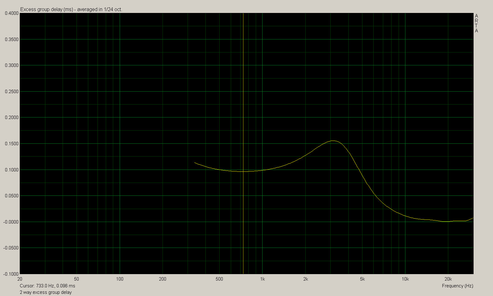

Acoustic centre misalignment doesn't introduce a hump, it introduces a step. So if your tweeter is ahead of the woofer by 0.2ms then there would be a flat delay of 0.2ms through most of the midrange drivers range, then a further increase at the crossover due to the allpass function then it would drop away to zero.
I don't think the audibility of this type of group delay step has been studied in the same way that allpass delays have been, and I don't think its safe to simply take the threshold figures from one and apply it to the other.

Here's an example of what I'm talking about. Tweeter is 20mm ahead of the midrange, 3rd order crossover, you can see the bump from the crossover and the shelf from the acoustic centre offset. (The measurement isn't valid much below about 1Khz due to the FFT window time I used for that particular measurement, it should remain flat a lot lower than that)
An error as small as 20mm introduces nearly as much group delay as the peak delay from a typical crossover all pass response, but over many many more octaves. There are certainly plenty of speakers with more than a 20mm error between midrange and tweeter...just saying... 😛
