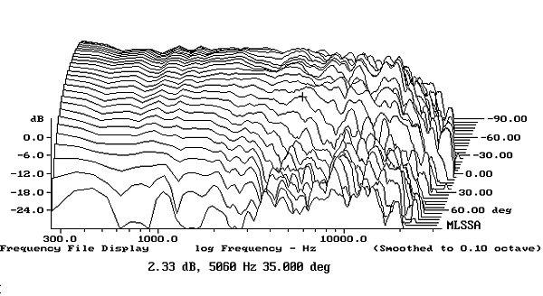

Let's do something notably lacking from the WE contingent, and study their measurements. I'll use Stereophile's measurements on the most recent iteration of Peter Walker's work*:
Toole Recommendation 1: smooth on-axis response. Quad? Check.
Toole Recommendation 2: smooth off-axis respons. Quad? Pretty good through the midrange, narrows above that. I'd call that a check.
Toole Recommendation 3: deep extended bass. Quad? Not so much. See nearfield FR, supra, and note that JA's mike technique exaggerates the upper bass, so there is some rise but not much and then a pretty steep fall.
That said, I could never live with Quads, even with big dipole subs under them. I just like full-scale presentations of Shostakovich, Mahler, and Radiohead too much. 🙂
*Quad hasn't done much new. The current speakers are basically the old speakers with more frame rigidity and a little more bass.
