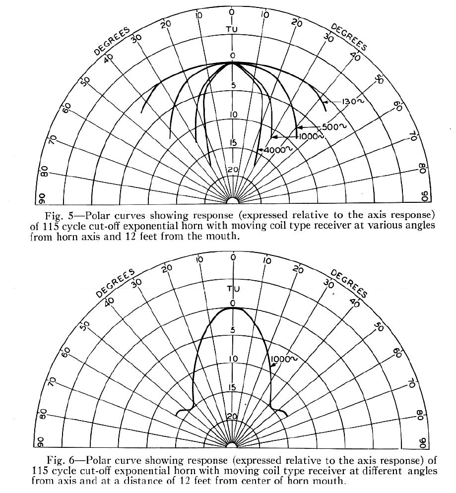

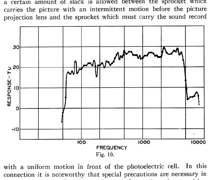

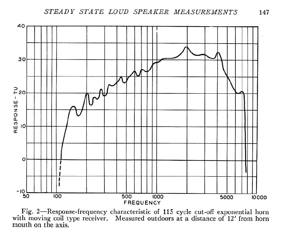

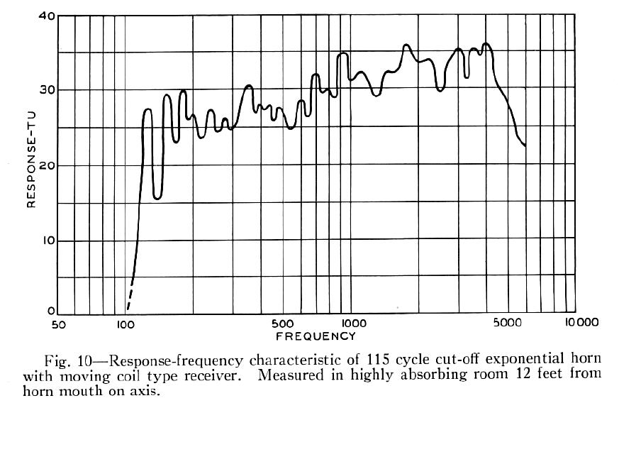

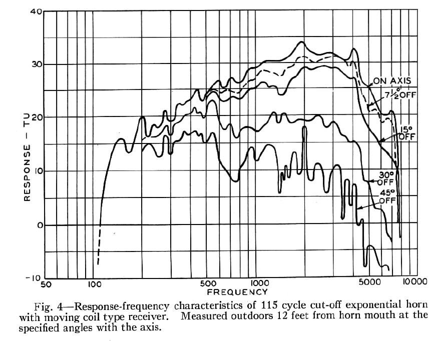

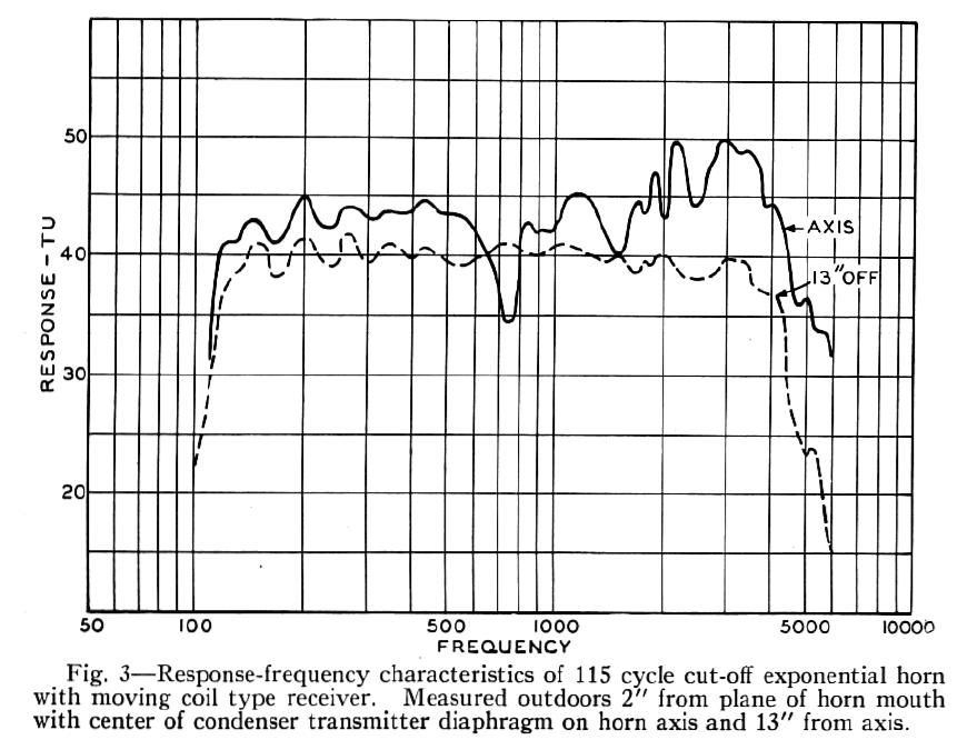

I found a number of Western Electric response curves in their various papers. (see Lucent site referenced yesterday).
http://www.alcatel-lucent.com/bstj/vol08-1929/articles/bstj8-1-196.pdf
A Sound System for use in Motion Picture Theaters is mostly about the projector with sychronized record player as used in the initial Vitaphone system. The response curve of the horn looks like the damped room measurements of the second article. (see indoors vs outdoors, the curve using the rotating microphone). The same basic response curve with about 15dB rise in the free field response or 10dB in the in-room curve due to the high frequency deadening of the room and the high HF directivity. I have to assume this is a curve of the 15a.
http://www.alcatel-lucent.com/bstj/vol08-1929/articles/bstj8-1-135.pdf
The second article Acoustic Consideration in Steady State Loudspeaker Measurements is a good tutorial on the subject of response measurement and looks both at a horn and a 3.5 inch direct radiator measured out of doors, in a deadish (felt lined and curtains) room and finally via an averaging technique where the mic was moved in a circle to reduce standing waves. The outdoor curves include a set with off axis curves revealing the high directivity that a long exponential horn would have to have (before the evils of diffraction slots!).
Note that the 115 cycle horn appears to be the smaller folded horn as developed for the Victor Orthophonic Victrola. It has the same characteristic response as the first theater horn above, very similar artifacts at 400-500 Hz and the top Octaves, but gives up an LF Octave compared to the 15a. Both have the same rising or shelved up upper range, at least on axis. The polar curve of the larger horn would have to be the same but shifted down (same polar nearer 500Hz that this has at 1000).
Not very flat but reasonably smooth. In a cinema application the very high directivity would have to be considered when trying to achieve the best audience coverage or even in determining what the average response curve is. This shows why the articles indicate that they were used in groups of 4 for large theaters: a splayed pair aimed down at the audience and a second splayed pair set low and aimed upwards to the balcony. The Altec designs with multicell horns, of your choice of cell configurations, would be more helpful in that regard.

OK, so what's with the rising response in the W.E. measurements? Most horn measurements I know tilt the other way. What's going on with the 15A and the 115Hz horns?
Fairly flat power response out of the compression driver and constantly rising directivity of the horn. This is inevitable with a low cutoff exponential design working over many Octaves. Directivity for the treble is formed way back in the throat where the wall angles are very narrow.
A horn good to 60 to 115Hz has to have a very slow flare rate.
Most later horns in the preCD horn era worked well above the 3k mass break point. They tended to balance falling power response above 3k with rising directivity and give just flat axial response and strongly falling off-axis response.
The fairly flat power response from the compression driver is also different than modern practice. Most modern units push the resonances up as high as possible so the are flat to the mass break point and then roll off at 6dB per Octave from there to 15 or 20k. The 505 pushes some parameter downwards to get flatter response to about 4k, and then a steep rolloff from there. Response is flatter but less extended. This is like the comparison between a JBL 2440 and a 2441. 2440 is flat to 10k then dies. 2441 rolls off first order from 3k, but makes it to 16k.
