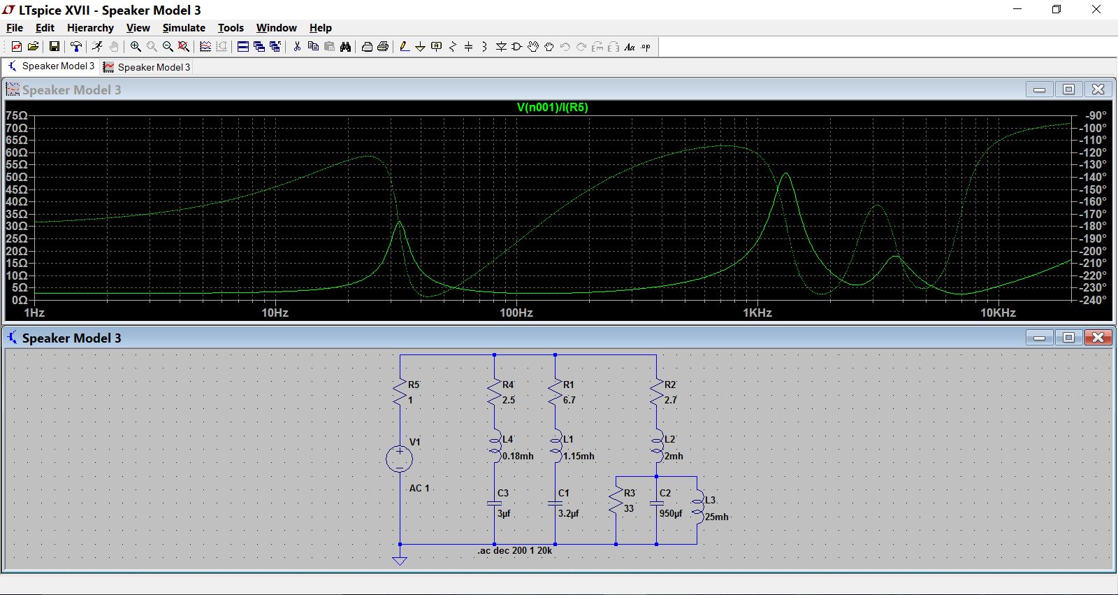

Hey Mooly, I could sim the load once I have information what kind of a loudspeaker type ( how many ways, how many woofers, mids). Maybe two 8" woofers in parallel, one 8 ohm mid and one 4 ohm tweeter, in a vented cab with a realistic XO filter.
Thanks 🙂

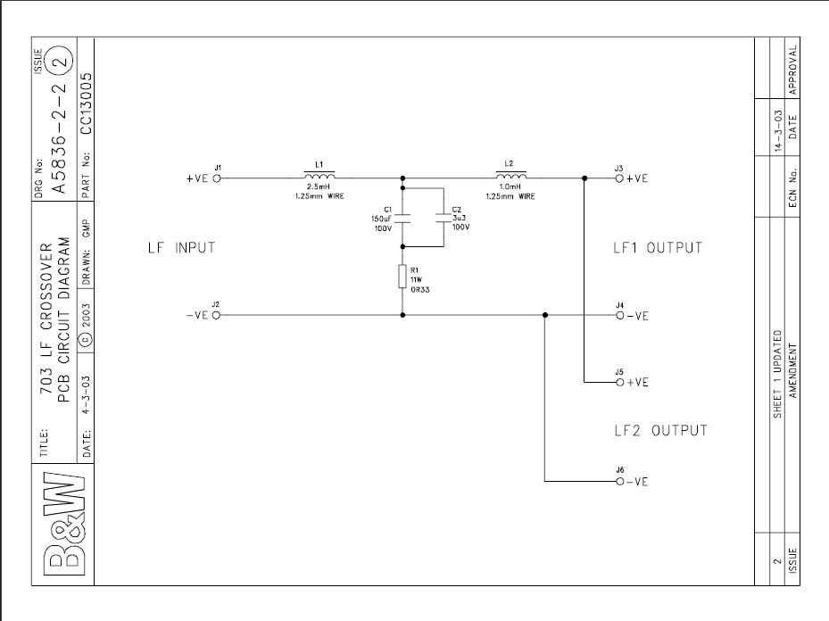

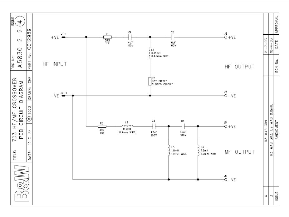

I was trying to make a load that was something like my B&W 703's. I know they are reputed to be a little difficult but I couldn't find a proper plot anywhere.
B&W 703, HTM7, 705, ASW750 surround speaker system Measurements | Sound & Vision
It uses two bass drivers in parallel.
The B&W 703's ported enclosure is tuned to approximately 32Hz, and its minimum impedance is 2.8ohms at 100Hz. The impedance remains below 4ohms from about 79Hz to 400Hz—a region of the frequency spectrum that is dense with fundamentals and requires more of an amplifier, over time, than even the deep bass (which makes huge but less constant demands). I would judge this speaker to be moderately difficult to drive. For that reason, I would conservatively rate its nominal impedance at 4ohms. The 703's sensitivity measured about 88dB/2.83V/m.
Read more at B&W 703, HTM7, 705, ASW750 surround speaker system Measurements | Sound & Vision
