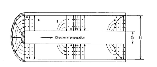

The coax specs you refer to are reasonably accurate over a fairly wide range of frequencies. While there are not abrupt transitions from one mode to another, the specs probably good from around 100 kHz at the low end, up to somewhere in microwave frequencies at the high end. Below the low end, the effective current path is not exactly in the longitudinal direction of the cable, and that is due to the effect of eddy currents induced in the wire. Current ends up taking more of a spiral path through and along the wire.
At the other end of cable models, at very high frequencies eventually the dimensions of the wire start getting close to 1/4 wavelength of the signal frequency and waveguide propagation modes become increasingly significant. In addition, at very high frequencies dielectric constant becomes a complex number with an imaginary component. Again, the usual published equations become increasingly inaccurate.
Okay, we are only interested in the low frequency stuff here. As jneutron has pointed out, the standard equation for characteristic impedance of wire is based on some assumptions that are not valid at audio frequencies. Instead, a Bessel function solution to Maxwell's equations is much more accurate.

The 1/20 wavelength figure you mention is a reasonable approximation when a cable is behaving as a typical RF transmission line. Attached below is an illustration of the EM fields relative to the direction of propagation. In that mode, the 1/20 rule of thumb could be used. However, that's not what happens in the cable at very high or very low frequencies, and the rule is not accurate in those cases. At low frequencies, eddy currents in the conductors cause current flow to spiral around, rather than flow directly along the direction of the cable length. At very high frequencies different things happen, but we don't need to worry about those for audio purposes.
