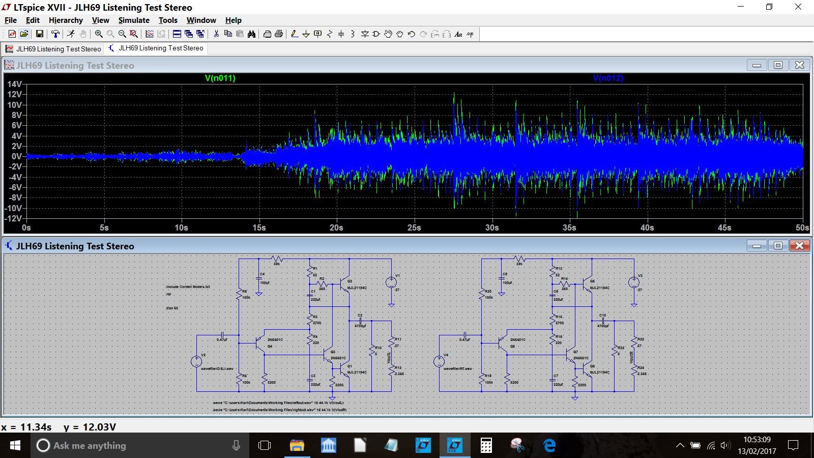

This picture gives a clue as to what we are listening to. This shows the JLH set up for a stereo listening session with capture of both channels.

Did you have to do anything to "normalize" the output WAV files? One place I read about this process mentioned that LTspice may "panic" when the output exceeds 1V. Based on your screen capture, I am guessing not... But, thought I would ask.
This is definitely something I must try with my own circuits. How long did the simulations take?
EDIT: Are we to send you conjectures about which amp corresponds to which clip, or are they simply in the order you listed?

I ran the simulations on a Dell laptop that has 4Gb RAM and an SSD. They didn't take too long per run, perhaps 10 to 15 minutes for the Europa and JLH. My amp is considerably more complex in design and that took longer.
For the levels, I looked at how the ripped track looked in Audacity with regard to peaks. The JLH with its 27 volt rail was the 'lowest denominator' and so that set the initial levels.
I then rigged up an attenuation network at the output such that the output of a test 1kHz tone had the same amplitude as the input. That step was done for the other two amps.

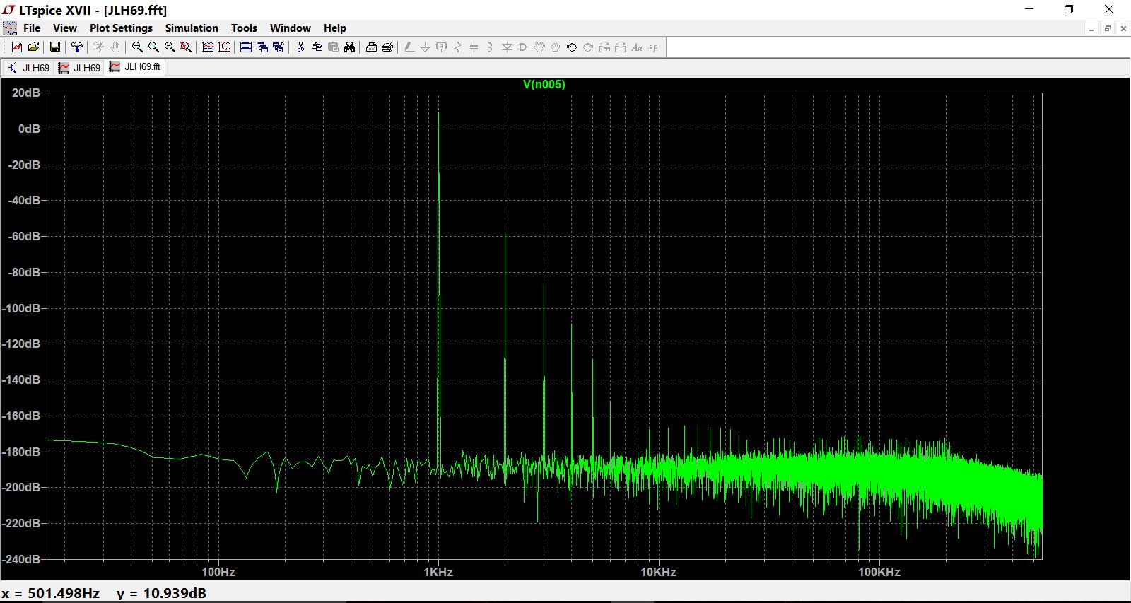

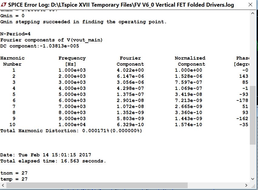

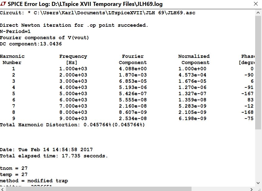

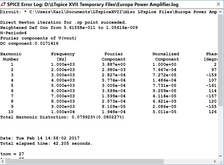

These are distortion figures and FFT plots for the Europa, The FET amp and the JLH respectively. Level playing field at 8 ohms for all.

Interesting, Mooly. From looking at the Fft and that you use vfet, the chance is small that your fet amp is not the best sounding one. The fft shows a class A characteristics. It must be ccs loaded instead of bootstrap like jlh. But jlh is designed to have unconditional stability without compensation. Your amp should use cap compensation to achieve similar stability. How you do it is the remaining variable.

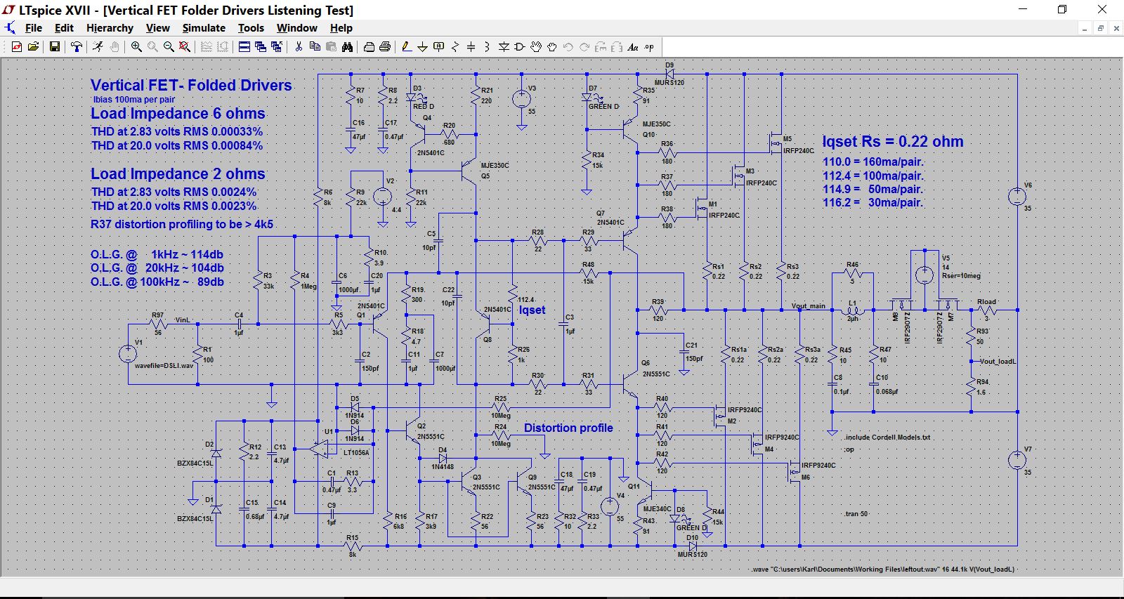

It is quite a complex amp, the circuit is below.
Had a quick look at the schematic - are you really using a pure voltage source for the power supply? If so I reckon they should sound perfect as in my experience its the PSU which gives the amp its sound :D
Yes they are all pure DC voltages and I agree it could be interesting to try this with real rails that include ripple and that also have a bit of impedance.
I thought afterwards that using a more complex load might have been a better idea to. Wonder how all that would affect simulation times.
That said, we are happy to simulate designs using the methods here, and then take those designs to a real build so its perhaps a fair starting point.
I've had a comment via pm saying that one of three definitely sounds inferior to the other two. But which one ;)
