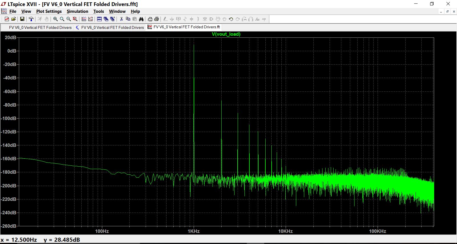

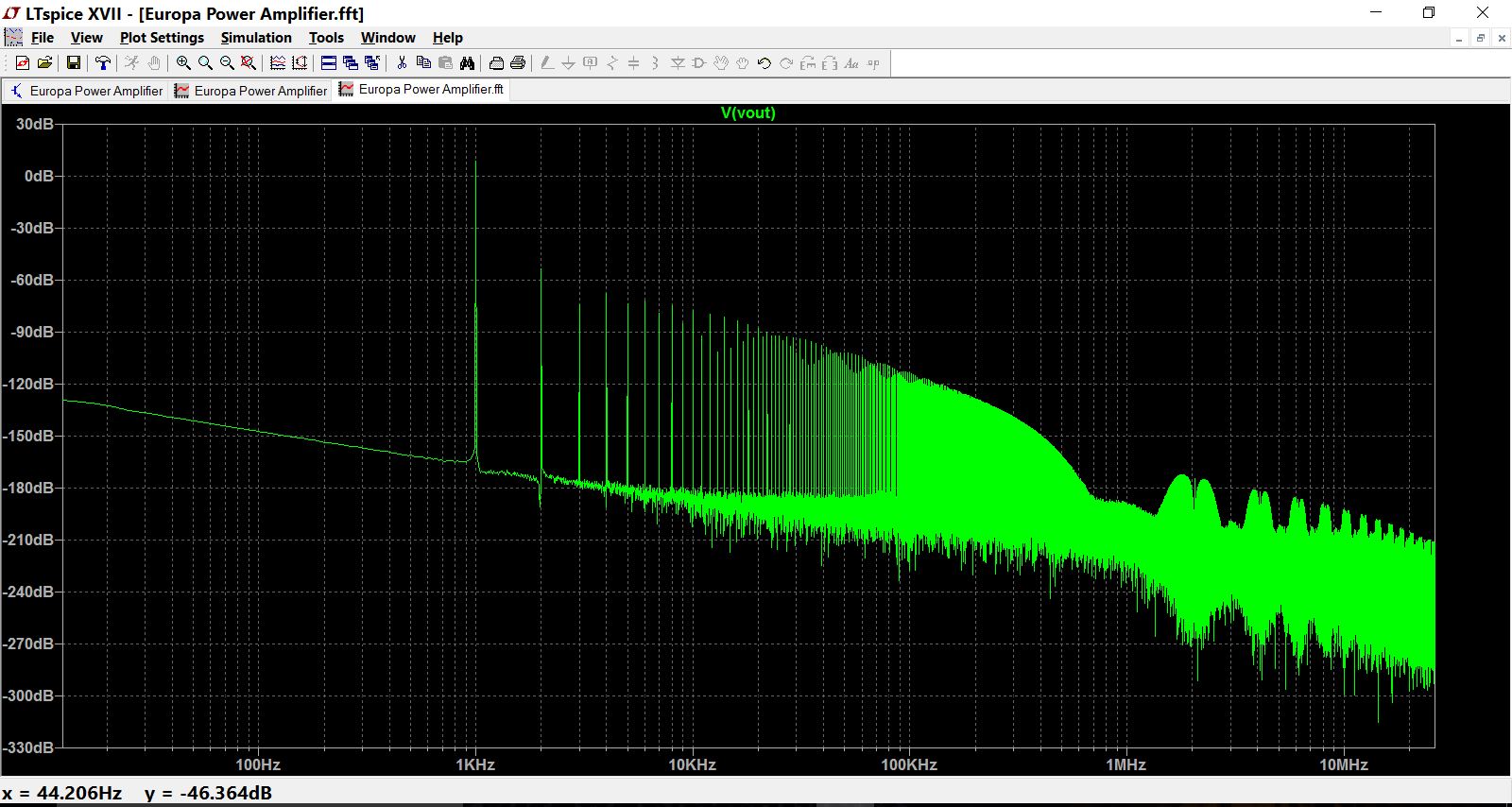

One clip is very fatiguing. Correlating the sound with fft, this must be the europa.

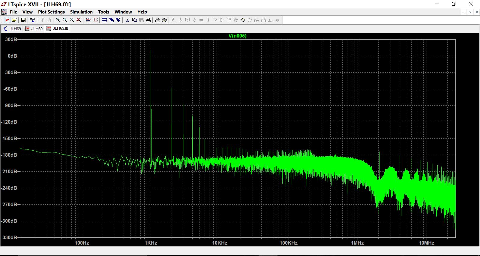

One clip is not fatiguing but lack of definition due to its distortion. But its a low order distortion. Correlating the sound with fft, this must be jlh.

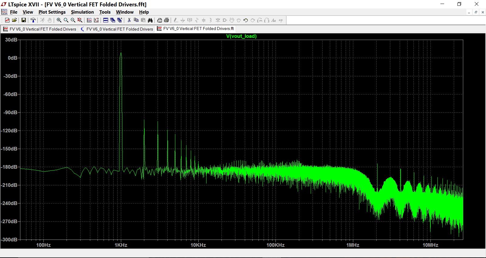

One clip is not fatiguing, has best definition. Correlating the sound with fft, this must be the fet amp.
Two things are confusing tho. First, why the reference has more distortion than the last clip. Second, the fft of the fet amp is too good to be true. Its my favorit but i think the fft shouldnt be that good. Or may be theres uggly fft past 200khz not shown in your screenshot.

Here are more extended FFT's for the three amps stretching out to 10MHz.
Your subjective listening comments are interesting as we often find that listeners prefer certain amps and topologies, or perhaps even valve amps that would measure poorly in other aspects such as damping and so on.

Funny thing is that your FET amp's fft is very similar to the JLH. But I guess it is because of the windowing chosen (which I'm not familiar with).

By removing the HF components (rolling off the response), sibilance and fatigue may be reduced. Second order may mask higher order distortions to some degrees. Then there is the "effect box" thing where we just add something not in the source.

The FET amp has a distortion profile that is alterable (R24 on the diagram). This shows it set up to make it more like the JLH.
