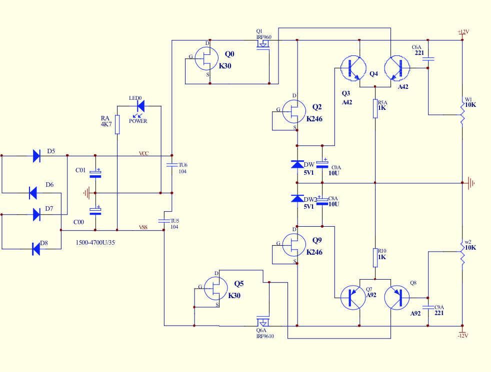

Hi..
Does anyone know was is the "default" voltage over the opAMP on
the finished build version. (meassure from pin4 to pin7).

I found that the "second" trimmer was for setting the (+- voltage) (pin4 - pin7) on
the op Amps.
How much voltage do you have here ???
Do you know what is the function of the other trimmer ??
/Thanks Michael.

Sorry, my DAC9 is no more in use so I can't easily measure that voltage.
I don't know the use of the other trimmer.

Hi MichaelVV,
I just received a dad 9 V1.2 from minishow. I am still investigating the "as is" board. I measured at opamp:
pin 4: -14.0 V
pin 5: + 15.6 V
In schematic is +/- 12 V specified. Unsure if this is good or bad?
I assume the trimmers are there to control the voltage, I do not see the trimmers in the schematic. Needs some investigation.

Hi...
I have tried anything beetween +- 12 to +- 15 volt.
I have some contact with the danish DEXA guy , "he's developing discrete opAmps". I have a pair of DEXA for test.
But right now , I'm playing without opAmps.
I might have less gain, but I really like the Clarity without op Amps.
