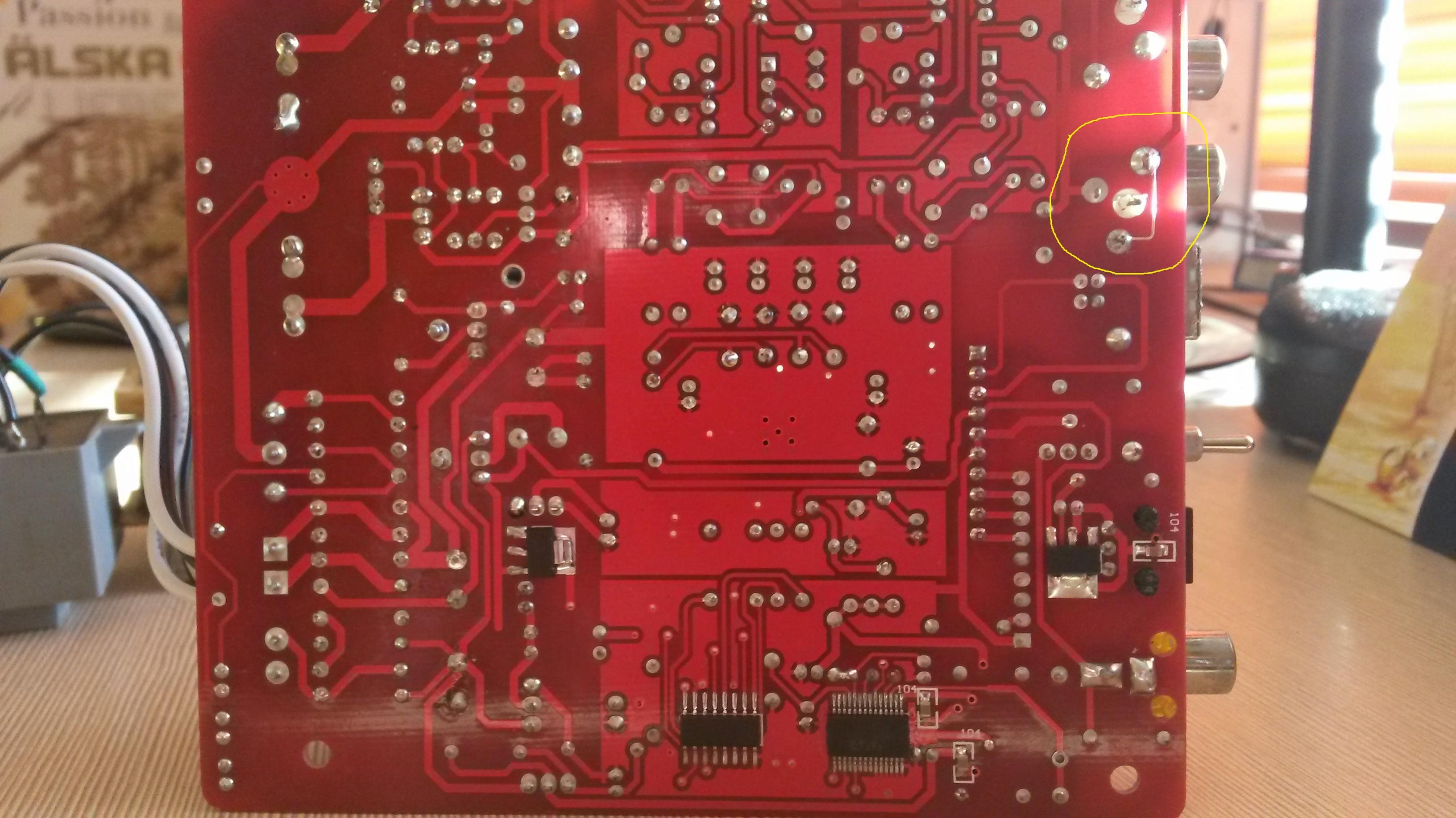

50Hz hum
Hello,
my DAC9 has some ground hum, not loud but noticeable. I've used a 30VA R-core trafo and the 0 volts of 15-0-15 goes directly to star ground, I've also tried other grounding schemes but without improvement. It's completely stock kit otherwise, but I've removed the RCA-connectors and use shielded wires instead, going directly to source switch and no ground connection in switch end. I've also replaced the SPST switch with outboard switch.
Any suggestions?

Do you use USB.
I have heard about the same issue.
Try to create shortcut between RCA and USB as shown by yellow.
It looks strange but one guy found it and that works.

Is that connecting the rca GND to the usb GND?
yep. It works for me too.
