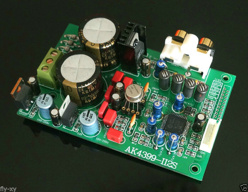

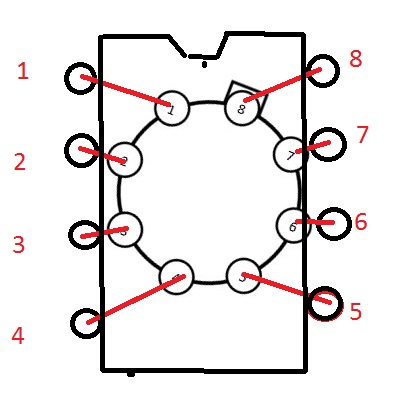

small pin on metal can is NC ?
It's pin 8
Pin order is the same of the DIP version, referring to the datasheet simply push each corresponding pin on the DIP socket.
See the (horrible) attachment

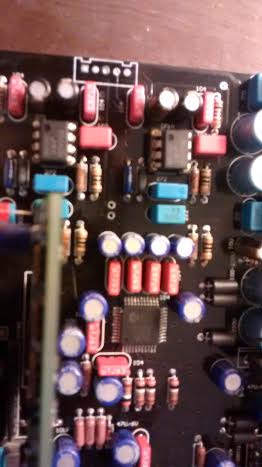

well, I m not too convinced with new opamps, change is minor , exist though.
What else would you recommend to try ?
You'll need to get the adapter pcb's and some round pins, shipped from CHINA.
Theres two versions a single channel adapter or dual.
Choice is too big , that is for sure. Buying opamps can cost a lot, especially not being satisfied with any 🙂
Would be ideal to find somebody to borrow some for a week or so 🙂
