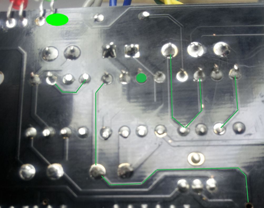

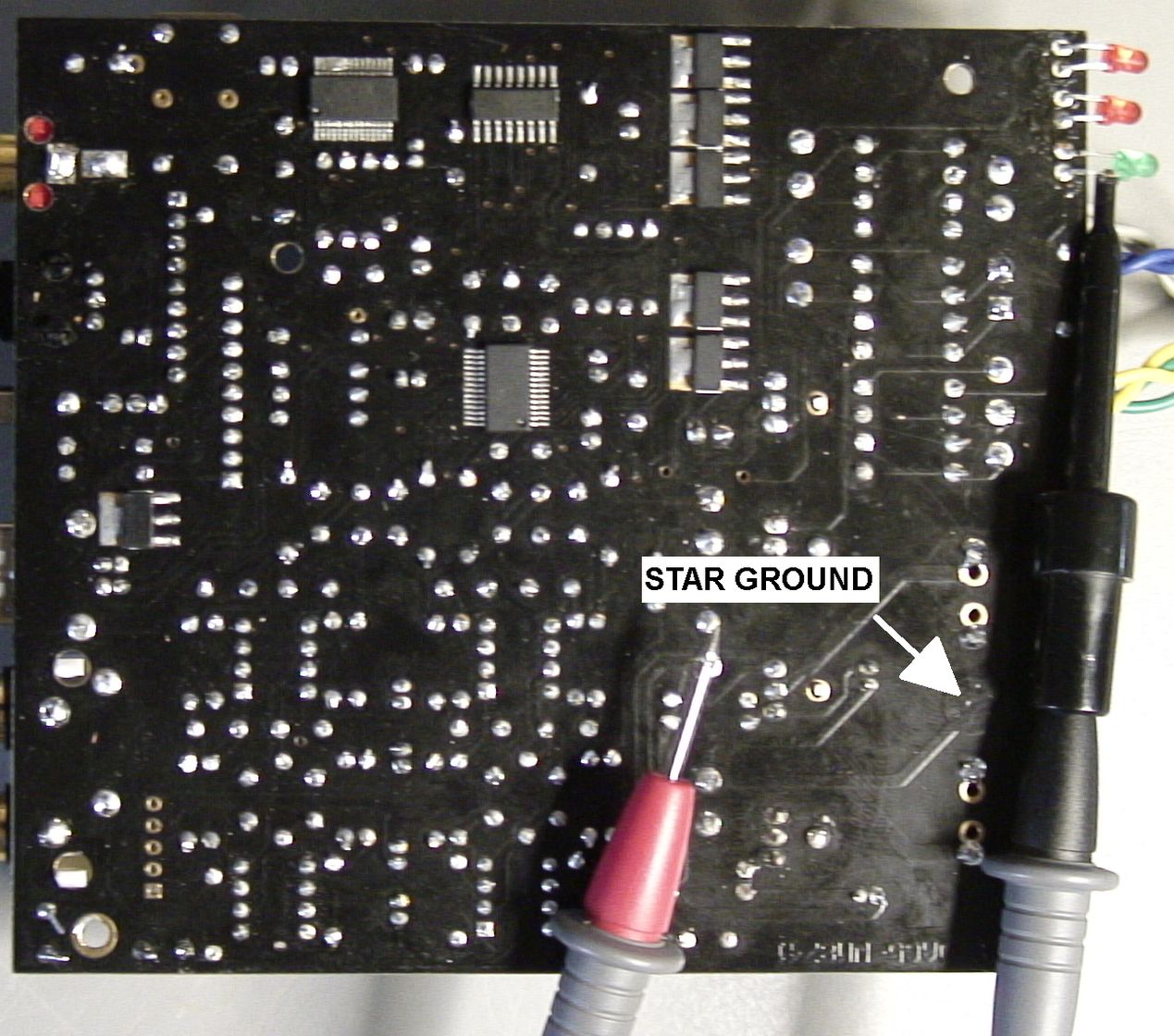

I did read all the data sheets this morning for pin function but I will double check my work. The neg probe is attached to the LED which reads/leads continuity to the star ground.

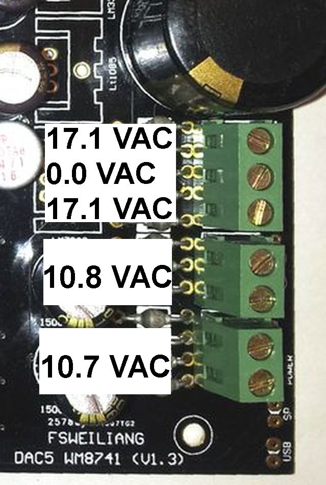

The transformer works correctly (minus one 9 V pair) with the Mini 2496 DAC.

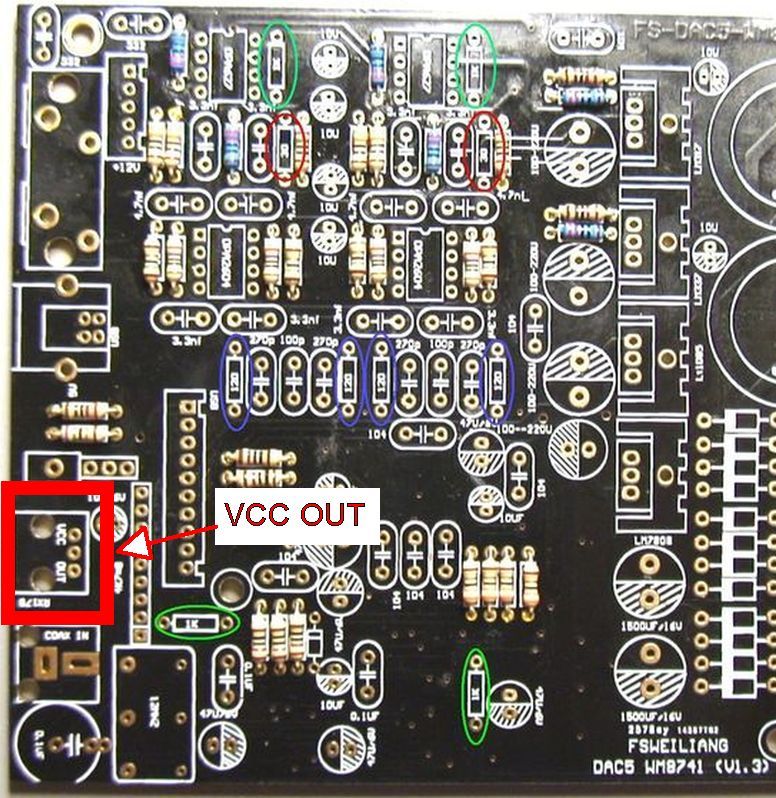

Also, are there simple opamps (without the adaptor/riser) I can use in those positions for testing?

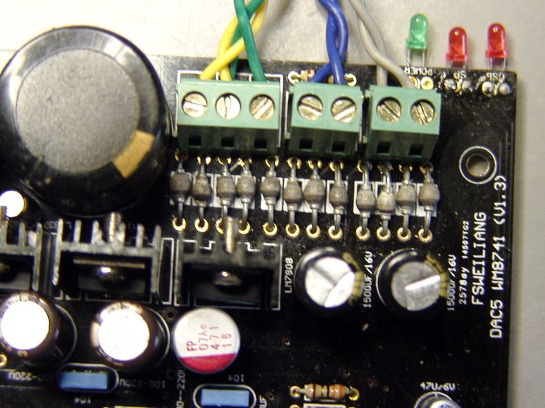

I don't own the board, and can not tell from pictures if diodes are correctly oriented versus onboard drawings.
Can you double check that all grounds are linked together on the board ? there is something wrong will all the upper side regulators, or with transformer/rectifier... or with measurements 😉
For testing purpose, you can use the low-cost 5534

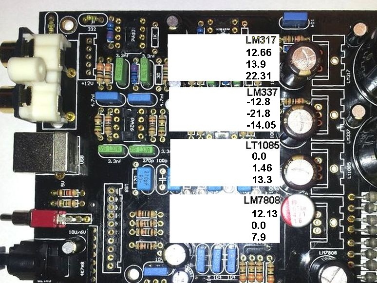

NONE of the measurements on the top side of the board look right to me. Before you replace the LT1085 or any other ICs, you need to figure out why the measurements are so strange. They're just too weird, as Al said. If these measurements are correct, then you've also probably blown some electrolytic caps from either excessive voltage or reverse voltage.
I'd suggest you try to isolate each separate circuit by lifting pins, or cutting traces, or some such thing, and try to get readings that make sense.
The input to the LM317 should be something greater than +12v (perhaps +16 or +18 or so). The input to the LM337 should be similar voltages, except negative instead of positive.
The input to the LT1085 should be something greater than +5v (perhaps +8 or so).
The input to the LM7808 should similarly be greater than +8v (perhaps +12 or so).
You are not ready to start substituting ICs yet. But when you are ready, a pair of NE5532 and a pair of NE5534 op amps can be substituted at the analog side of the DAC for test purposes.

Much better readings, but not there yet.
The LT1085 was the only original reg I left on the board. I found one from a previous project and noticed it had white writing and suspected what I had was a fake. The new readings are closer to post #59 by alkasar.

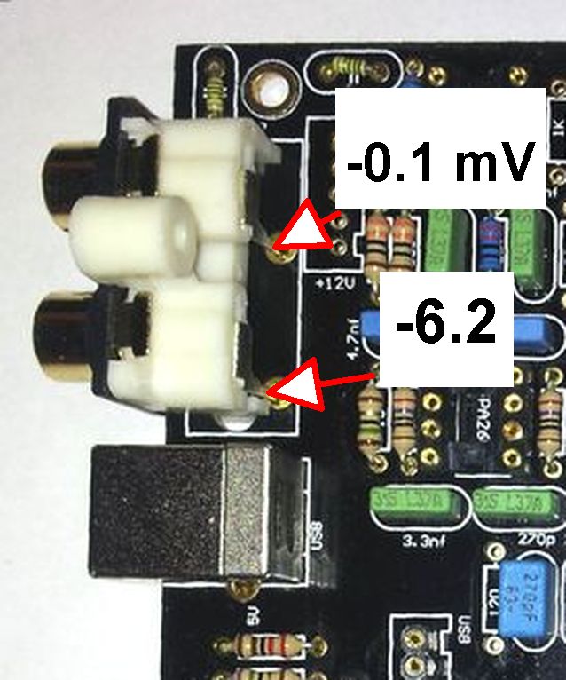

Weiliang did reply to Min Yao and he also saw the voltages as wrong. He thought the transformer could be the problem but I think the margin is just the normal over-current. DC on RCA out is small but reads negative with positive probe to signal.

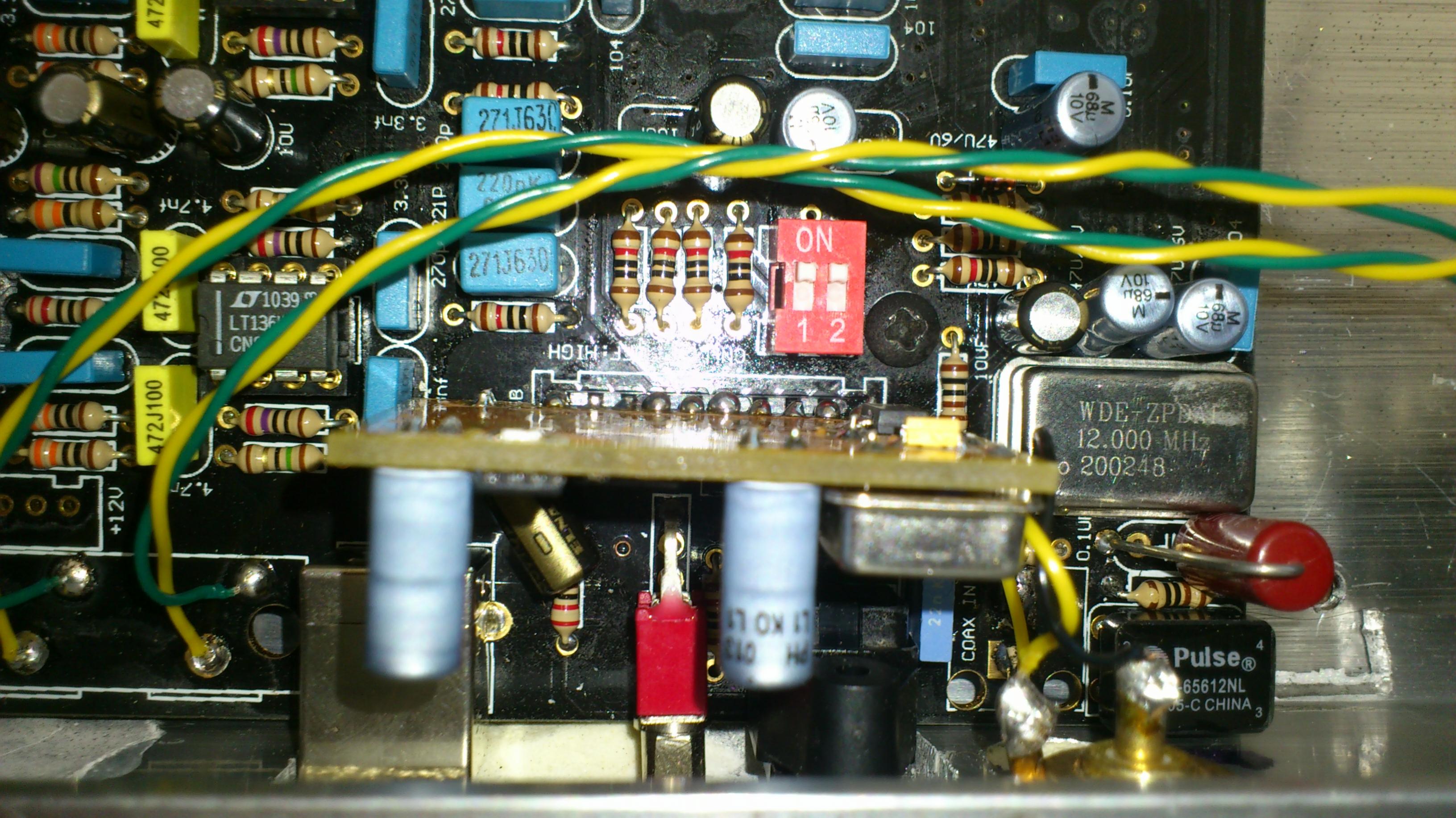

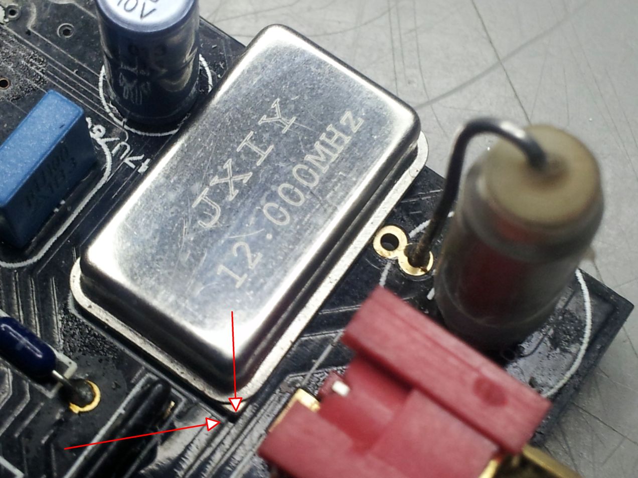

Is it a crystal or an oscillator? The package used is common to oscillators I've seen/used and if it is in fact an oscillator the orientation is important as there will be a power, gnd and output pin and usually one open pin - obviously there can be only one correct orientation in such a case.
Here is a photo that shows the square corner of the TCXO and its correct orientation to the lower left in this view.

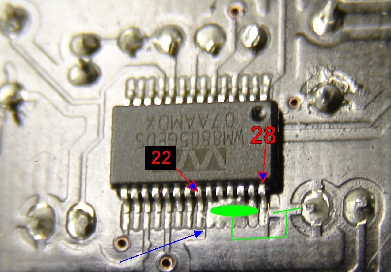

I have a different brand oscillator but the square corners do match up. This one has four leads and no markings. The second photo shows bottom side connections. Also - there are five pins soldered on the WM8805. Does that correspond to the other builds?

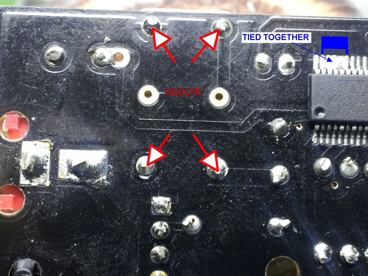

Does the small diode appear to be in the correct orientation? It was difficult to determine and I selected the black end as the mark.
On the circuit diagram pins 22 - 28 of the WM8805 are tied to ground, so that looks ok (however you are only indicating pins 23 - 27). Diode and oscillator look correct.
