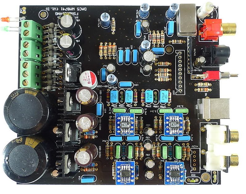

I have a newer version of this board V1.7. I'm not sure of the differences but there are 2 small dip switches on this version.
I also fitted OPA827 and LT1364 Opamps.
It's the same board as I have. The DIP switches are hidden in my photo by the Tenor USB board. Have you done any listening or testing yet?
Can you recheck the components values on board ?
Yes, and there are some discrepancies. I copied and modified your output schematic to match what I found:
http://www.circuitlab.com/circuit/9q6985/dac5-wm8751-output-as-built/
I ran the RMAA tests and found striking differences between having the DIP switches ON or OFF. Things look better with them ON for me. In both cases, I'm using the Tenor USB interface.

I was curious about the DIP switches, so I did a little more investigation. SW1 is connected to pin 22 of the WM8741. When the switch is open, pin 22 is high; when closed, pin 22 is low. This controls the oversampling rate. It also seems to affect which digital filter is selected in the WM8741. At the low oversampling rate (switch closed), a "Linear phase half-band filter for backward compatibility" filter is used. At the high oversampling rate (switch open), a "Linear phase 'soft-knee' filter" is used. For more details, see the WM8741 data sheet.
This seems to explain the differences measured through RMAA with the switches in the two different positions.
Dave
SW2 does not seem to be connected to anything, so I guess it is there for mechanical support.

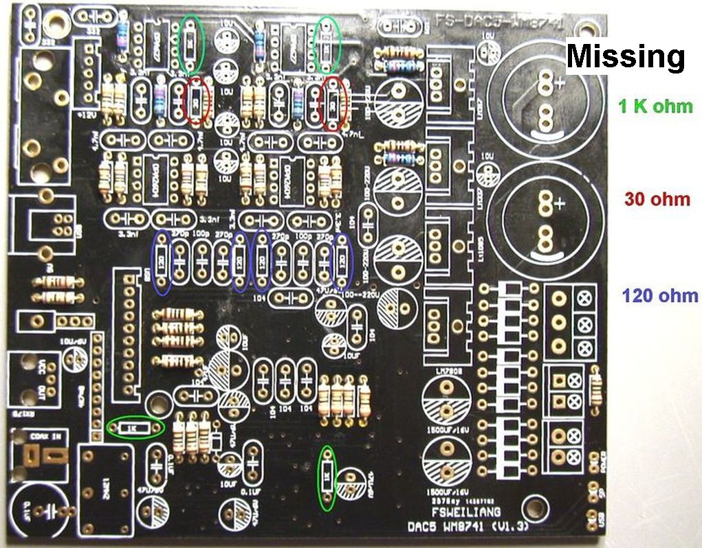

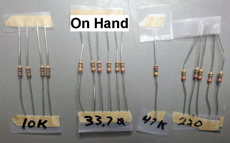

Hello Folks, I have a problem with a version of this design on the most basic level. I bought this kit from a vendor named good.feedback on eBay. After waiting almost eight weeks the package arrived with most of the resistors missing. They did arrive within a week or so but some still don't match up. It appears today the vendor has basically disappeared before I could get things in order and receive the docs and schematic I requested.
So I'm hoping someone (from the photos) can tell me the correct values (ohm & wattage ) for the missing resistors based on their position and/or adjacent parts. From what I can find there are at least three versions of this DAC and I'm hoping there is enough knowledge around to prevent this project becoming a lost cause.
Thanks in advance.....
Great, that's a start. I had asked for the schematic twice and was going to do so again today when I discovered they have most likely folded up shop. I'm going to try the other vendors tomorrow.
All the resistors on my board look as if they're 1% metal film 1/8 watt.
Are all the capacitors, semiconductors, etc. missing also, as your photo seems to show?

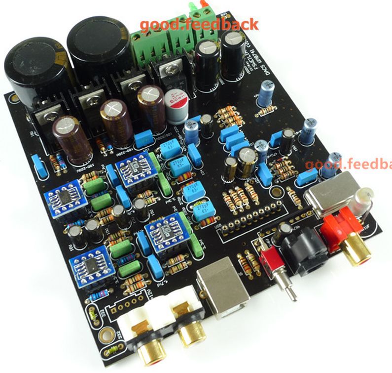

I bought a finished board from good.feedback about a year ago. It was a good experience. At the time, he disappeared a few days, as his wife got a baby the day I placed my order. Maybe another baby coming 🙂
I finally bought DAC6, the USB input only version with TE7022 + WM8741, on ebay from minishow0328. It's a finished board, not available as a kit.
He is not the cheapest vendor, but english communication was excellent with Yao. Shipment with tracking number.
It arrived today. Excellent packing, very safe, and only 12 days to from Singapore to France, delivery against signature 🙂
He does not have the DAC6 v1.0 schematic and said Weiliang does not want to share it 😡 I'll have to reverse engineer the schematic from board.
This board has only one dual opamp at the output, OPA2134 despite ebay description says AD827, probably for unbalancing.
A first glance at the boad shows excellent built quality. The board is yellow now. Caps are Elna Silmic, smaller ones are Elna SilmicII. Sanyo Oscon, Wima mks and MKP in the output area.
Main filtering caps are Samwha 4700uF/35V . Never heard before about these caps. I had terrible experience with some chinese caps. These are Korean. Anyone knows how good they are ?
