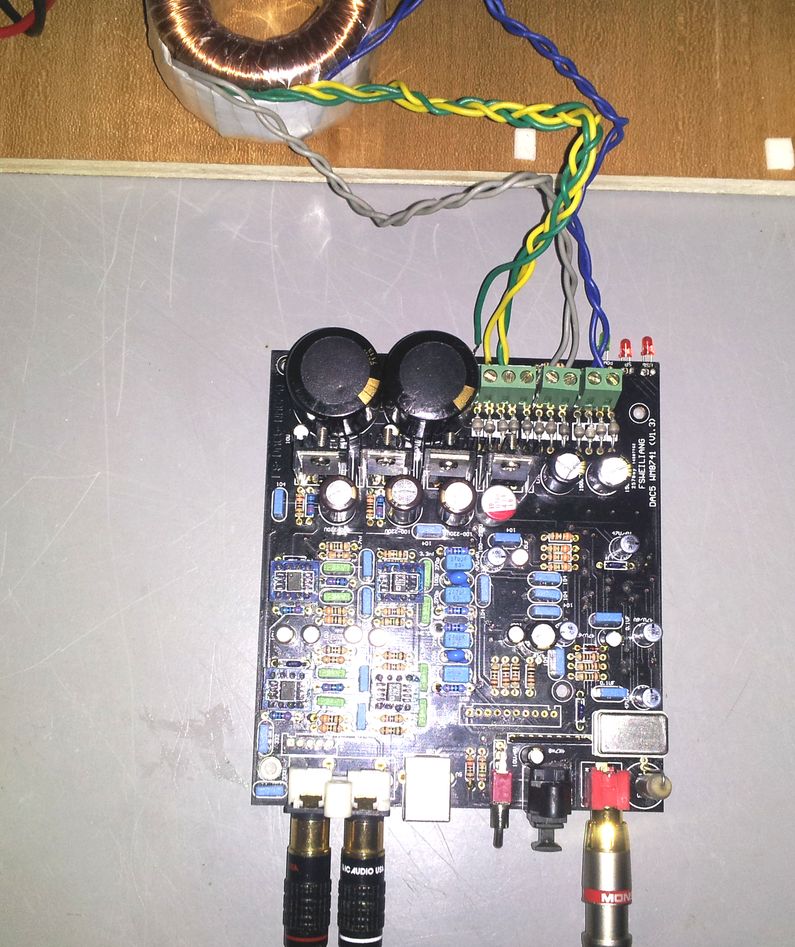

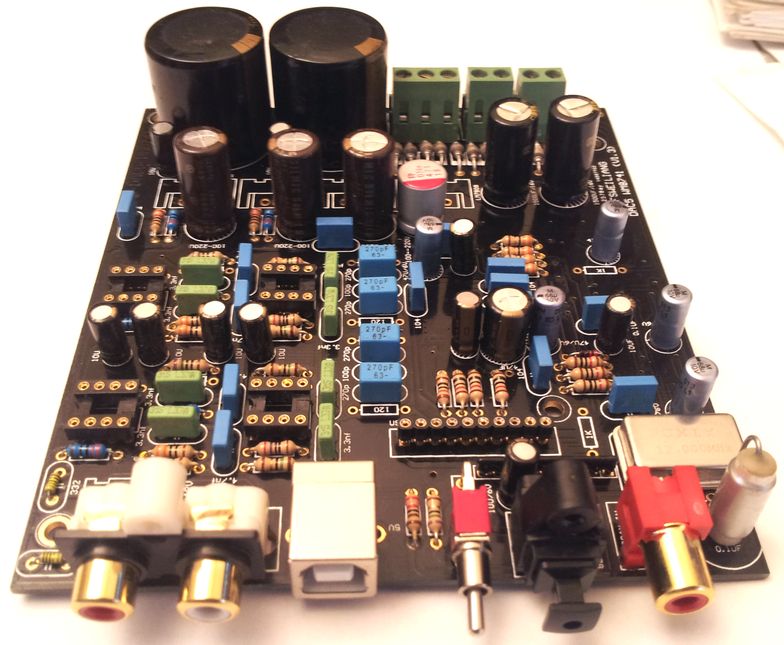

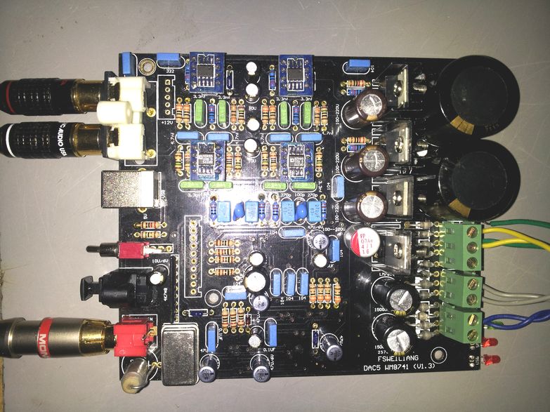

Got lights but no sound.

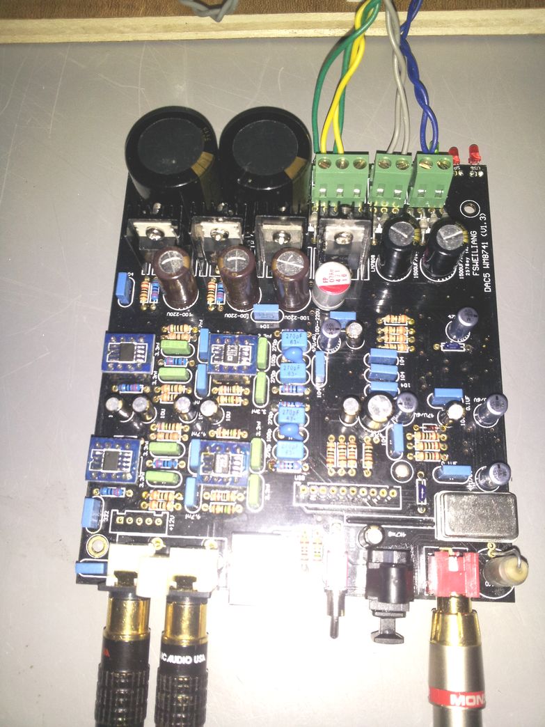

Unfortunately, I started out with a problem. As always I did first power up using a dim bulb tester which indicated a short somewhere. I found a solder bridge on one capacitor (A). With that fixed, there was no fault detected by the bulb but still no light on the power LED. Reversed the polarity of that and the other two LEDs and got power indication.
The USB LED lights when that cable is connected, and the "SP" LED lights up when S/PDIF RCA from computer is attached.
DC offset reads 0.00 mV for right ch and 6.3 mV on left. There are no hot spots detected by an IR thermometer or by placing my hand over the board.
On USB - no sound or hum can be heard. Driven by the RCA, a very faint, scratchy non-musical ghost impression of what's being played can be detected through the speakers.

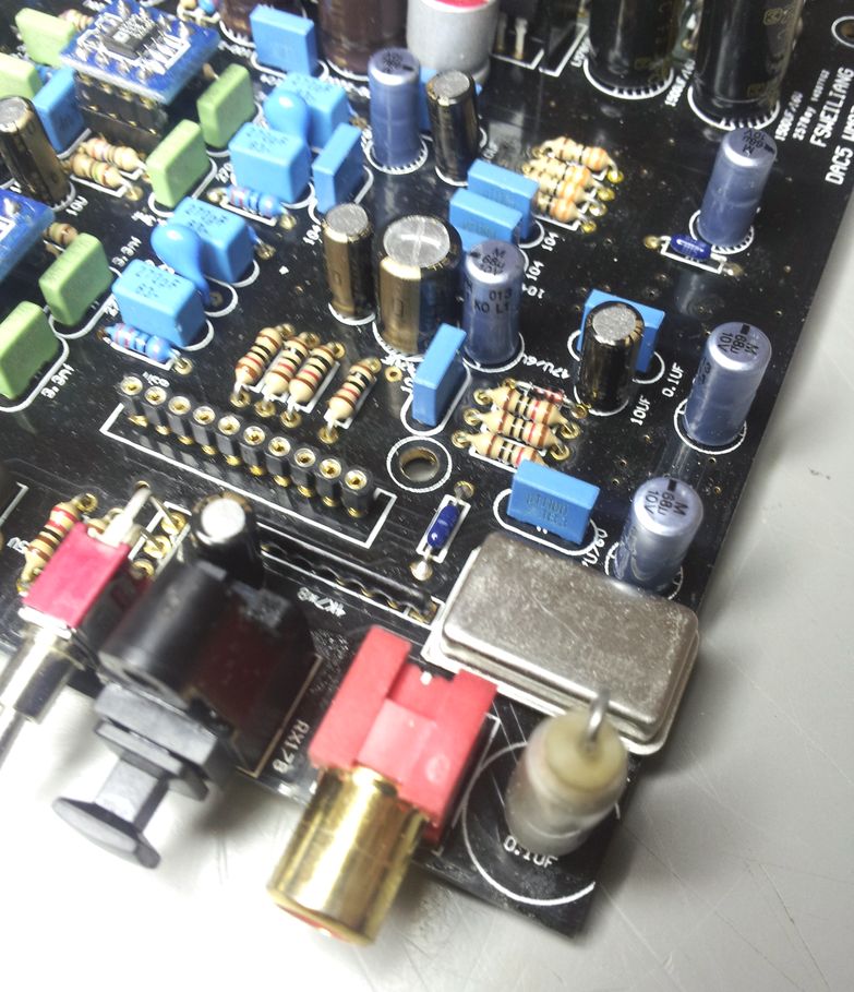

Opamps at "C" call for OPA624 and are correct. Those at "B" call for OPA2604 as marked on the PCB, but one OP275-G-811-G4428 and one OP275-G-903-G6404 came with the kit.
I didn't get any documentation, and my assumption that the red toggle was a power switch was proven incorrect. In the down position the SP LED is active and off when lever is up. It must be a mode switch for the tenor module???
As always, I'm open to all help and suggestions.

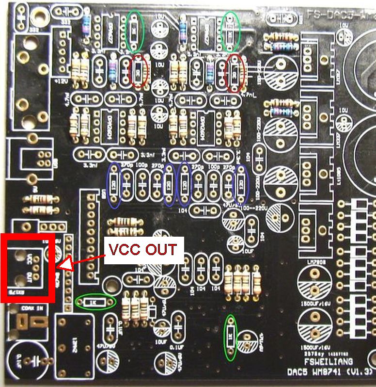

Hi Pete,

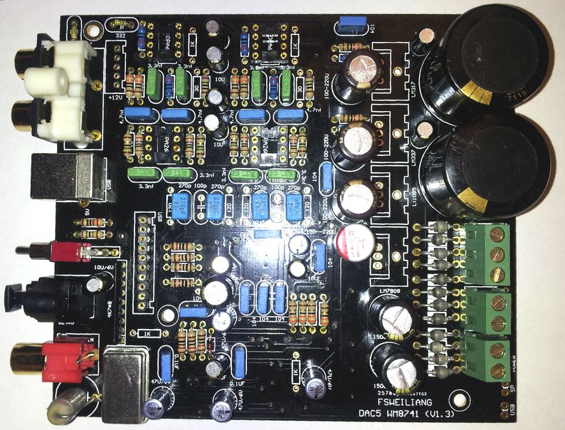

Unless I have a different board or mine is mislabeled, there is a different function here. I didn't try optical as I remembered what was under that socked. Could that be a tow-way connection? I would assume not as s/pdif requires two cables for in/out operation.

Thanks Pete, I have V1.3 and can see many differences compared to yours. The output/opamp sections look the same but the input, crystal and cap arrangements are not the same circuits.

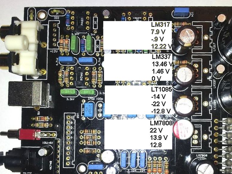

so the regulators are soldered on the bottom side. Interesting.
There is something weird: the output of LM317 should be around +12Vdc to ground. (7.9V is not correct). LM337 around -12V (it outputs positive voltage !).
7808 arounf 8Vdc . Not sure what 1085 is used for, but negative voltage on all pins is wrong.
Check the regulators datasheets to findout pin order and meaning to identify input and output. lm337 negative regulator pin order is different from lm317 positive regulator. I don't think you can mess the orientation on the board.
do you measure voltages to ground ? is the transformer wired correctly ? are the rectifying diodes all in the right orientation ?

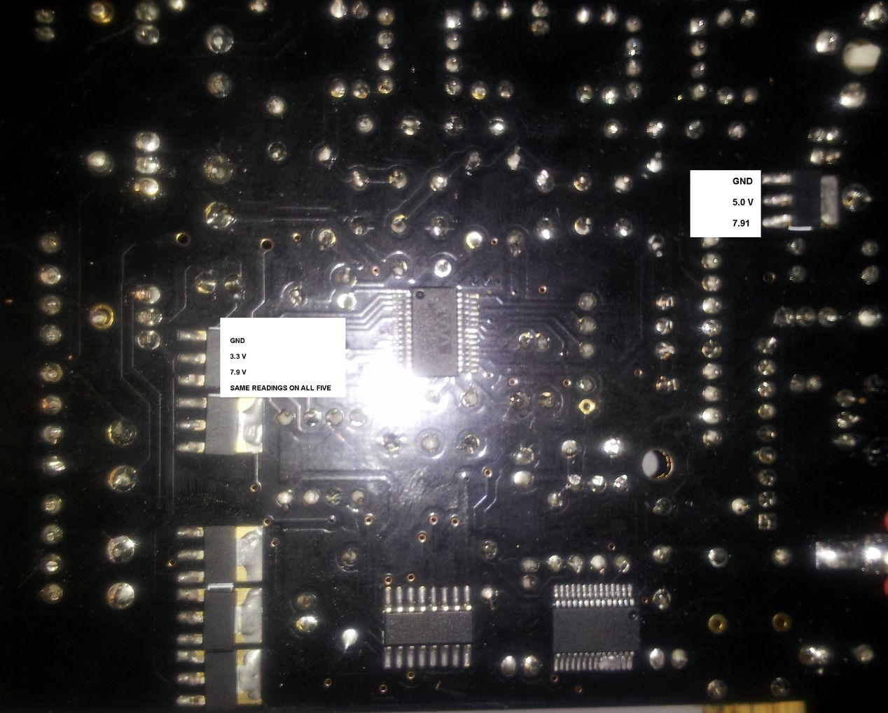

I just rechecked the schematic : the 6 small regulators at the bottom are 5x 3V3 and 1x 5V regulators. They should have 8V as input (coming from 7808).
