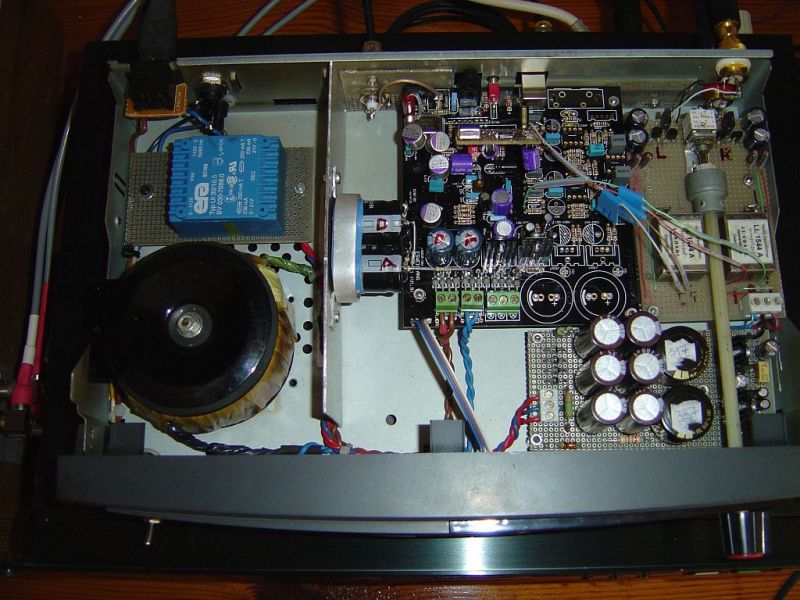

a few months ago from ebay seller I bought your DAC5-V1.9.
DAC output section is changed; I put Lundahl OPT + volume pot + JFET buffer. With my (very tweaked) transport from Marantz CDP-Pro, sound is impressive and I'm very pleased.
I want to do for next few modifications and testing but can not get a schematic of this DAC.
Is it possible to get DAC5-V1.9 schematic from you?

I wonder why RajkoM use a transfo AND a buffer, don't the use of one of the two would manage the impedance problem?
On volume potentiometer taper output impedance is 2,5-3 Kohm. It must be buffered.
