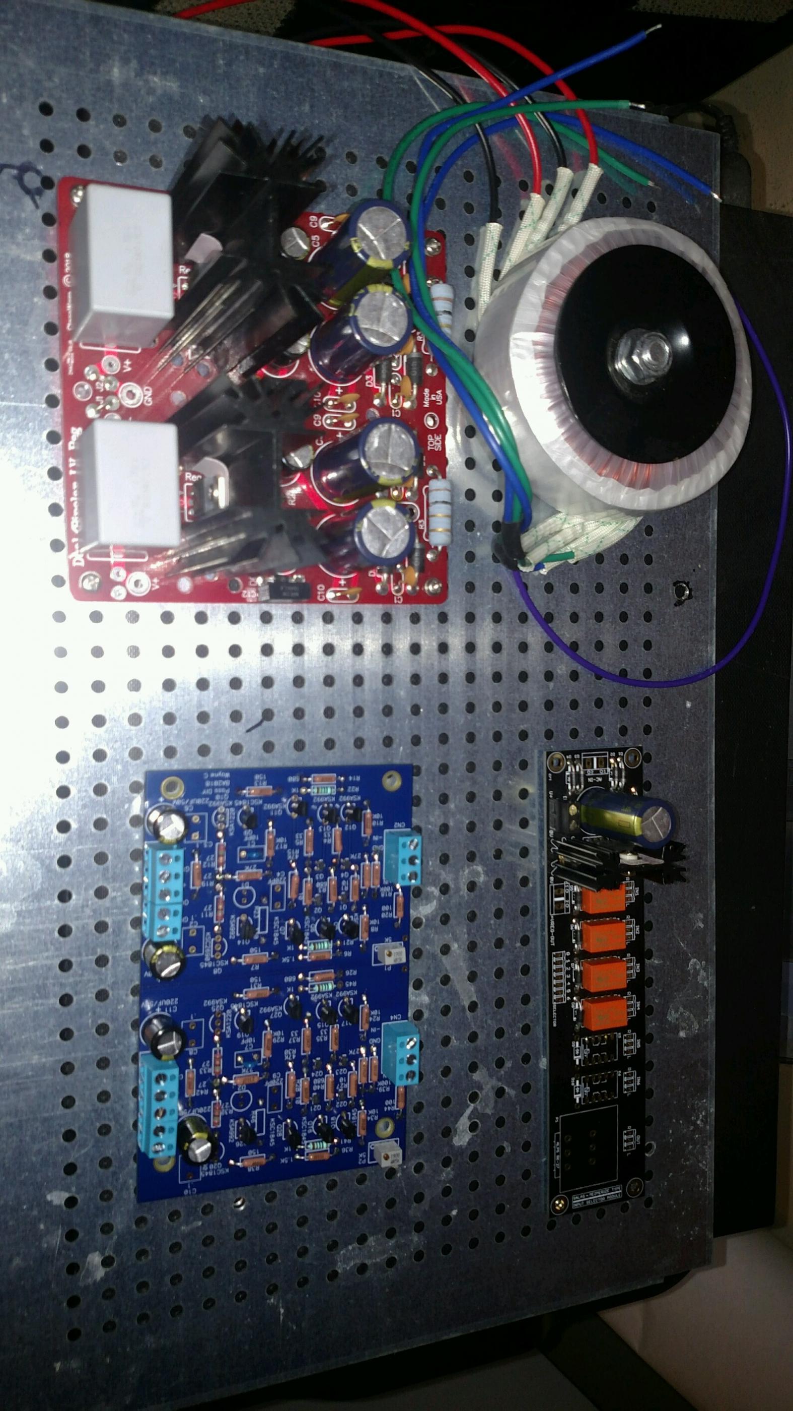

I still have to do all my signal wiring, but I did my layout so I could possibly add some partitions if needed:
This is a 2U Slimline chassis. Since I had extra headroom inside I added the optional bottom plate (installed upside down). The wires from the IEC to the front switch go underneath. After the switch it goes to a terminal block with a noise suppression cap. Then the power splits to the two 15VA transformers, each with its own fuse. I am hoping that putting the transformers into the corners helps with any noise.
If there is a noise issue I can see 2 options. Buy some angle iron and install between the PSUs and the preamp. I also have a large piece of mu-metal (I think) that came with my F5 transformer. Assuming I don't need it in the F5 I may cut it and wrap it around the smaller transformers. I won't be bending it, just making a smaller circle, so hopefully that doesn't ruin the mu-metal.
Fun stuff! Haven't tested anything with speakers yet though, just multimeters, so it will definitely be interesting using the BA2018 and F5 for the first time!

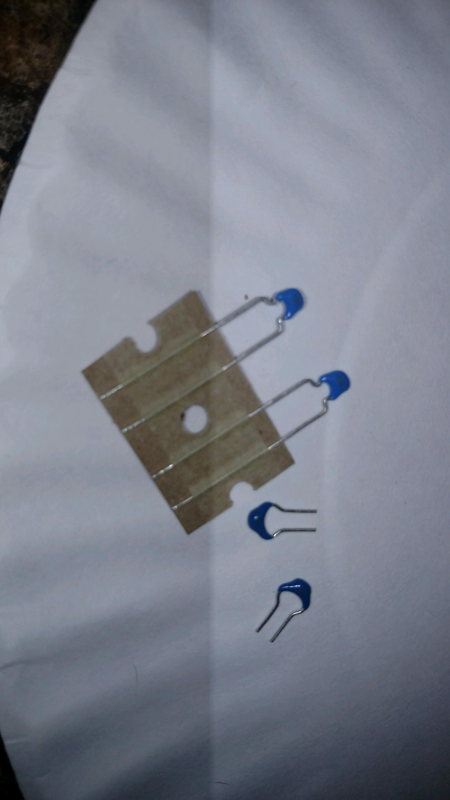

Can someone tell me which one is 5pF
The ones NOT on the tape.
I can not take any credit for that, another member from the forum generously did that for me.
My eyes are not as good as they used to be.

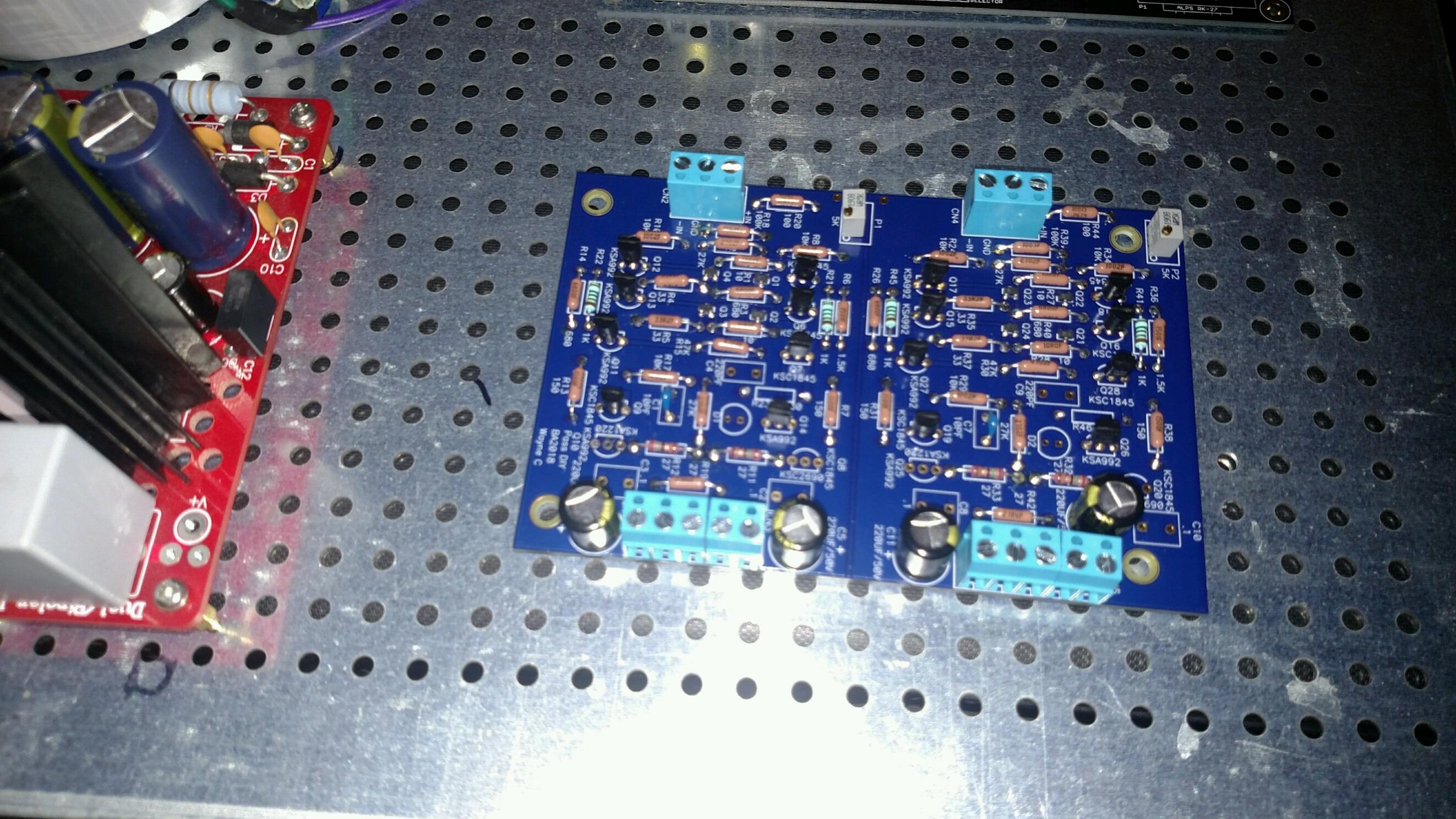

Had the PSU, the Salas, and the main board with the 209s soldered, on my kitchen counter top.
My dog actually grabbed and destroyed the main board, noticed in the pics you can actually see his slobber marks that I didnt clean up.
Glad he stopped at one board.
