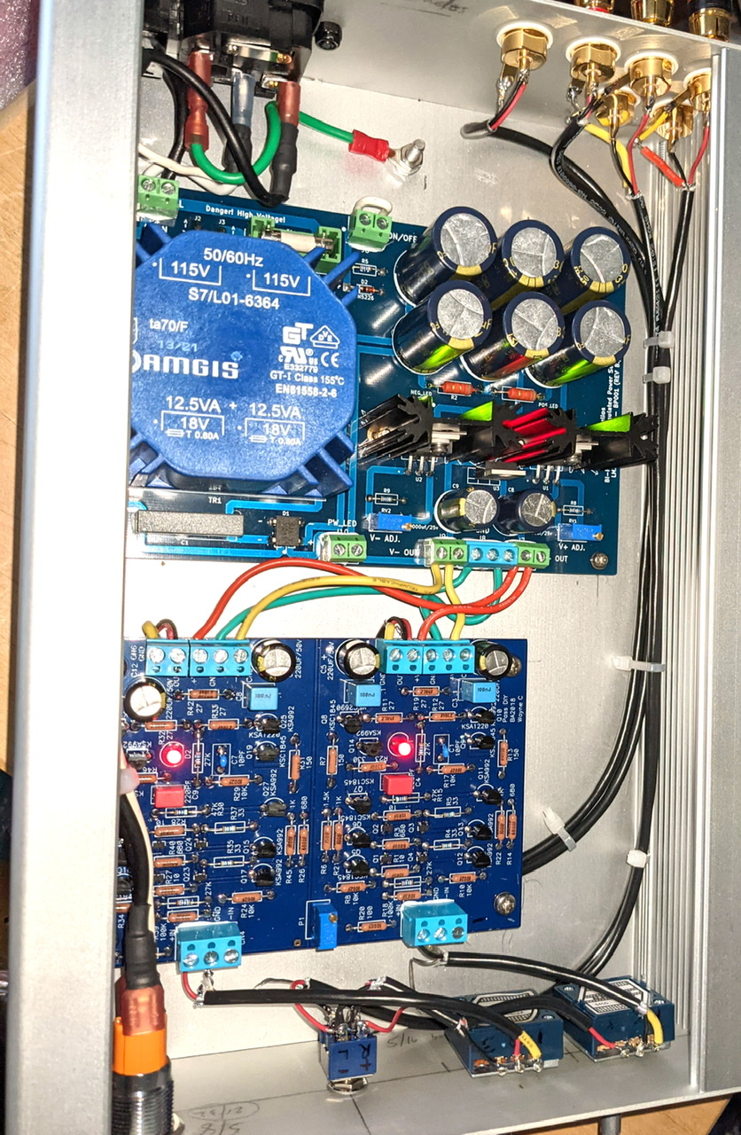

@iotovip - Something may be amiss with your build. If built per the schematic in post #1, you should have ~3.7x gain.
The picture you posted is not large enough to see your boards clearly. Perhaps post a few more pictures. Try to get at least one tight shot of the main board and one clearly showing the input and output wiring including the volume pot and input switch. The eagle-eyed forum members may be able to spot something.

I have a general question for the group I built this ba-2018 and it sounds great and very clear, but the volume will not go very loud, it fills the room but not near as loud as when I hook up the Dac direct to the amp, pass labs F6
is there a resistor I can change or something to fix

Hi, Lovotip!
Great build overall.
See post 1233 from MJ, marvelously explained. In continuation of that, please confirm that R16 and R17 and their equivalents on the other channel have the correct values, according to schem. Once that is confirmed, troubleshooting will be easier

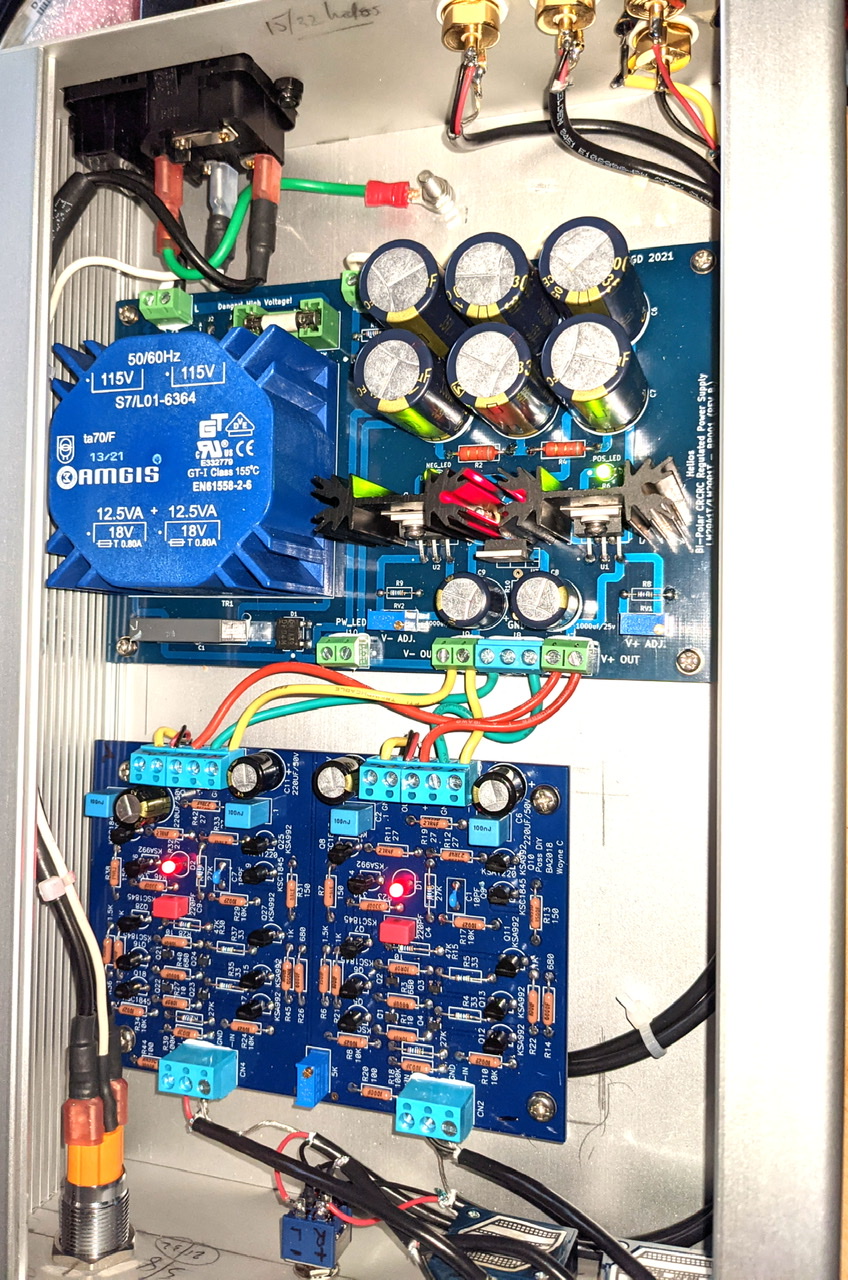

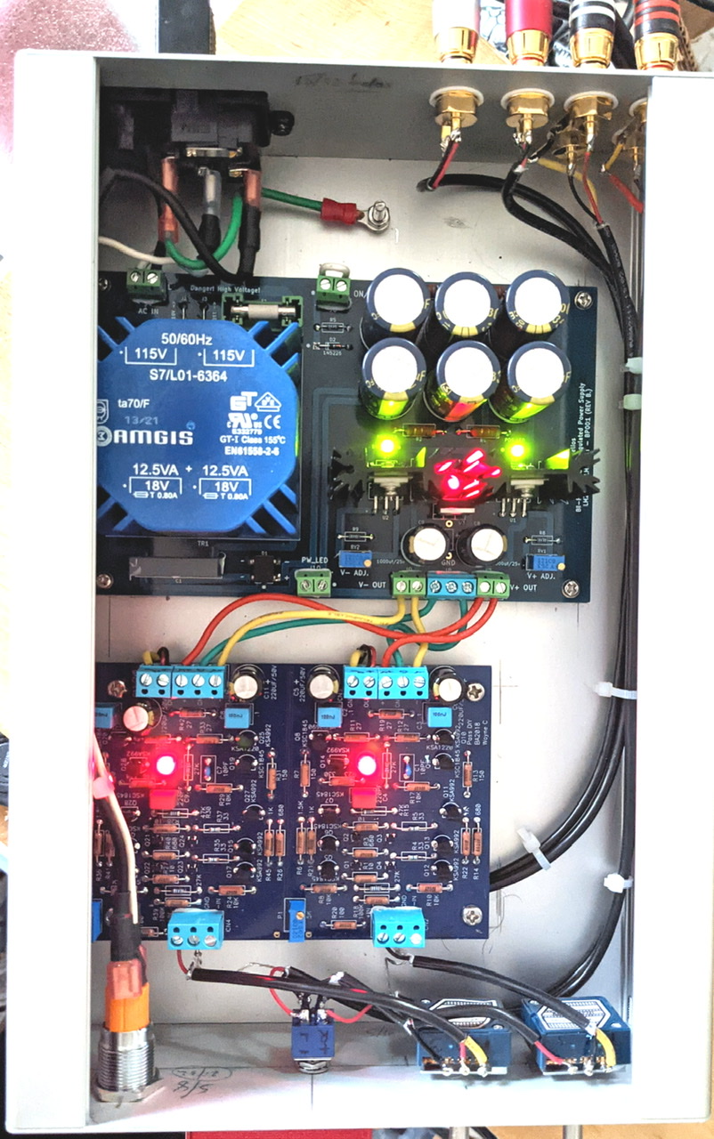

Up and burning in
No issues. Dead quiet with no signal input & pots turned up to full. Sounds fine. Will let it burn in for awhile before making performance comments and finishing the case off. Anxious to see if Nelson’s H2V2 has a positive added effect.
Helios PS, Hammond case, ALPS mono pots for L-to-R balance control.
