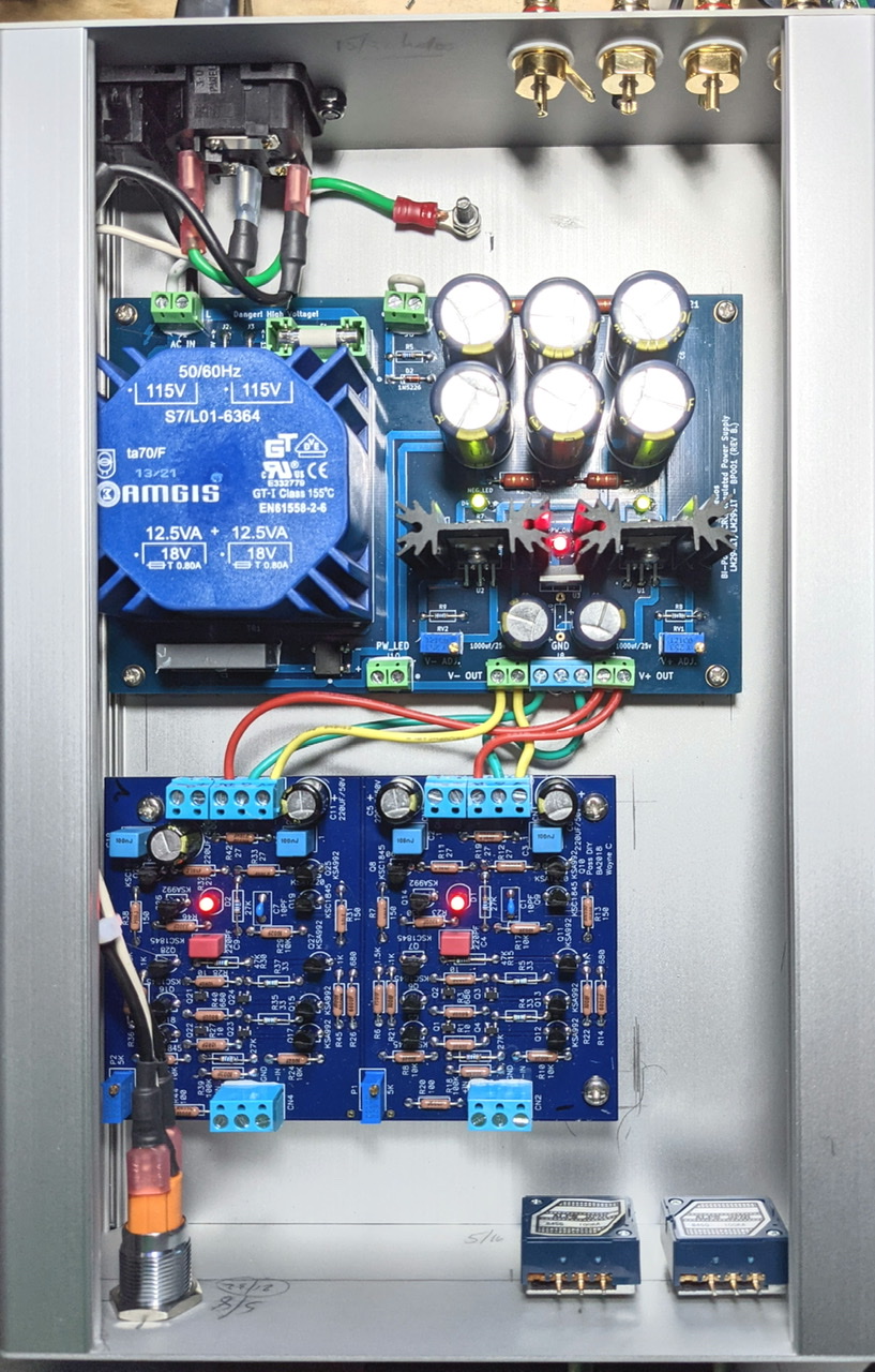

Need a few more good photos of the inside of the preamp, can't make out how much of anything is grounded, and only kinda-sorta the input connections.
Also you seem to have only 2 connections from the PSU to the BA2018 PCB, a bipolar supply needs positive/ground/negative...
Anyway, more photos will help a ton, we'll figure it out.

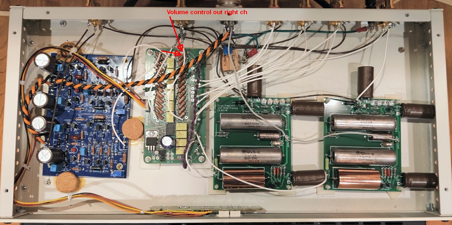

@cubicincher: Good eye! I feel very silly admitting this, but I wired up two "left" outputs from the TentLabs Volume control to the inputs of the BA18. Oops. I knew I wouldn't get this project done without making at least one stupid mistake. That solved it. Thanks, Dirk!
@elwood625: The RCA jacks next to the power jack are "tape out/pass-thru" jacks, labeled as such because they are taken before the volume control but after the source switching circuitry (from a "Vol In" on the TentLabs attenuator). Thus, they function the same way a tape out would, but I have no intention to use them with a tape recorder -- they'll go to the auxiliary input of my old Lafayette tube receiver. Just a way to let me have fun and select the source with the preamp unit, but not touch the attenuator before reaching the destination. The resistors are just 110R Takmans I had lying around to prevent weird noises and such. If you think this could cause problems, please let me know!
@6L6: The orange wire is Power+ and the black wire is Power-. The ground is shared between both channels and goes to the star ground point via a brown wire. The outputs of the preamp board are brown wires only because I ran out of white wire 😀 Hey, it works!

+/- 18VDC holding steady and tuned to 0mV DC on signal output. Waiting for my shielded input/output signal cable.
The build looks great! Good work! 🙂
Nice. What power supply board is that?
It's the Helios! World acclaimed you know! 😀

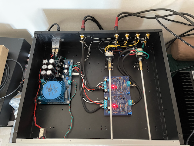

sounds great but low volume
hi
I have a general question for the group I built this ba-2018 and it sounds great and very clear, but the volume will not go very loud, it fills the room but not near as loud as when I hook up the Dac direct to the amp, pass labs F6
is there a resistor I can change or something to fix
