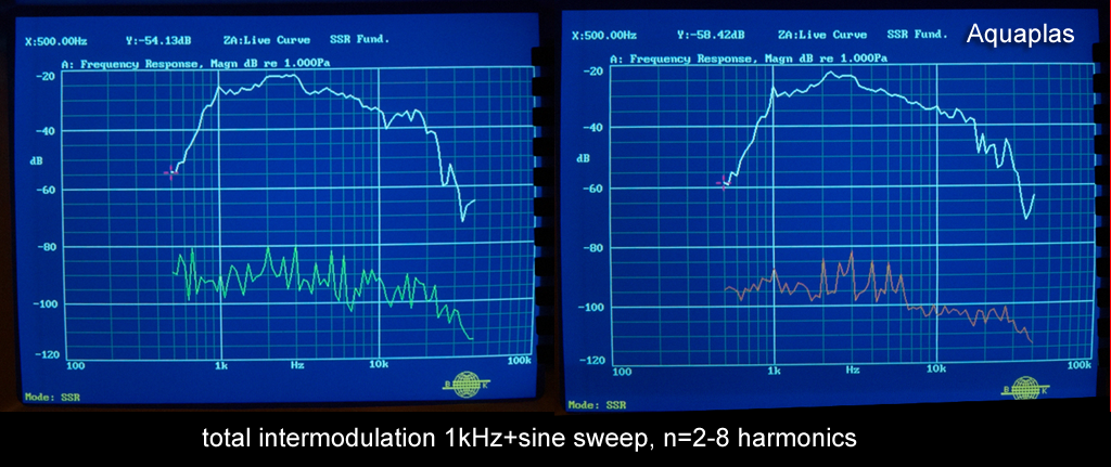

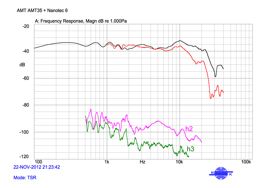

Looks like a nice improvement with the Aquaplas, needing less correction and better time domain performance (wonder if distortion figures improves as well). Have you done any listening comparison?
Also, how much Aquaplas did you add?

Will send sample diaphragms to Autotech for evaluation. Hard to say how much Aquaplas - just to cover diaphragm completely with white coating. About 7-10 layers.
The sensitivity takes a big hit from the extra mass of the Aquaplas.
Standard application recommendation for optimum damping of diaphragm resonances is to cover the center 25%, as that is where amplitude is greatest.
If you wanted to get fancy you could effect constrained layer damping by adhering a small disk, or maybe two crossed strips for less mass, of aluminum foil to the center of the diaphragm.

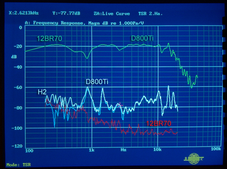

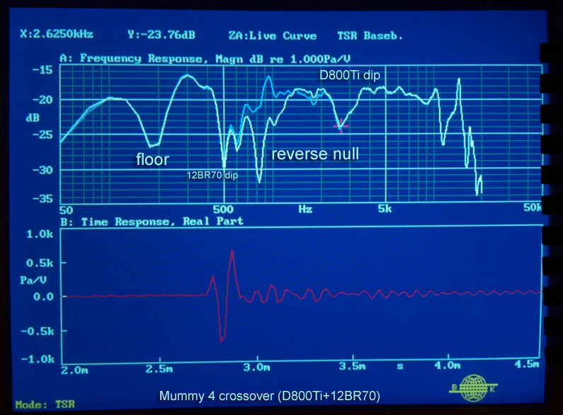

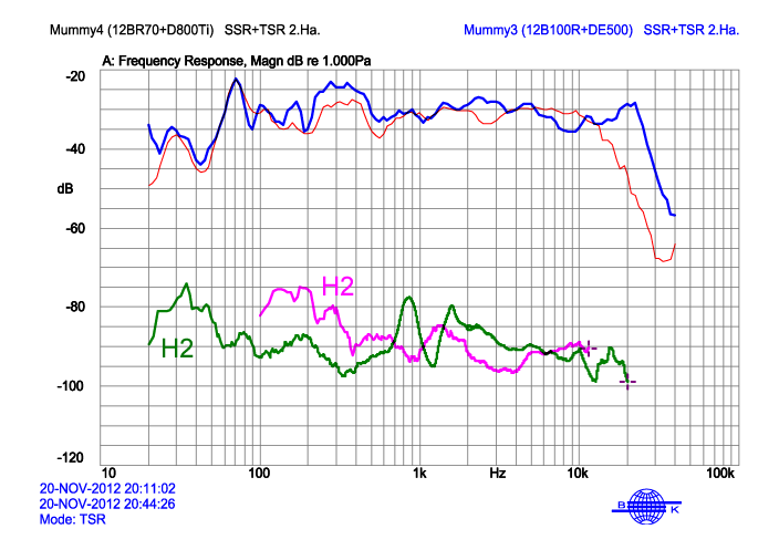

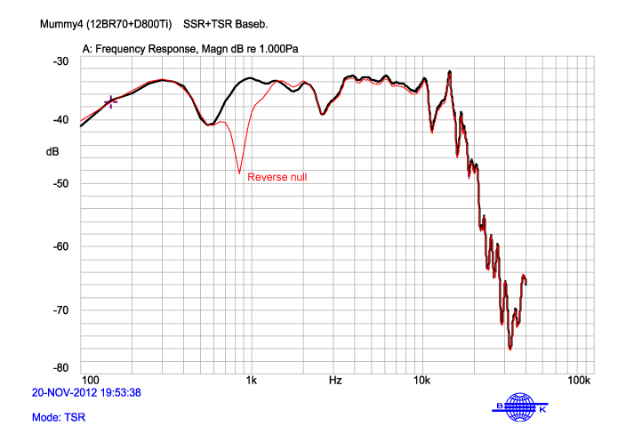

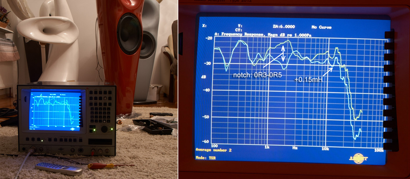

Today I've learned how to store graphs in BK2012. This is quite easy - you have to chose plotter as output device, then open in ABViewer for example and format. Quick and dirty comparison between 12BR70+D800Ti vs. 12B100R+DE500. Level was quite low a bit below 1Vrms but I couldn't set more because of family members. I'm sending Mummy 4 (12BR70+D800Ti) with minimalistic crossover to Lukasz for voicing, attaching Aquaplased diaphragms.
Pink is 12B100R 🙂
Pink is 12B100R 🙂

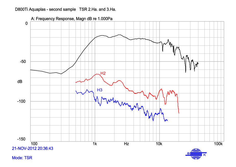

Second Aquaplased sample - one I've sent to Lukasz so couldn't compare but it looks worse. Practice needed.

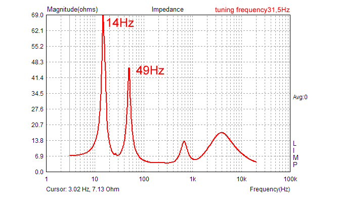

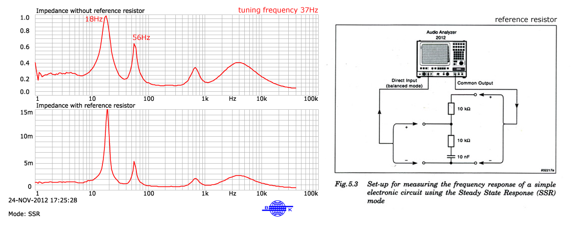

Mummy 3 (12B100R+DE500) measured in BK 2012 analyzer with and without reference resistor versus LIMP with reference resistor 18Ohm. Obsereve change in tuning frequency and Q of resonance peaks.
