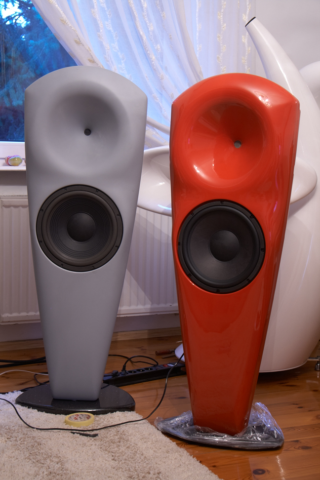

Jzagaja; Would you recommend a horn for the DE500?
I've been looking at your Iwata 600 a couple of times as they provide relatively short height (vertical) at a relatively low recommended x-over frequency. And I want to build a compact two-way floor-standing system.
So for instance your recommended Beyma element @ 90L + DE500 and Iwata 600?
I would probably experiment with an active x-over setup, unless someone recommends a good passive diy-design that works.
Regards 🙂
I recommend SEOS or OS with a below crossover:

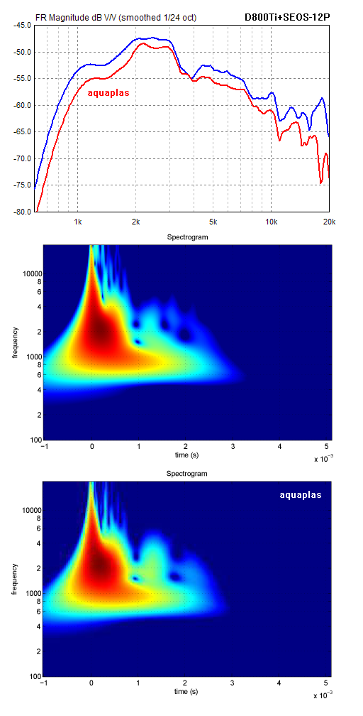

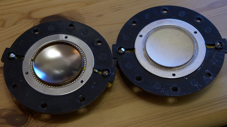

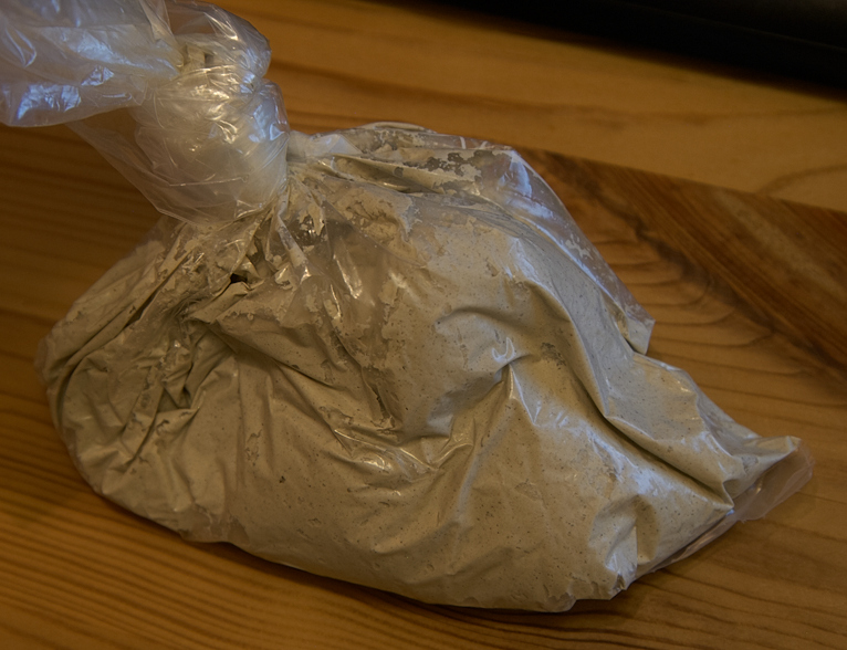

Got sachet of Aquaplas.
How is that evenly applied on the surface of a diaphragm?

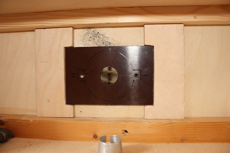

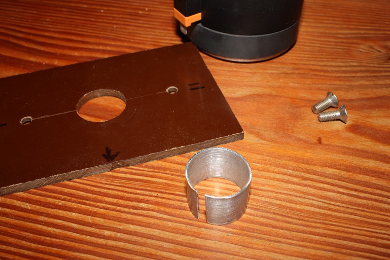

One may produce a "plug gauge" with polar graph paper and stick it into the throat to check fit. I have done this. I believe the included throat angle of the DE250 is very close to 14 degrees.
From this I made a wooden taper. I attached fine sandpaper to the taper to remove the mold marks from within the throat. The same served very well in smoothing the transition from driver to horn.
Better to get the mating surfaces lined up than to quibble over degrees. One degree difference will give you just about 1 foot in a hundred. 🙄

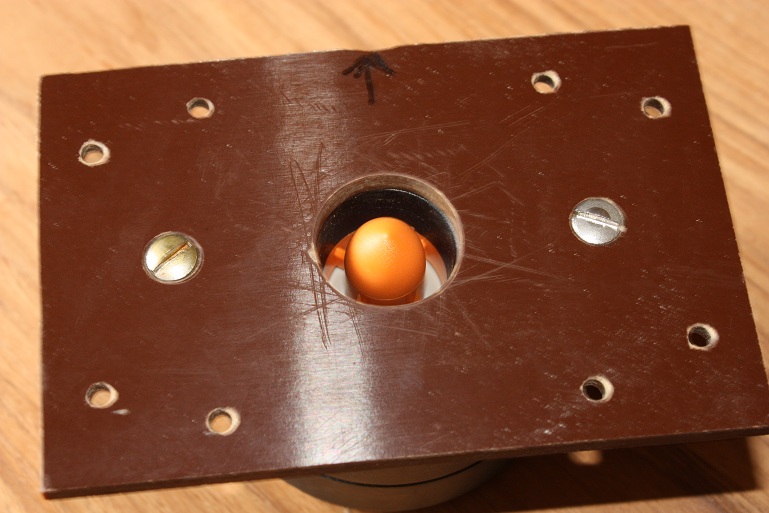

I just wonder what the exit angle is at the end of a phase plug like this one
theoretically probably completely wrong
sounds ok tho
