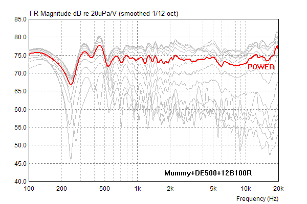

Today I could measure:

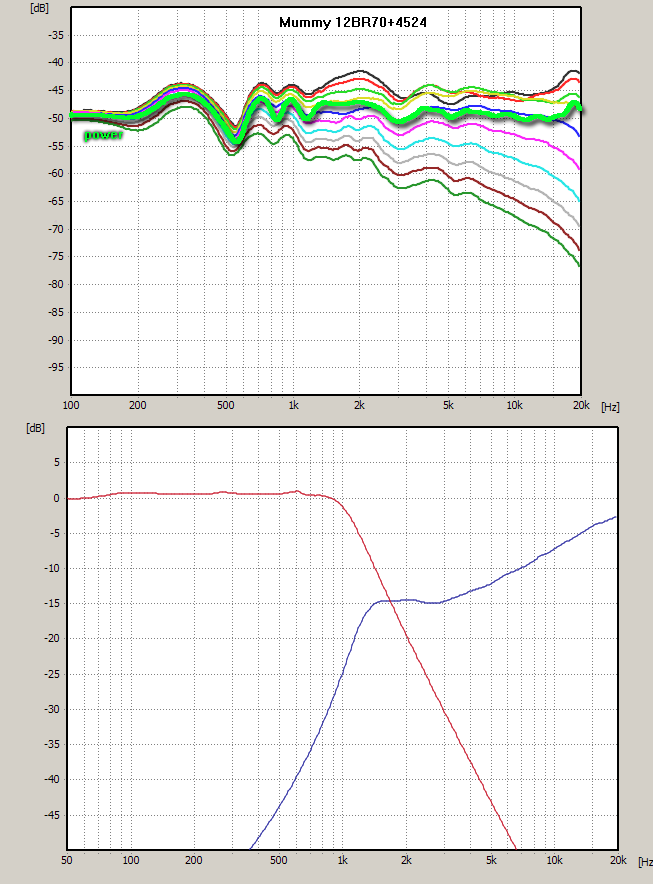

I'd say that curve looks extremely well behaved upwards of 500Hz, particularly to 5kHz, with the lower frequencies (especially the ~250Hz dip, as mentioned by DJNUBZ) marred by early room reflections perhaps? At least these irregularities seem to roughly resemble the measurements made on the BMS4524/12BR70 Mummy's, only placed a bit lower on the spectrum, hereby indicating perhaps the same measurement-related problems in this area.
Looking a bit closer, not that it may be of any importance, there's a "mild" tendency in the region 5-10kHz(initiated by a slight diaphragm break-up, perhaps?) and some excess energy above 15kHz - I wonder how that will translate sonically, if at all noticable..
Overall, and if the measurements are anything to go by, this appears to be a very well "weighed" sound. What are the cross-over details - any EQ, etc? Will this be the final cross-over design, or is it a work-in-progress?
250Hz is a floor bounce 🙂 Crossover has two notches: 320Hz, 2.5kHz. From the beginning I like the sound it's smooth. Now will assemble second unit.
Sounds promising. Do get back with impressions once they're both up and running 🙂 And any comparisons made with Mummy v2(BMS4524/12BR70), even though it's by memory, are most welcomed...

It's the 12B100/R(of v3) that puts the sweat on my forehead(combined with the lower cross-over to the DE500). The 12BR70(of v2), despite the high-ish cross-over of ~1.5kHz, mates very smoothly with the 4524, possessing a nicely balanced, deep when called for, natural, and agile sonic quality. Bass notes are easily followed through the deep/central to upper areas, maintaining their character, and the lower to central mids are noteworthy of being of a slightly though pleasantly warm, present, and full nature - bereft perhaps subtly of some minute detail here. It's in this rather vital area particularly, the lower to central mids, that I suspect the very low distortion 12B100/R unit(again, combined with the lower cross-over) could better the v2's. Moreover, how does the more powerful magnet and larger voicecoil(4" vs 2") translate with regard to bass reproduction? The 12BR70 is no slouch and can pound away very tightly with great detail and information, but the 12B100/R is a mean "schallmaschine," as the Germans say.

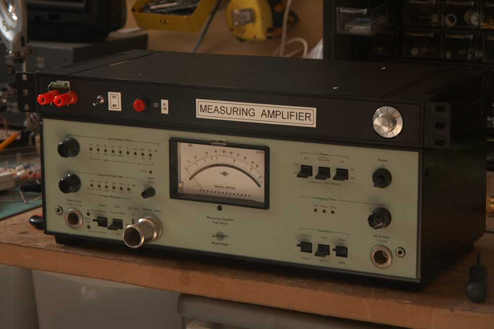

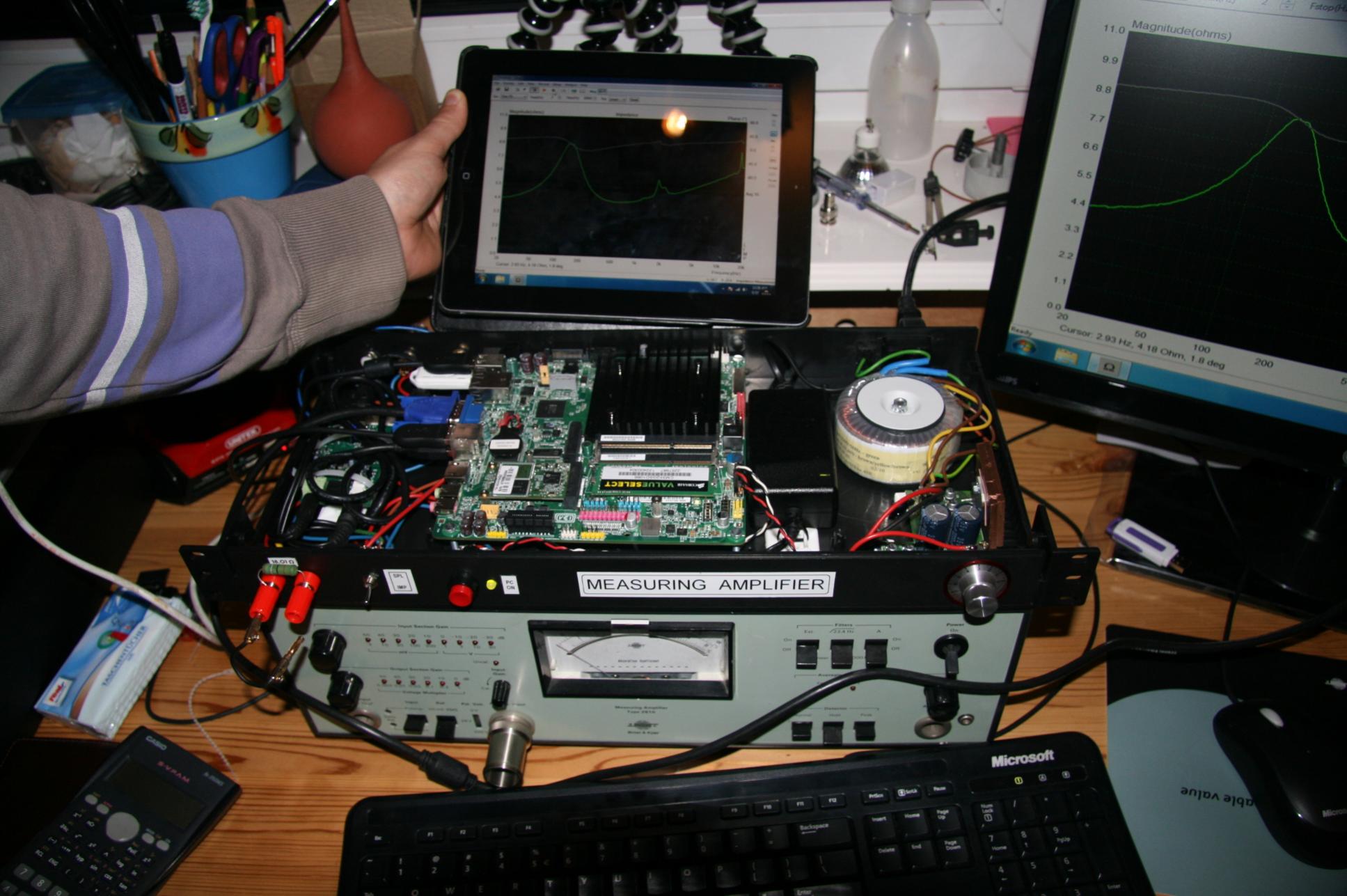

An example of measuring jig inside 1U rack housing (ABS), Intel DN2800MT board, M-Audio Transit soundcard and LM3886 amp (PM-40C). Remotely controlled via Ipad. Later I will add USB rotating table. Impedance plot of AFR 85mm unit.
