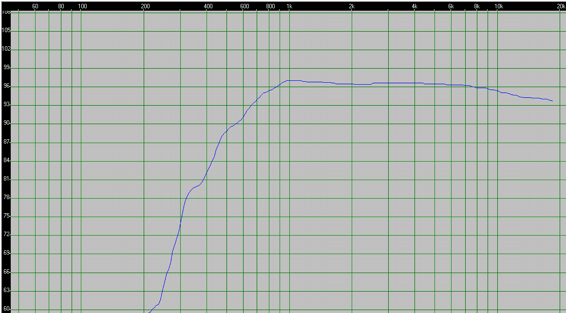

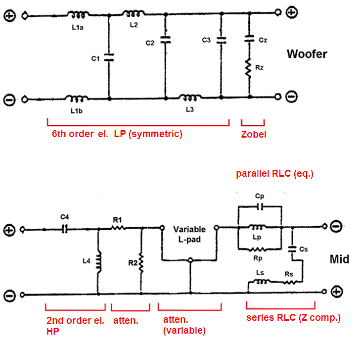

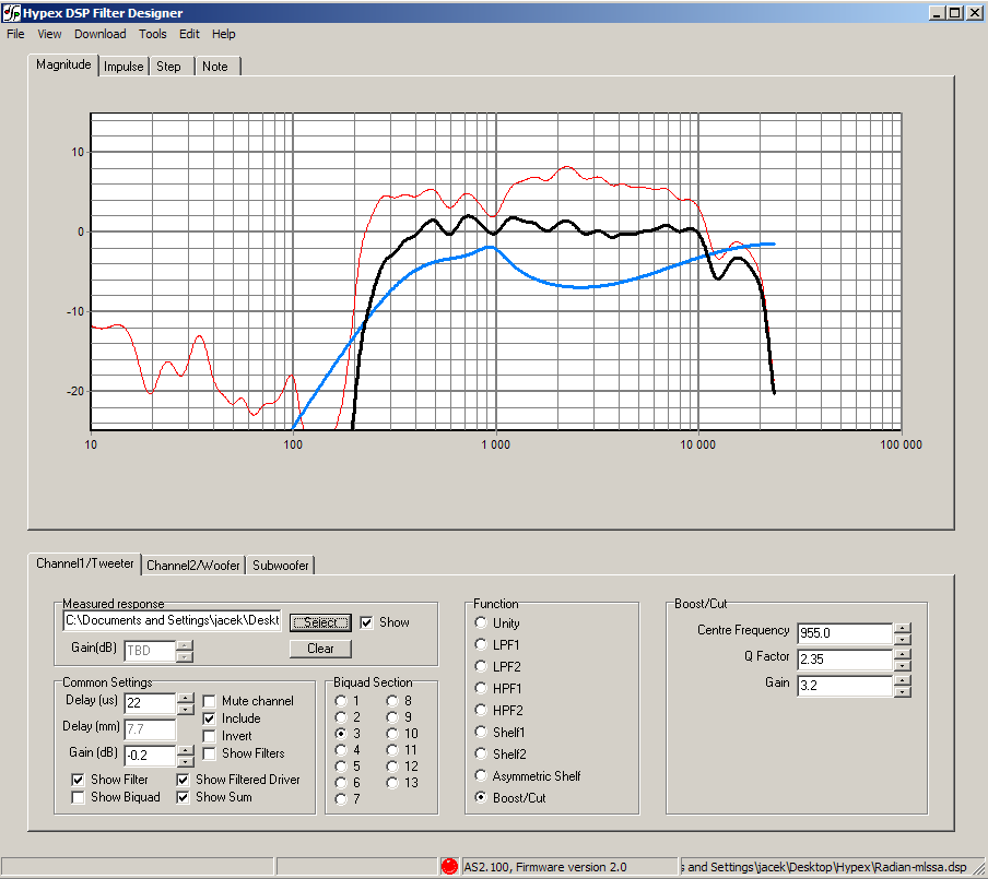

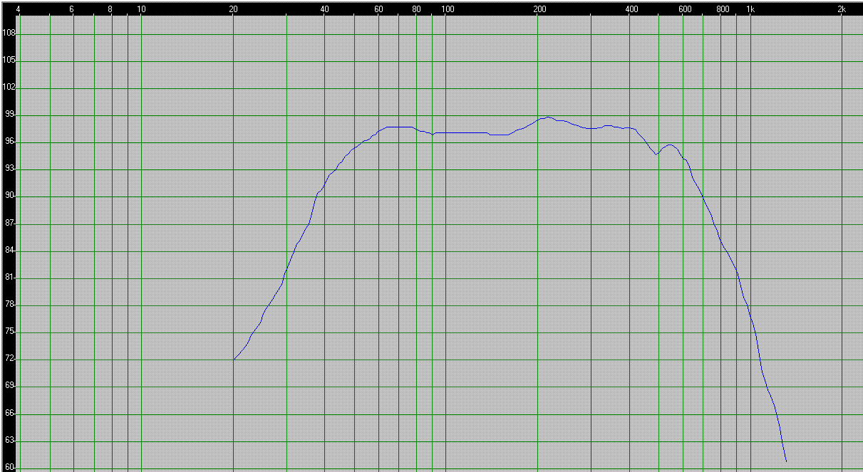

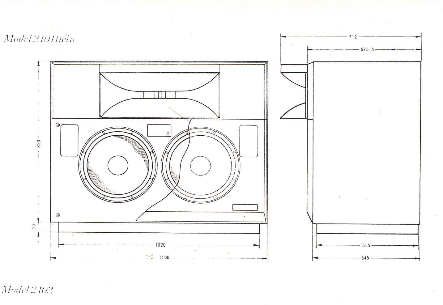

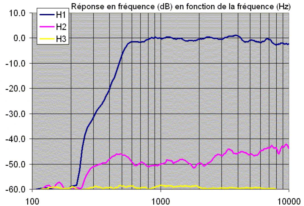

In attachment: (i) a technical drawing of the TSM-1 (2401) monitor, (ii) the filtered Woofer LP response, (iii) the filtered Compression Driver + Horn HP response, (iv) the passive crosssover schematic.

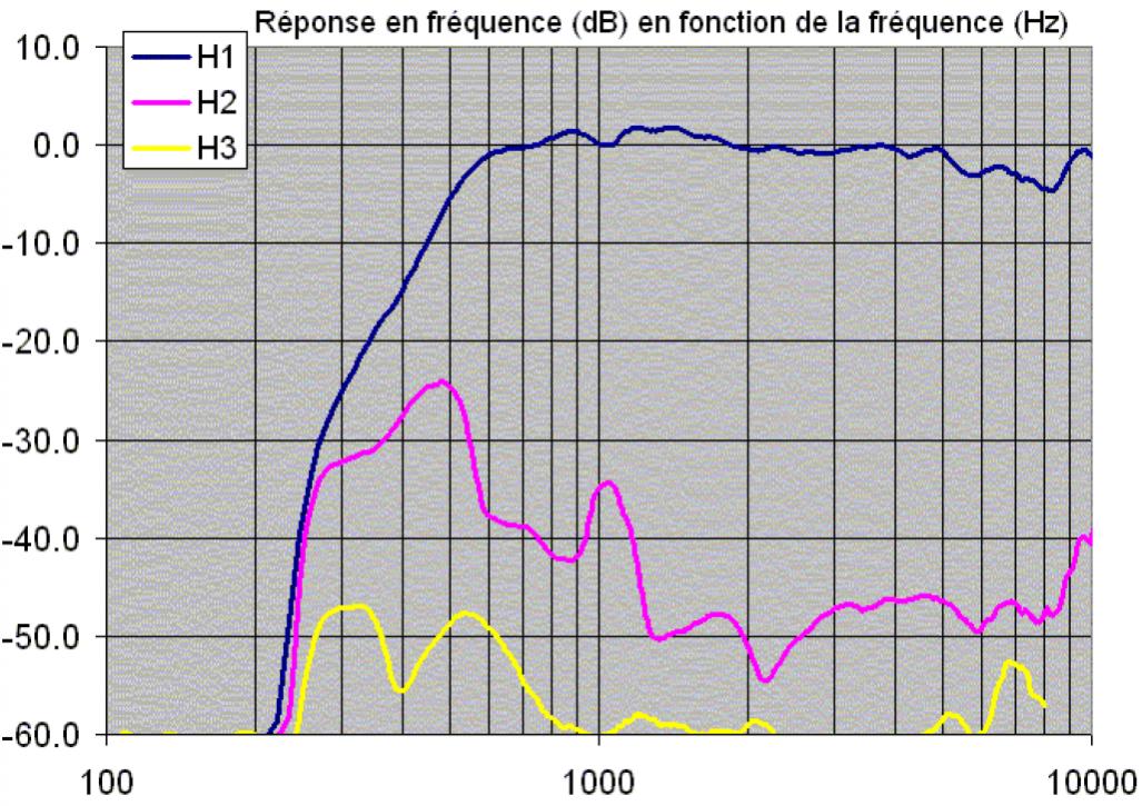

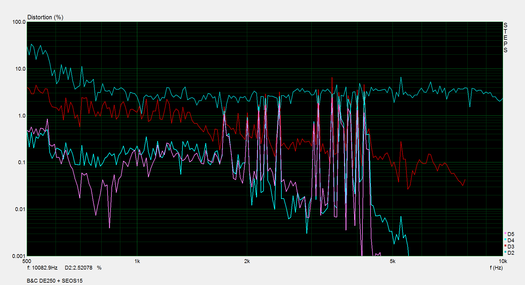

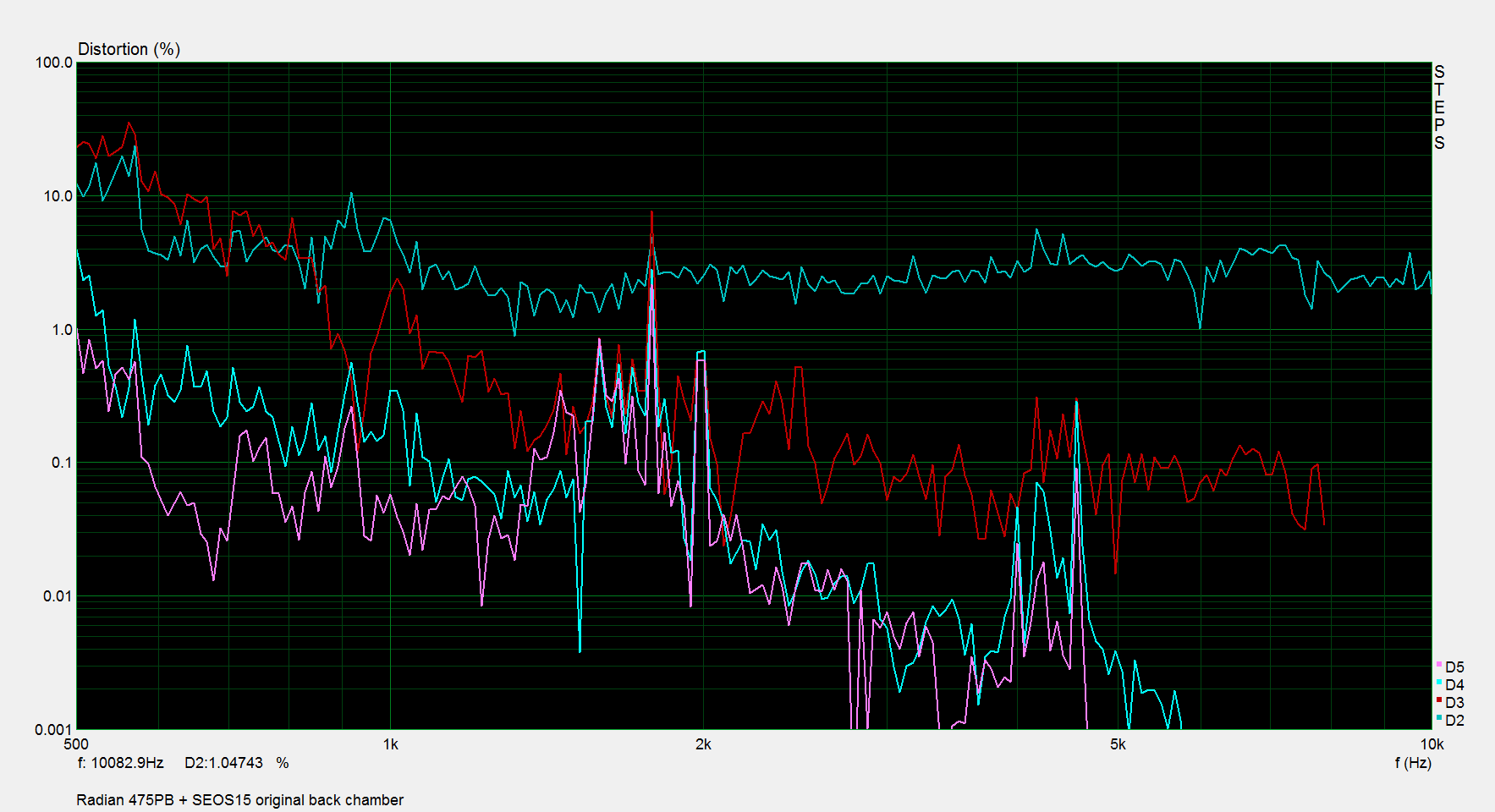

I have tried the 475PB on SEOS15. In my setup the 475PB created a sibiliant sound when crossed-over lower than 1400Hz - the lower the more sibilant the sound. I used a relatively steep FIR filter. However I enjoyed the 475PB when crossed over 1500Hz+. I don't want to jump into conclusions but switching to DE250 was a lot more successful story.
Please notice the increasing distortion on the 475PB below 1,3kHz (measurements taken on a fc500Hz Le Cléac'h profile horn - http://perso.orange.fr/francis.audio2/Comparaison_1pouce.pdf). It may be a source to the problems.

I also liked the Radian when using it 1500Hz+... I then prefered it over the DE250. DE250 is a safe choice but as you say, it is a little limited in the top octaves. Personally I haven't missed a super tweeter with the DE250 but it could very well be a good thing to try.

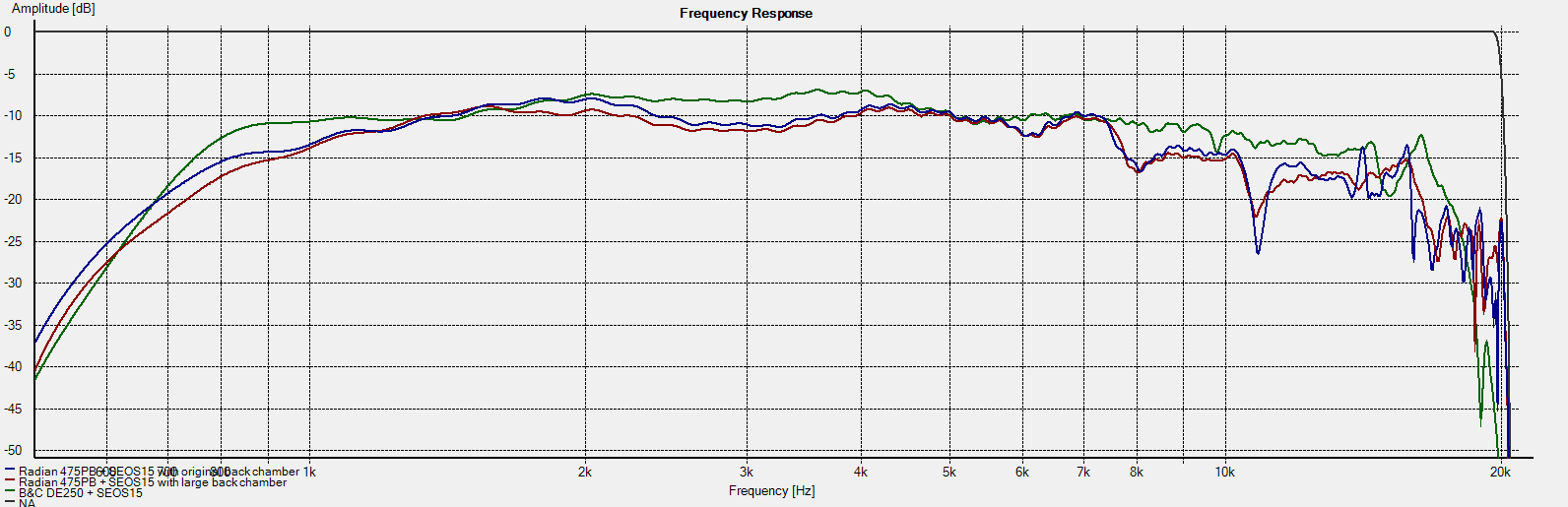

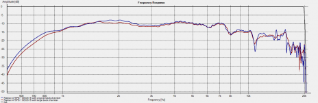

I might have memorised a little wrong (long time since I tried the driver) - that the sibliance was pronounced already when trying 1400Hz XO. But I am confident that I had successfull results with XO at 1500. Yesterday I hooked the 475 to the SEOS 15 again and ran distorion tests indoor on the bare WG's. Measurement was done at 1m with a SPL of about 105db (have not SPL calibrated the rig). I observed that the driver has a mode at 1780Hz (48samples/octave). I then removed the backchamber and stuffed it into a damped tube and the overall distortion was severely reduced... will make a mod to the chamber and try the driver again with lower crossover after this. I did also run comparison with the DE250 and the distortion figures on this one may explain why I prefer the 475 when crossing over high 🙂
Regarding large throat on the SEOS (preferably SEOS18); By now I don't know of any alternative to the TAD2001/2002 and the 951 is a lot cheaper. I have never tried the TAD's but I do know that the upper mid and tweeter performance of the 951 outperforms any of the cheaper 1" I have tried. I can perfectly live with the beaming starting at 14/15kHz.
Edit: All tests done under exact same conditions
