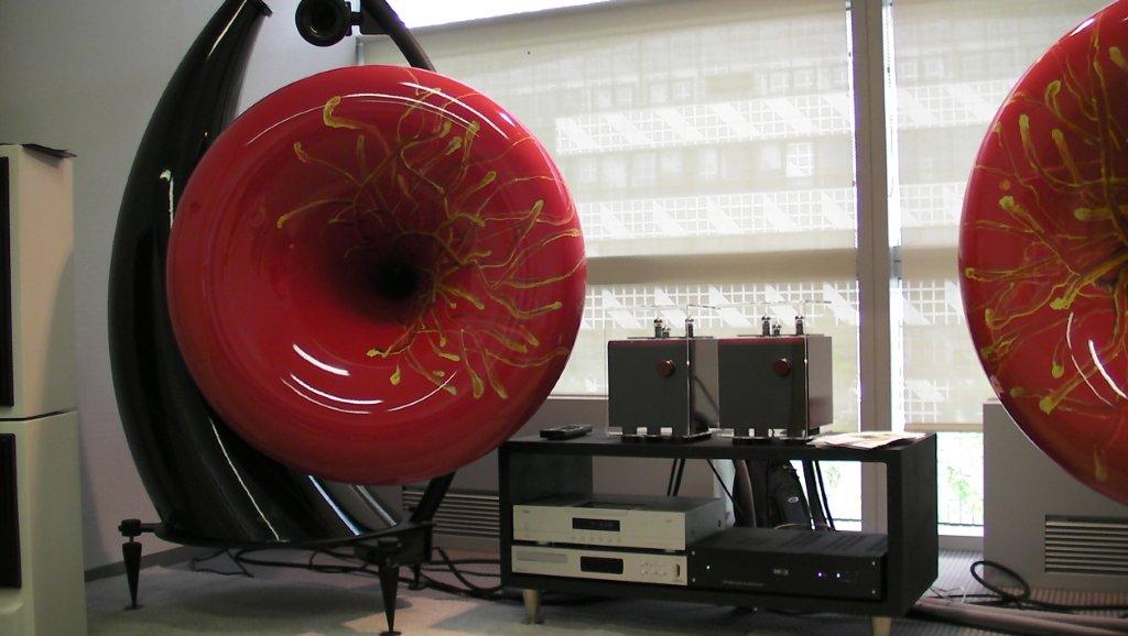

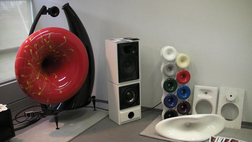

Thanks for the München pictures, Jacek!
Any reactions to the sound of the flatpack and/or Universum? Are the Universum's with the active bass module?
Still waiting for independent opinions - note that this two models were prepared only three weeks before trades, Universe virtually as we live 700km apart. What I know from initial trials is that DEQX or similar processor (OpenDRC+AcourateDRC) are highly recommended - DEQX is used by Autotech but only as a DAC (microphone failure). Universe uses active Kappa 15A. For more extensions we could try Dayton Reference. There were questions about open baffle construction as well.

Has the München exhibition gone over well for Auto-tech?
You should've brought pair of properly run-in Mummy v2's as well - people would have eaten them up 🙂
The room was small, the sound was good. I listened to Universum - really good; balanced and natural sound.

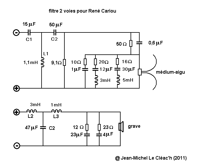

Hello Carl,
I used to optimize a passive crossover for my friend René Cariou for his system that uses a Radian 760 NeoPB on Iwata 300 without tweeter for the mid and the high frequencies and a Davis 40 RCA in a bass reflex for the low frequencies.
That passive crossover provides impedance linearisation of the drivers and also some equalisation for the Radian that allows to not use any tweeter. The sound of that set-up is just excellent.
See attached the schematics of the passive crossover.
If you have both the impedance curves of your loudspeakers and their response at 1 meter then I can calculate for you such a crossover which leads to better results than most conventional ones.
Best regards from Paris, France
Jean-Michel Le Cléac'h

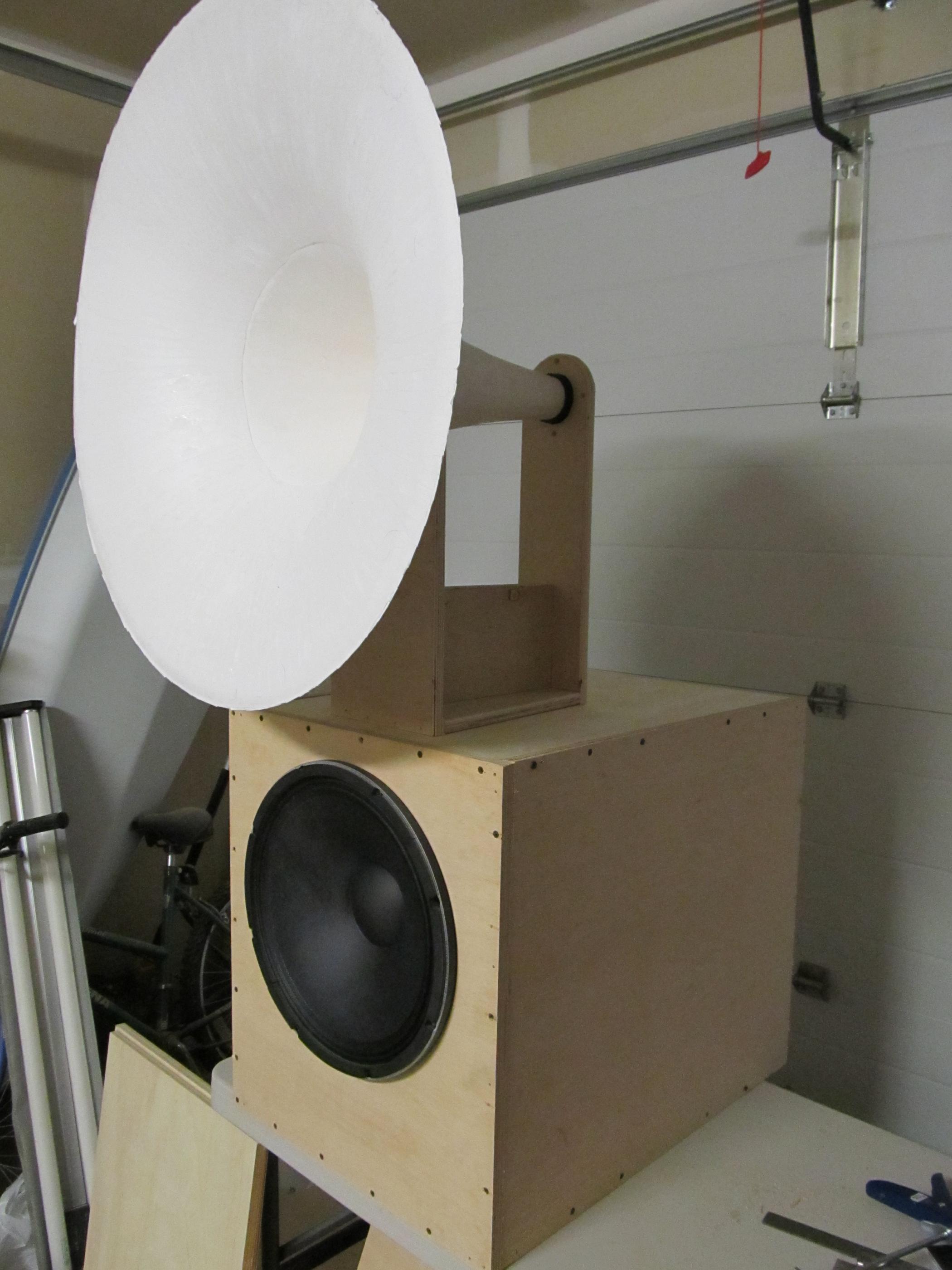

Jean,
I would be very interested in your help with a passive crossover for a design I'm working on. It is a large 300 Hz tractrix horn mated to a 15" vented woofer. I'm just completing the horns and will begin crossover work this weekend. See attached pic.
My biggest concern in designing a passive crossover is accounting for the delay in HF arrival with respect to the woofer acoustic center.
