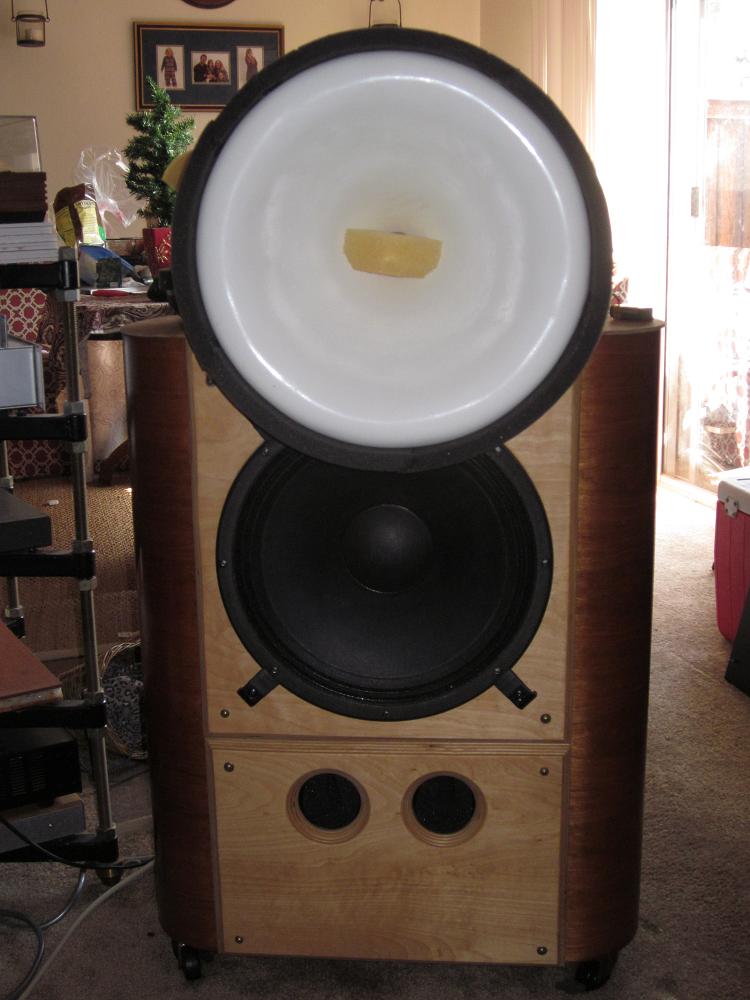

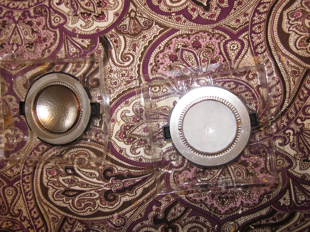

Here is a still-drying final coat next to stock (and the speaker it's used in, with my OSWGs)
Took about 10 thin coats over the weekend to get it there, but it's overall a pretty thin coating. Based upon impedance sweeps, I added a little extra to one driver, which got them very close in electrical performance.
A slight reduction of frequency of the impedance peaks (about 5%) and damping of both peaks, especially the higher freq peak (which also fell from 12.5 ohms to 10.5) was the electrical result of the mod.

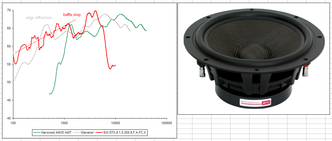

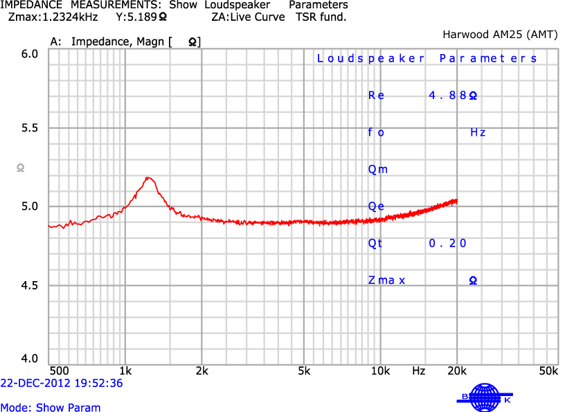

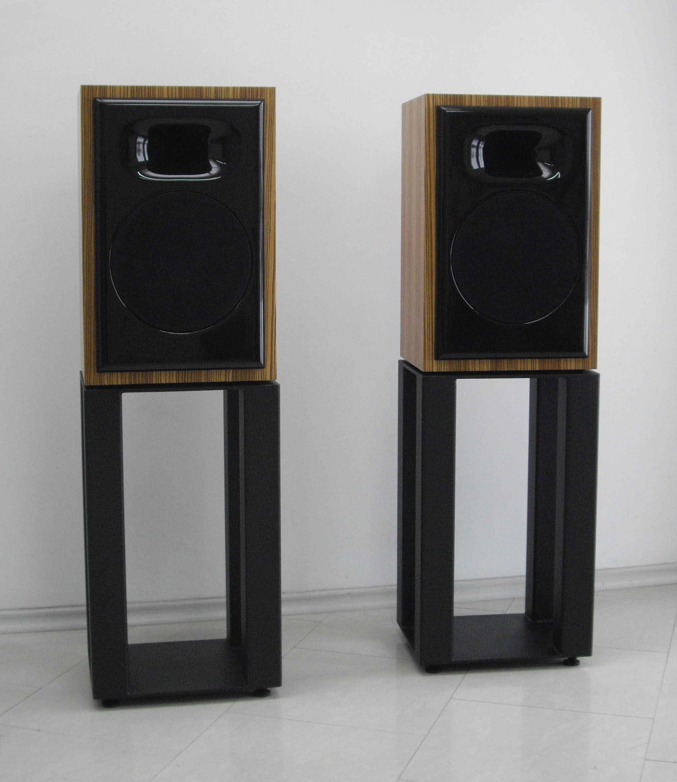

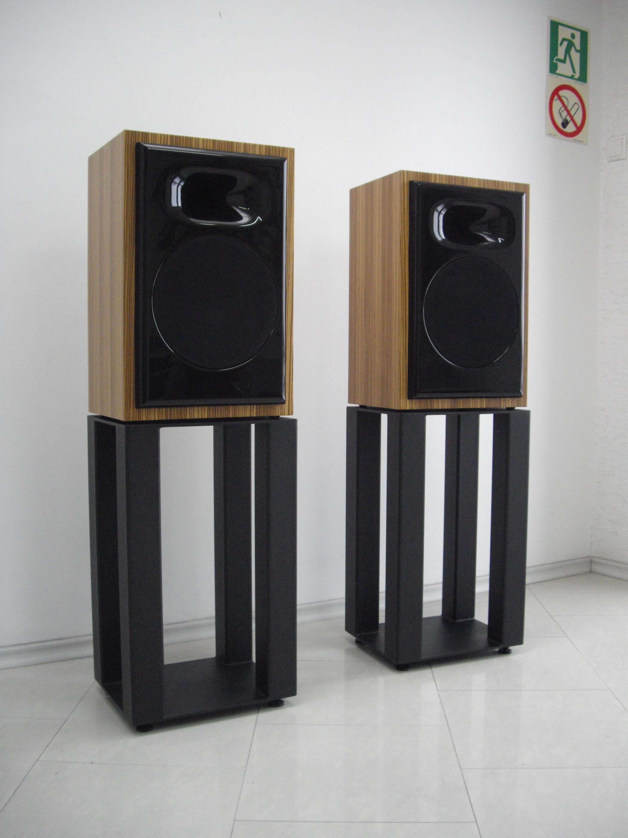

My friend did near field monitor based on AMT AM35, Wavecor midbass and STX carbon woofer (very stiff diaphragm). Today I made measurements using 2012 analyzer and exported to XY ASCII - it only requires rearrange in Excel to FRD format. Some data for educational purposes below.

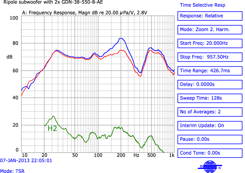

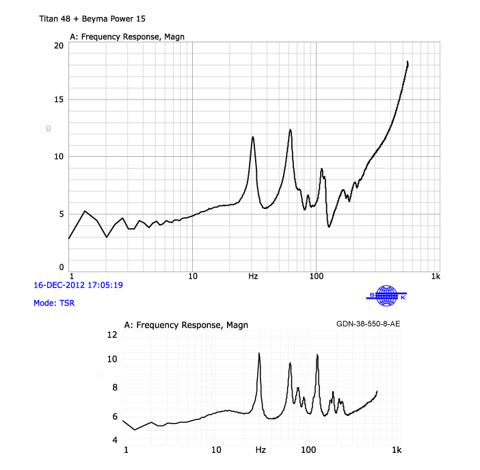

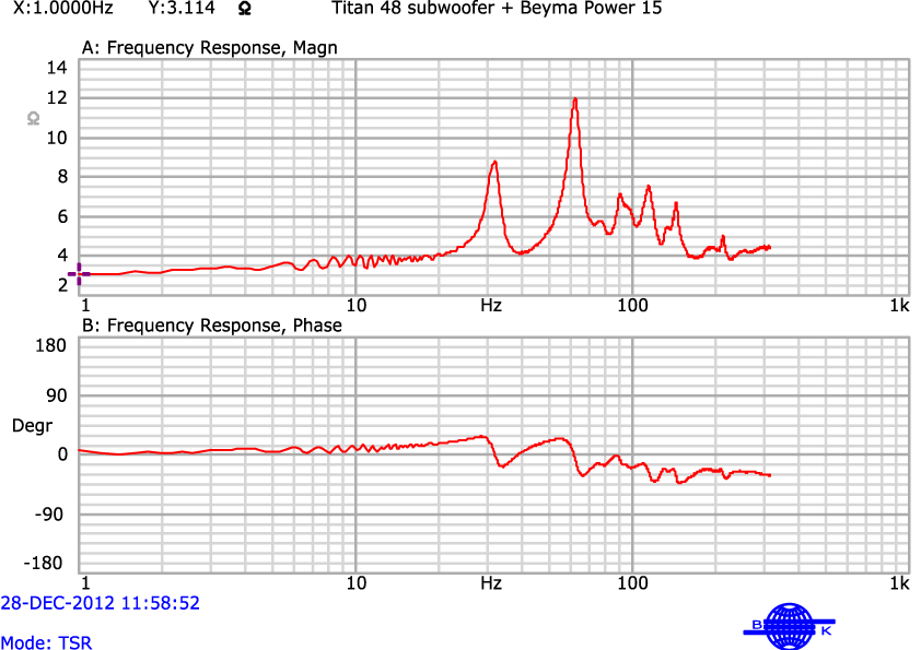

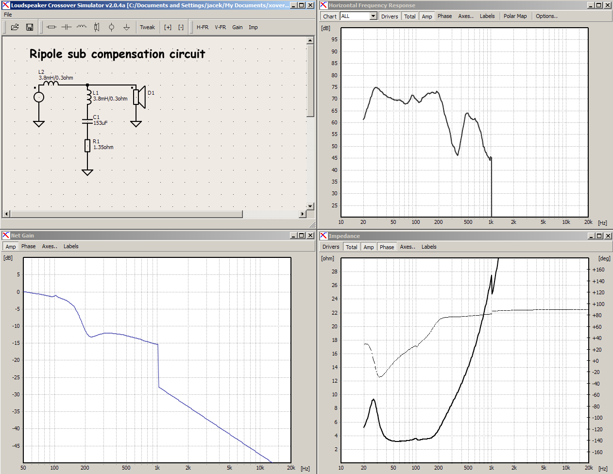

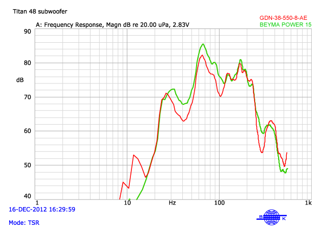

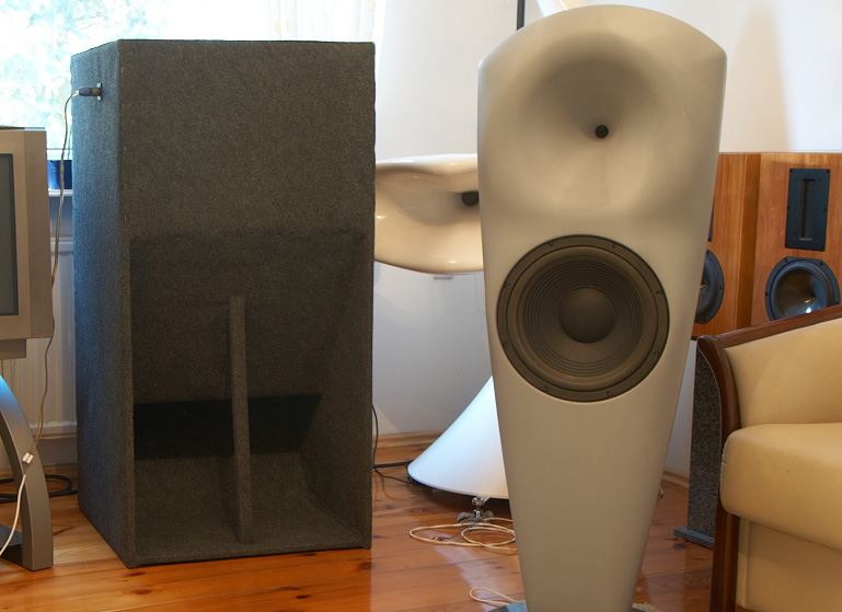

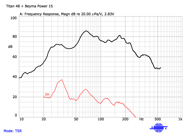

PA horn sub lacks fullness. I did quick and dirty ripole sub and I like results very much (actively driven) but midrange peak must be equalized completely and everything above removed. At the moment I don't have coils above 4mH for compensation circuit - better is 4,5mH. Bass is just right in some places just thinner.
Ripole sub - YouTube
