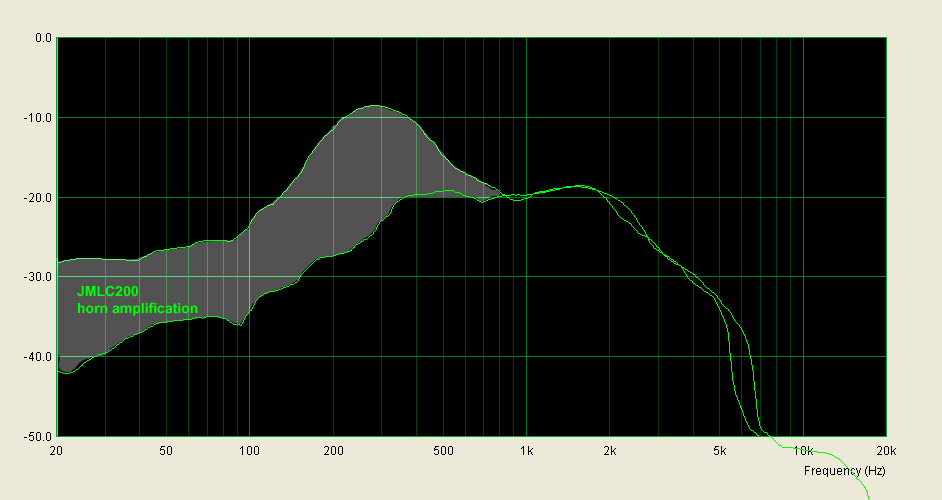

For wide bandwidth single horn application Iwata and Ejmlc (check website for new models) are recommended because for example JMLC-200 power response expose midrange and in weakly furnished room for some can sound like a megaphone.

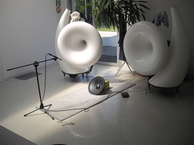

Earl - we are trying verify Hornresp simulation and its numerical model may not be suitable for this kind of arrangement i.e. short midrange horn JMLC200 plus woofer in closed box 75-150 litres or open baffle. Horn subwoofers produce active sound field different than of reactive from closed/ported/open boxes. As for the directivity control it is used above 200Hz so not related with above experiment.
