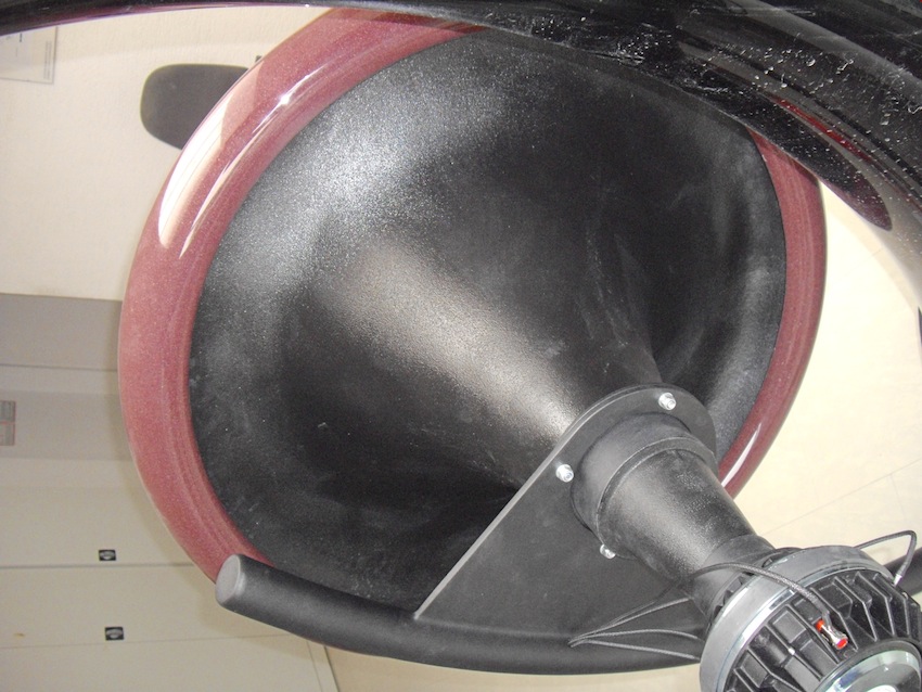

Anyways, I wanted to know if autotech has a perfect adapter for the IWATA-300. On the website they say there is a 1" reduction piece. I guess I have to find out how much that costs and get it shipped from Poland.

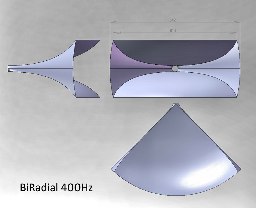

Conical adapter or new planned BiRadial (similar to JBL 2345 and TH4001).

How does the differing angles from these adapters effect the response?
The TAD 4001 and 2001 are Alnico-based drivers with a rather long, radial throath like the JBL 375. Due to the fact, that with Alnico - more length more flux.
The 2" - 1" adapter prolongs the hornstart with exactly the same flare.
Newer Neo-drivers are build to shorter horntypes and have a much shorter and much more angled throaths. I use the original Iwata with a 950, which has a 10 degree angle - but it is just about 10 mm. in length. With no sonically problems.
(Measurable, I don't know).
