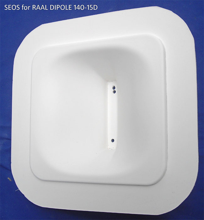

Tractrix beams less - see attached half polar. New waveguide concept for RAAL 140-15d.
What flare cutoff frequency are you using for the waveguide concept for the RAAL 140-15d (non-dipole)? Or is the SEOS for the DIPOLE version the only RAAL waveguide designed?
Ca. 1kHz. For both monopole and dipole 140-15d.
Thanks, that sounds very interesting. Please post when these are available.

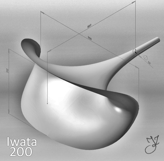

Iwata 200 is 900mm wide and 512mm in height. What happens if I rotate the orientation and place it at 512mm as width and 900mm as height?

Then the horizontal and vertical dispersions would be exchanged.Iwata 200 is 900mm wide and 512mm in height. What happens if I rotate the orientation and place it at 512mm as width and 900mm as height?
