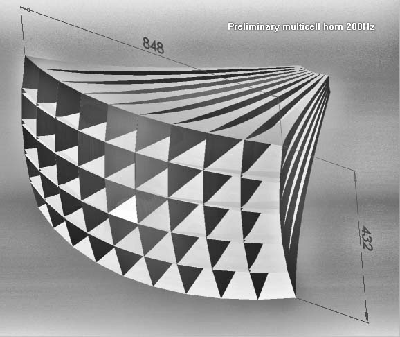

OK guys I love all your horns. Great Great work But it time to make a multi cell for the masses. I want a big long 200hz multi cell. 2 part casting I guess. Even just a single row of 5 cells slow opening. Made light so we can either sand fill or epoxy fill on assembly. Leaving the throat clear so we can reinforce with cf as the throats have to be really hard in my opinion. Is why altec used brass throats. Even a horn with vanes would be a compromise. Cmon make my dreams come true. And totally ruin all the vintage multi cell horn hoarders crasy prices that I cant afford. There is just no economical solutions to multi cells out there in the market. They would cell like hotcakes. Not that I have ever bought or sold hot cakes.
Then when you done that make a WE31a copy with slightly narrower profile for stereo. Another big seller.

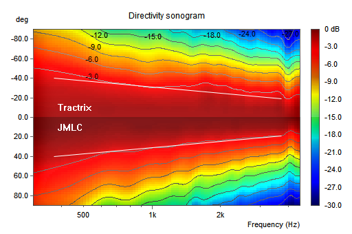

Hello Jack,
Depends on frequency window and normalization.
The polar map normalized on axis (as it is with both the 200Hz Le Cléac'h horn and the 200Hz Tractrix horn) should not depends neither on frequency windows neither on mormalization.
Or there is something you have to explain...
And as we can see on your graph:
http://www.diyaudio.com/forums/atta...341918-waveguides-horns-tractrix_jmlc_dir.png
the problem I mentionned (increased directivity of the Tractix below 1800Hz) will not be removed by any normaliztion...
Best regards from Paris, France
Jean-Michel Le Cléac'h

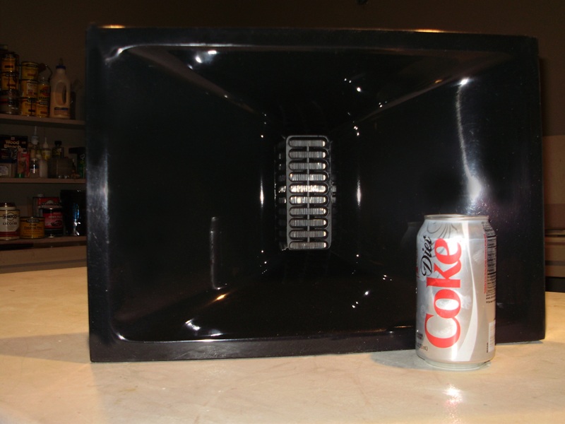

Fatbattery - do you mean classic Wente's multicell horn with smaller high frequency subhorns?
Sorry for the Delay and the answer is yes and no. Yes multi cells but just 1 row of 5 cells would do. Better dispersion and less beaming then the round horns. Lower fc with room to fit tweeters horns in on top and bass horns in on bottom. I realize a full multi cell would be too hard to cast. But for big rooms there the ultimate.

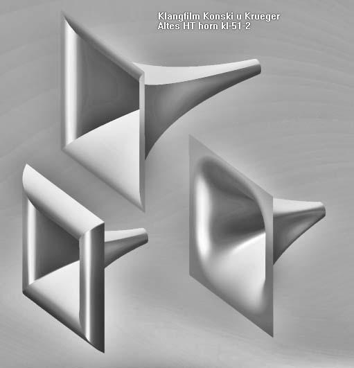

BTW the klangfilms are cool but I am not sure what advantage they would be as your modern horns are Superior. The multi cell and 31a have something that your current horns can not offer. Dispersion and a lower fc. Vital for good vocal reproduction. You try get that low a fc in a round horn and it so big its beaming and too big to mount a tweeter next too. This is where the multi cells and 31a's excel and why imperfect old vintage examples sell for huge amounts of money on ebay.
