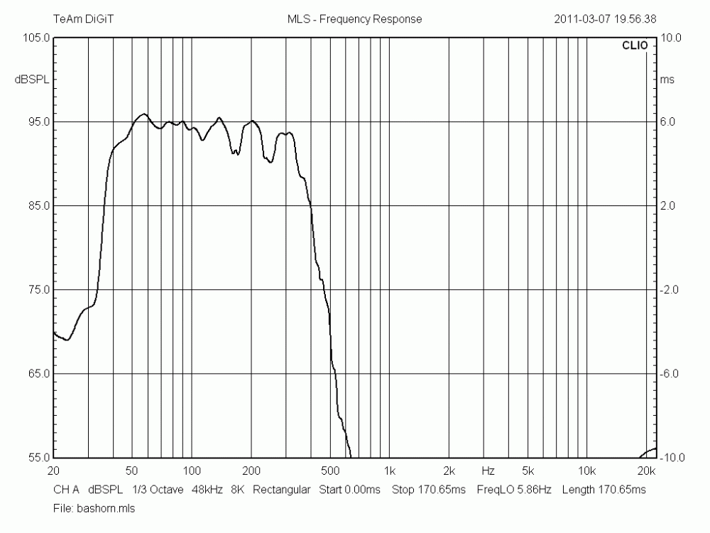

Have you seen the low cost flat pack horns on AVSForums?? Have you seen the new F-20 horn design with 20Hz and HUGE output with a $70 driver (MFW-15). It makes a lot of sense if you look at the numbers plus the $$$.
The numbers simply say it makes a lot of sense!! here is a thread that makes a lot of sense http://www.avsforum.com/avs-vb/showthread.php?t=1329971, there is are many other builds that make sense. The DTS-10 is a monster choice for low power high output down to 12Hz.

Can you please elaborate why bass horns will not work in a small room? I'm about to build some, so I would like to know in advance if they are not going to work. Although, I don't see how they won't work.
My understanding is that below the corner frequency of the room, horns cease to function as horns. There is apparently some debate about it, and I'll admit that I could be misunderstanding as I haven't studied anything related to horn subwoofers in a couple of years.
However, if my understanding is correct, there is little use building very large horn subwoofers when multiple direct radiators can perform similarly. I have yet to hear a horn based subwoofer solution that made me think I was missing out using a distributed bass setup.

1. Fractional of power needed. I need thousands of watts in my LMS-5400 sealed designs to get the same output @ 15Hz that the DTS-10 has with 100 watts.
2. Lowest distortion. Look at distortion measurements of the horn vs any other bass design within the operating range of the horn.
All of these numbers have been measured and posted by Ricci over on AVS.

Do you know any other design that can do reference @ 15Hz clean for $500 and 300Watts?
This one shows how to use a 6.5" driver and produce quality bass for music.
Group Buy for 6.5" Anarchy Tapped Horn. - AVS Forum
This one is my current favorite. It uses a $70 driver (MFW-15 driver from the now defunct AV123.com audio company). Lets see $280 in drivers/$250 in amps and a person can have > 120dB @ 21Hz with < 5% distortion.
