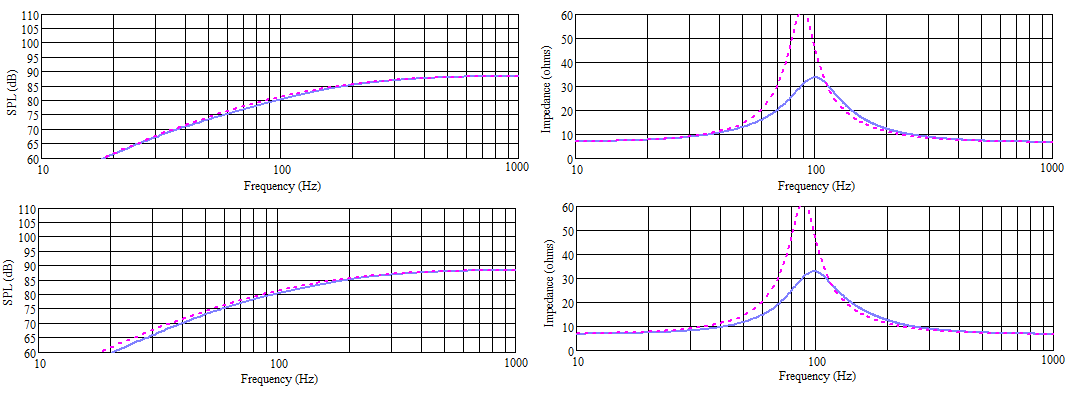

It's too long since I last saw a pair to remember if the three upper pipes were 1/4 wave or 1/2 wave. I thought they were all sealed, but stand corrected if otherwise. The tweeter pipe will likely have been cosmetic if open, given the delicate nature of the loadings involved for these units. Otherwise, assuming the pipes were designed appropriately to the configuration & they're targeting suppression of the back wave, either quasi-aperiodic 1/4 wave or a 1/2 wave sealed line works fine. Basic example attached, tapered pipes identical other than the upper being a 1/4 wave (terminus open) & the lower a 1/2 wave (sealed pipe). These are not optimised & purely for the sake of example. However, as you can see, if you're primarily interested in suppressing the back wave, they both do a similar job. I haven't time to add the displacement, impulse etc. plots, but for the purposes intended for these pipes (please note caveat) there isn't a great deal between them. All fairly standard, no surprises here.

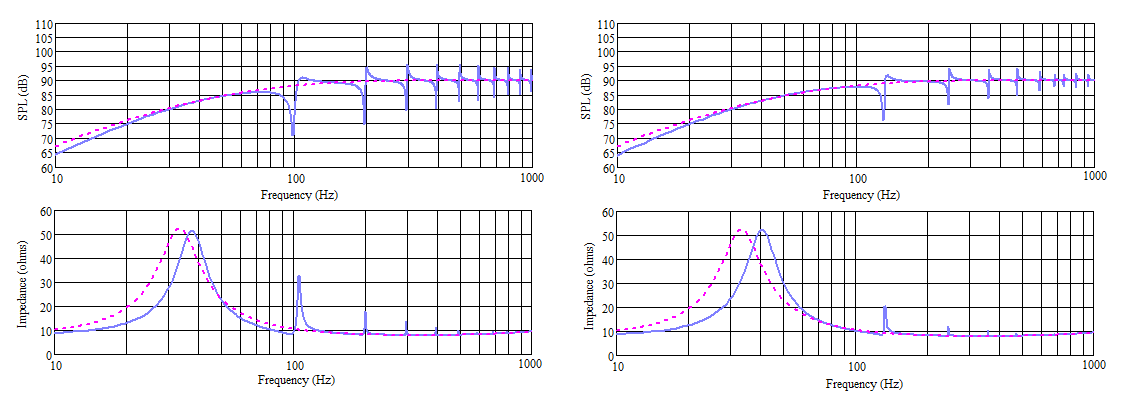

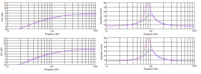

There is no single answer to that as taper is only one variable & it depends what is happening with the others. Back in post 45 I provided a comparative graph between two 1/2 wave lines of identical axial length (this results in different 1/2 wavelength resonant frequencies) & volumes. They were deliberately left completely undamped, and were end-loaded to ensure the standing waves had maximum excitation & were as obvious as possible.
Plots attached again here for simplicity. Left column = untapered, right column tapered to a terminus of nominally zero area.
