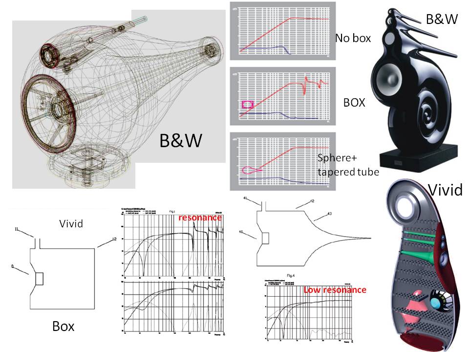

In light of your remarks I would conclude the circular cross section B&W uses would be the worst in that all such modes will coincide because of the single diameter. Same for Vivid audio.

Yes theoricaly a circular non tapered cross section is a worst case scenario. But in practice this may be a valid approach, i ve seen some project based upon tube and outcome seemed to please the owners ( i ve never heard a design like this so can t speak about them from experience).
Thanks to this thread i may understand why the owners of such system are pleased even if they based the design more on a typical closed box (volume needed for the driver only) but with progressive stuffing of the line.
Anyway, about B&W there is multiple version of the circular chambers used, some have a tapered line after the 'bowl' shaped chamber (like the Nautilus second lowest way iirc), some use an oval/teardrop shaped chamber (and specificaly shaped motor piece) to redirect backwave and rely on diffraction to control standing wave from their technical(?) description.
I must admit i m a bit sceptical about the second solution because of the supposed bandpass of the way (wavelength at work are probably to long to be affected). But i don t know maybe other principle are at work...
Whatever i ll try a closed TL in comparaison to a standard "regular" closed box of same overall volume with a full ranger (M.A. alpair7 1st gen which wait for a new box) and make my own conclusion from there.

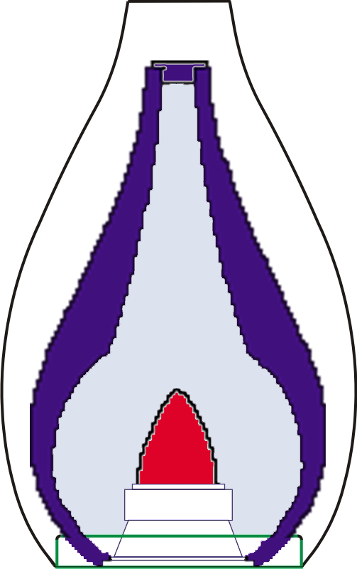

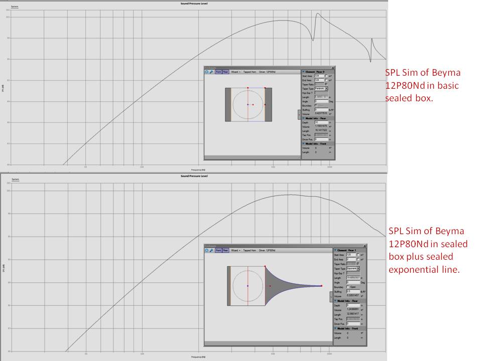

Thinking about testing a sealed TL for sequestering the back wave in a midbass section. Am I on the right track?
TL length: 1/4 wavelength. Not 1/2 WL, right?
Midbass will play 60 to 350Hz. Since 1/4 wavelength at 60Hz is 143cm. That is the minimum length I'm solving for.
Folded line OK
1.4m is too long to make it a straight line, so folding is in order. At these frequencies super smooth folding like the Nautilus isn't required, but better to make the first section of the line as long as possible before the first bend and avoid 180 degree bends; 90 degrees much preferred.
Rectangular cross-section OK
At these frequencies the cross-section shape is not critical. Rectangular is OK.
Taper?
While exponential was mentioned as optimal, sounds like a linear taper would be almost as effective and much easier to implement. How about the taper rate? Would taper/constant section/taper be a no-go, a non-issue, or just don't know? Seems an initial section with a fast taper, followed by sections with slower taper would best approximate to an exponential, so wouldn't hurt.
Any consideration towards Qtc?
For my 10" midbasses a Qtc of 0.7 is achieved with 11 liter cavity, so a fast initial taper would be required and then transition to a slow taper to reach the 1.4m length required.
Same 10" need 28 liter cavity for Qtc=0.5, so allowing for a much slower taper and of course a much larger cavity.

Tl length: .Edit : no if you go sealed the length should be 1/2 wavelength, so 286cm
Folded line : i won t be too worried about the bent, look in previous post in the thread' Dave gave an ok for a 120 to 1k line with multiple 180bends.
Rectangular: yes absorbtion should be ok to tame artefacts,
Taper: i agree with you.
Qtc: use a linkwitz transform! Any qtc, any fs (given reasonnable limits and a little max spl loss if you want to go lower).

A 1/4 or 1/2 wavelength is irrelevant because all the sound is going to get absorbed. The length needs to be long enough to absorb all the sound given the stuffing. The stuffing should start light and get progressively heavier to avoid significant reflection. The line should taper in order to increase the velocity and hence the effectiveness of the stuffing.TL length: 1/4 wavelength. Not 1/2 WL, right?

To help smooth that flowing shape even further, the midrange of the B&W speakers of subsequent models (like the 800D1) had a surround that doesn't stick out.
In the days of the Nautilus design, still with Laurence Dickie on board, B&W had a lot of attention within their designs to avoid the negative effects of diffraction, using smooth shapes like these. Dickie resumed to design speakers with features like that at Vivid Audio.
