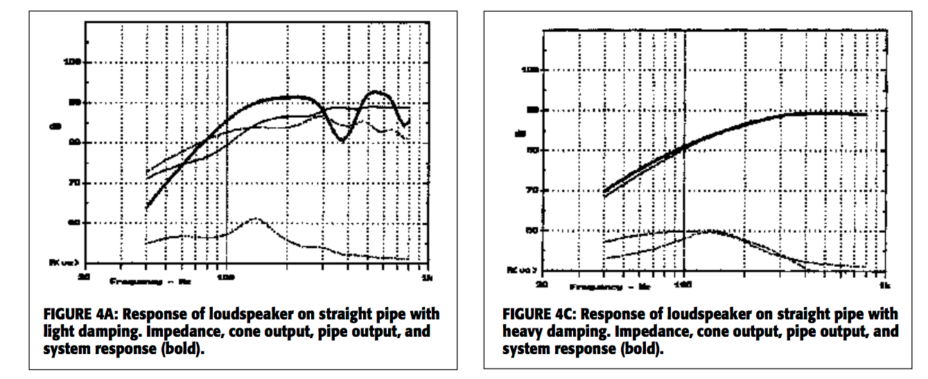

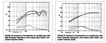

As I have shown above, blanket assertions that all pipes have 'awful spurious resonances' are completely incorrect. For example, I posted the plots of two closed pipes above, both of which were completely undamped for the sake of clarity, which clearly demonstrate only moderate issues with harmonic resonances that are very easily suppressed with minimal lagging of the pipe walls (also shown). I requested at the time that somebody explain how these easily damped harmonic modes were in fact catastrophically bad, as had been previously claimed, but answer came there none.
And attached below is what Augspurger has to say about "moderate issues" in a pipe with light damping*. Not what i'd call moderate, even without seeing the additional noises that would be higher in freq.
Yes, you can add enough stuffing to kill the higher noises but it seems to have killed the lower bass too. Yes, you can make very good TLs for woofers as Augspurper shows later in his article; done it myself. But you can't make a good one without stuffing.
We seem to have a case of people who truly love pipes - both exponential and parabolic. What we aren't seeing is any reason to favour them over simple damped boxes for higher range use where the driver's resonance is not within the passband. Maybe some vendors like to fix problems that are imaginary.
B.
*ummm, Augspurger's group of plots on the left sort of resembles what I posted.

So what you are saying is that you have taken a single example of an open pipe not optimised for such use (no taper, no mass-loading, no driver offset, no terminus offset, nothing: just an end-loaded pipe providing maximum excitation to the fundamental and all harmonic modes, fully open at the opposite end) and are claiming universal applicability.
In other words you claiming that driver offset, taper, mass loading, terminus offset &c. have no effect or relevance. Since that flies in the face of thousands of examples in daily use and the laws of physics, I'm afraid that is a somewhat questionable assertion. You have also inadvertently neglected to mention
-The pipes I referred to as requiring minimal damping were closed (as in 1/2 wave) pipes, not QW which is what Augspurger is referring to
-Augspurger had a fixed set of alignment goals for the TLs in his paper, and
-Refers to some of the effects of these characteristics later on in it also.
Augspurger's work was very good for near aperiodic QW TLs approaching flat impedance designs, and is required reading on the subject. He did not extend it though into higher taper ratios, detailed examination of driver offsets for these or other pipes, and / or in association with other types of line, the effects of mass loading &c. Nor did he refer to sealed lines. Since you make very strong statements on the subject of all lines irrespective of type, it is a trifle surprising you have yet to mention these rather salient matters and their effects. Perhaps you would care to do so, and explain why you appear to be claiming they have no influence on behaviour, and how, to use a simple example, a well designed MLTL suffers from all these horrific issues you describe. Especially the ones that don't.
