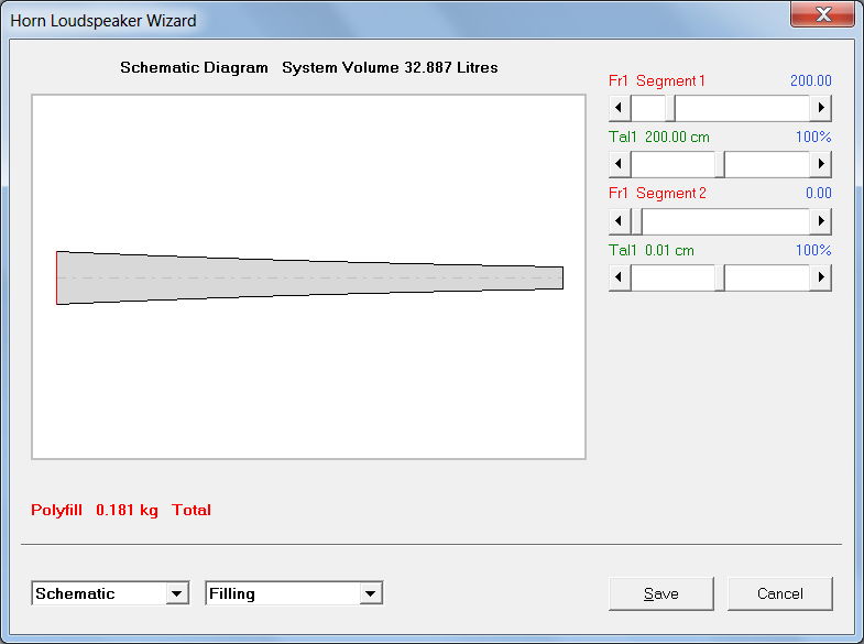

Thinking about testing a sealed TL for sequestering the back wave in a midbass section. Am I on the right track?
TL length: 1/4 wavelength. Not 1/2 WL, right?
Midbass will play 60 to 350Hz. Since 1/4 wavelength at 60Hz is 143cm. That is the minimum length I'm solving for.
Folded line OK
1.4m is too long to make it a straight line, so folding is in order. At these frequencies super smooth folding like the Nautilus isn't required, but better to make the first section of the line as long as possible before the first bend and avoid 180 degree bends; 90 degrees much preferred.
Rectangular cross-section OK
At these frequencies the cross-section shape is not critical. Rectangular is OK.
Taper?
While exponential was mentioned as optimal, sounds like a linear taper would be almost as effective and much easier to implement. How about the taper rate? Would taper/constant section/taper be a no-go, a non-issue, or just don't know? Seems an initial section with a fast taper, followed by sections with slower taper would best approximate to an exponential, so wouldn't hurt.
Any consideration towards Qtc?
For my 10" midbasses a Qtc of 0.7 is achieved with 11 liter cavity, so a fast initial taper would be required and then transition to a slow taper to reach the 1.4m length required.
Same 10" need 28 liter cavity for Qtc=0.5, so allowing for a much slower taper and of course a much larger cavity.
Tl length: .Edit : no if you go sealed the length should be 1/2 wavelength, so 286cm
Folded line : i won t be too worried about the bent, look in previous post in the thread' Dave gave an ok for a 120 to 1k line with multiple 180bends.
Hornresp is your friend - it can provide answers to all the above questions. As far as the Nautilus loudspeaker is concerned, from an acoustical engineering viewpoint the shape of the driver enclosures is more about style than substance, despite what the marketing material might say. The speaker certainly looks very nice, though 🙂.

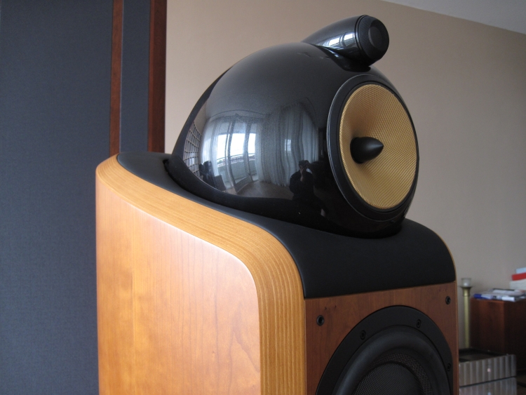

Sorry for reviving an old thread, but I'm not sure I understand. Are you saying diffraction is not an issue because the radiating surface is large? I'm sorry I am new to diy audio
I can't say I see eye to eye with Keyser's post. If one were to use a circular baffle with a sharp edge, diffraction effects would or could indeed be terrible (but very early in time). The Nautilus discussed here doesn't have circular baffles with sharp edges though. In fact, it's shape flows gently from the cone outwards. One could view it as a horn/waveguide turned inside-out. This spreads any kind of diffraction ripple and minimizes it where it counts, in the frequency curve on and off axis. The transition from 2Pi to 4Pi is as smooth as it can be with a baffle like that. A good simulation program, like ABEC can simulate the difference between a circular baffle with sharp edges and a more flowing shape with a sphere like shape that holds the driver like we have here.
To help smooth that flowing shape even further, the midrange of the B&W speakers of subsequent models (like the 800D1) had a surround that doesn't stick out.
In the days of the Nautilus design, still with Laurence Dickie on board, B&W had a lot of attention within their designs to avoid the negative effects of diffraction, using smooth shapes like these. Dickie resumed to design speakers with features like that at Vivid Audio.

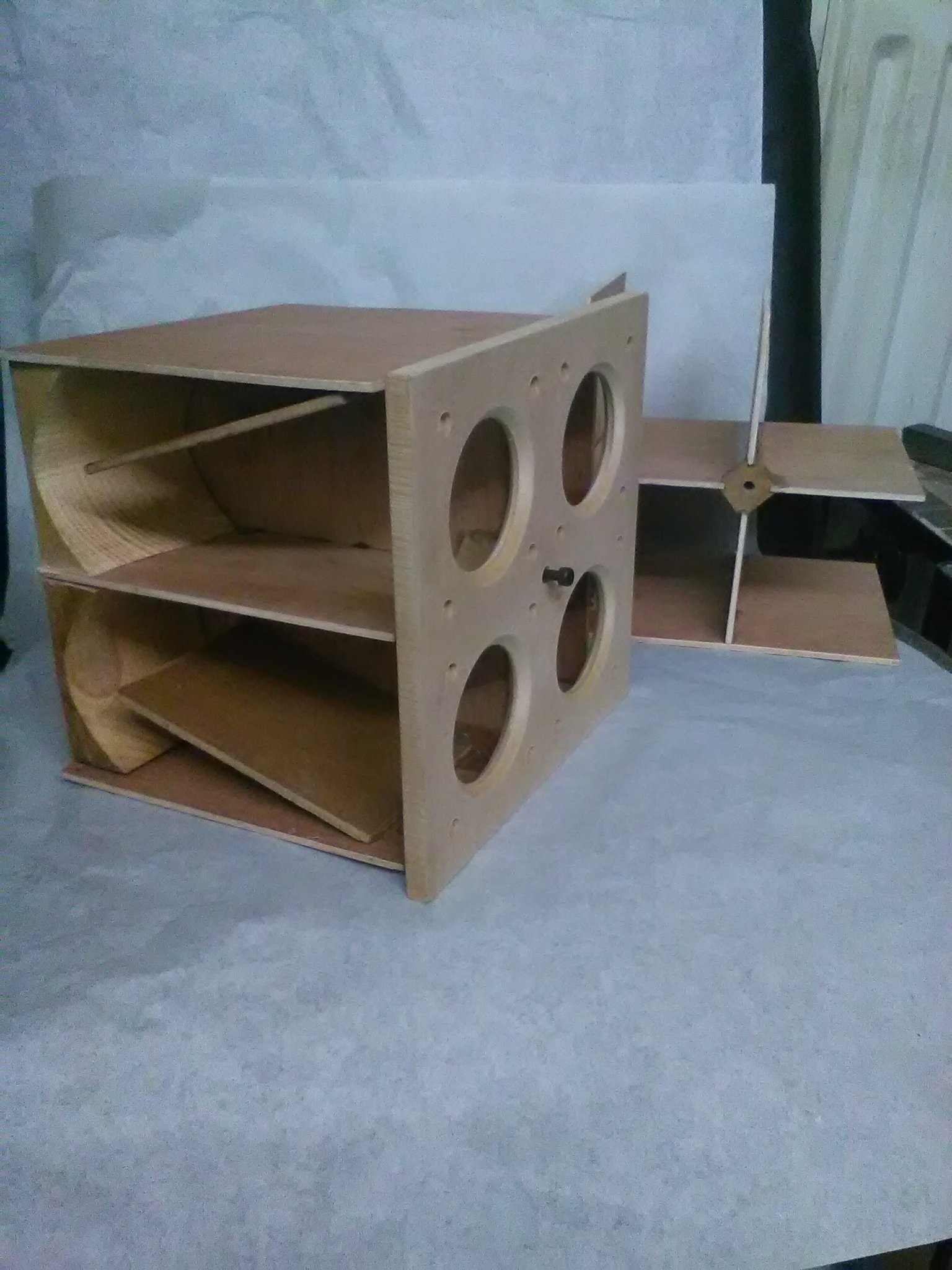

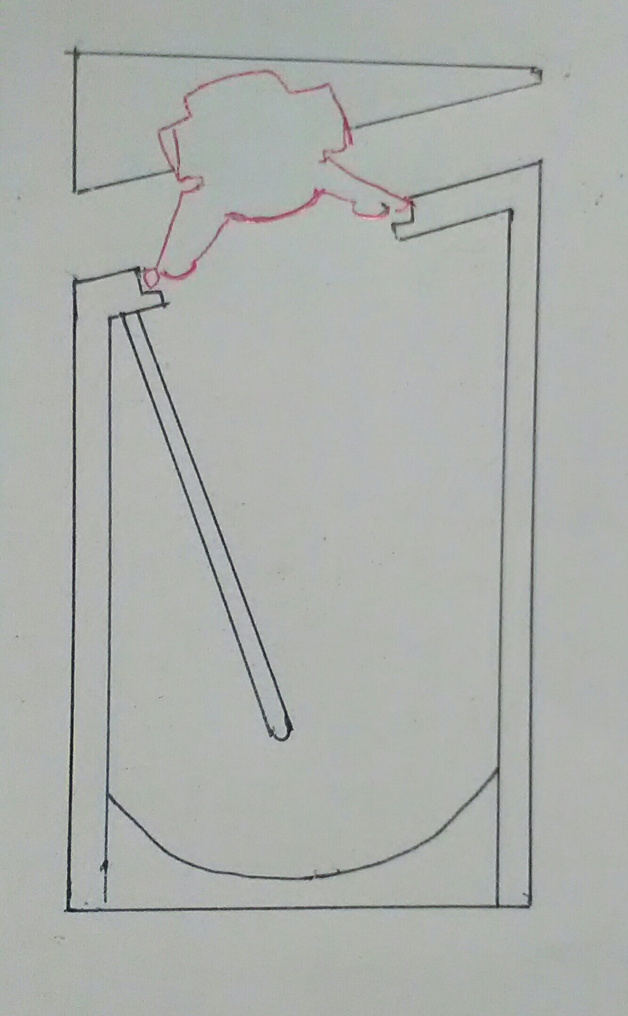

I've tried all sorts of ways to absorb the rear wave, holey baffles, Christmas tree diffusers, ladders - but some of the last speakers I've made have had folded wedge shaped boxed, this also adds a stiffening brace. They both have much better imaging than anything else that I've made, and I think the next speakers will be based on the same principle .
View attachment 1087445I've tried all sorts of ways to absorb the rear wave, holey baffles, Christmas tree diffusers, ladders - but some of the last speakers I've made have had folded wedge shaped boxed, this also adds a stiffening brace. They both have much better imaging than anything else that I've made, and I think the next speakers will be based on the same principle .
Did this cabinet end up sealed?
Yes, all four compartments are sealed, and the top left ( on the left hand channel ) is connected in series with the bottom right, the bottom left is connected with the top right, but the bottom left is shorted by 2 uf capacitance, and then both pairs wired in parallel; they're connected like this to avoid beaming, and it seems to work. I intend on fitting an acoustic ( and cosmetic ) hood.

Well, I can categorically say - NO! - the previous speaker with the folded wedge was an omni, the driver was mounted "magnet out " so the cone radiates the sound very evenly, so the exact opposite of directional, and that imaged very well also; the only thing in common ( apart from they both need a sub to fill in the bass, the omni much more than the quad cube ) is the folded wedge. They're only folded for convenience of construction, I did make two triangle speakers. Of course it could be a coincidence that two different speakers with wedges have good imaging, perhaps it's easy to get an omni, or directional speaker to image, perhaps it's just more technical to get a " middle ground " speaker to image well.
