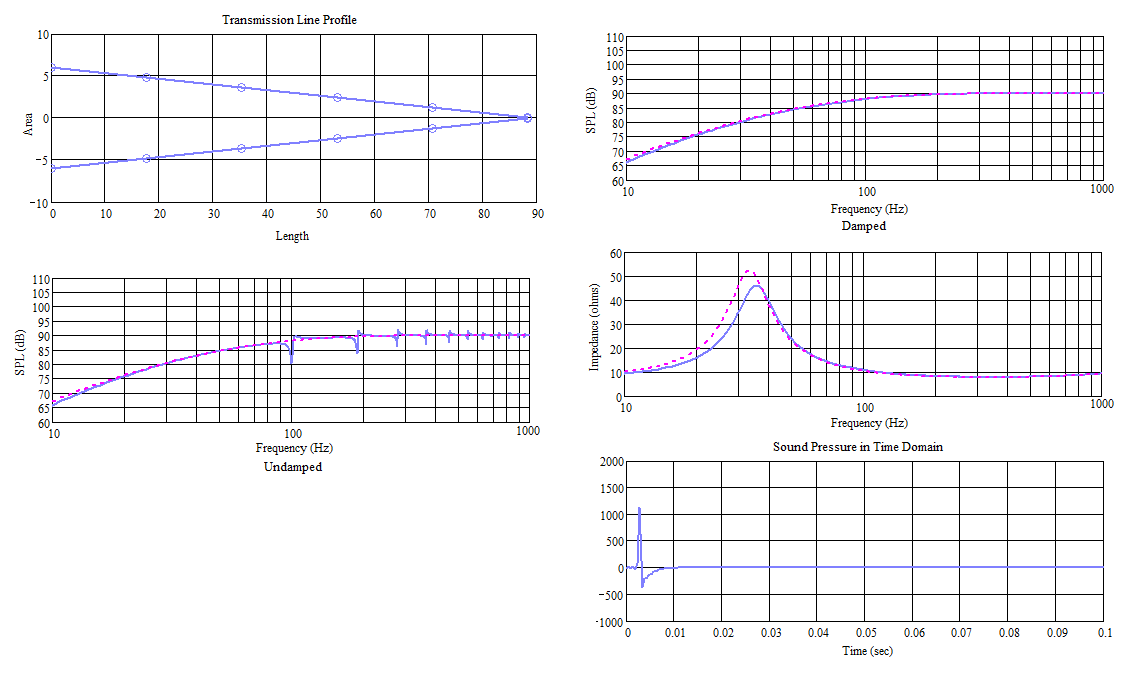

There still seems some misunderstandings on this thread. If a sealed TL exhibits such hideous resonances as has been claimed, would someone like to explain how the completely undamped lines I posted above (which I deliberately left completely undamped purely for clarity) are supposed to be so horrific, since a very small amount of damping material completely kills those modes?

Thanks for that, Scott! That is certainly powerful evidence that attenuation reduces the ability of the reflection to come back out through the drivers.
Progressive damping is required to avoid reflections from the change in acoustic impedance. How to do it well is widely studied because it is needed on absorbing boundaries both experimental, e.g. anechoic chambers, and computational, e.g. CAA and some forms of CFD, which have had whole conferences dedicated to the subject. This doesn't mean a small amount of constant density damping material in an overly long pipe won't perform OK but it isn't the optimum way to do it.Assuming the object is to attenuate the backwave, progressive rate damping can be very useful for short lines (open & sealed) as it reduces the possibility of mass-loading the driver diaphragm / suspension. Longer sealed lines typically don't need much.

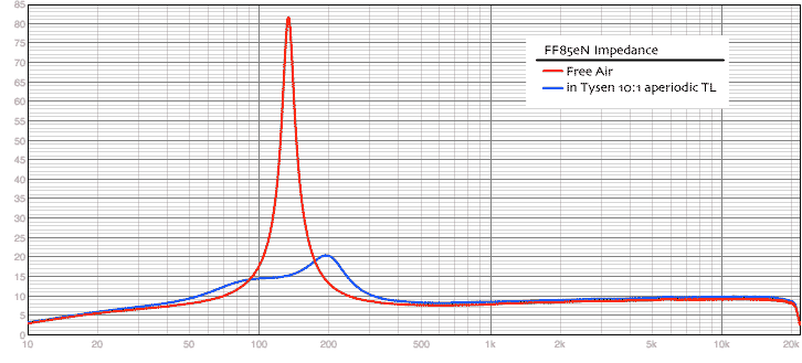

They have an openness that is often missing in a sealed enclosure, althou to be fair they are usually larger than what most would use sealed.
The impedance peak is highly attenuated. From the first version of Tysen.

The current version, Tysen V2, is even better, and all the parts are current. Same midTL but has 2 Silver Flute W14 in a Woden specified ML-TL.
