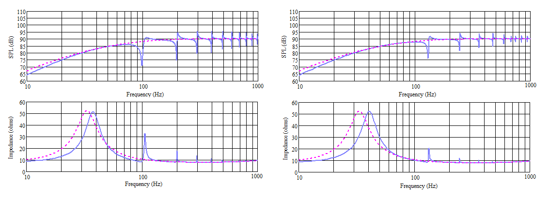

"A sealed TL = a 1/2 wave pipe (i.e. a pipe sealed at both ends). Often used for midrange enclosures as an alternative to a simple sealed box, although sometimes, as in the case of the Nautilus, used for the LF also. Not novel, they've been around & used for decades. "
Ok, so half of what? Cant you just make design the depth very deep?
A pipe closed at both ends functions as a 1/2 wave resonator, the fundamental occuring at 1/2 wavelength of a frequency detemined by its axial length & any taper that might be present. The amplitude of the harmonic modes is also affected by the pipe profile. For example, figure 1 attached. FR & impedance of two sealed pipes of the same volume [nearly], and the same axial length, end-loaded by the same drive unit, left undamped for clarity.
Left column = untapered pipe.
Right column = 6:1 [contracting] taper ratio pipe.

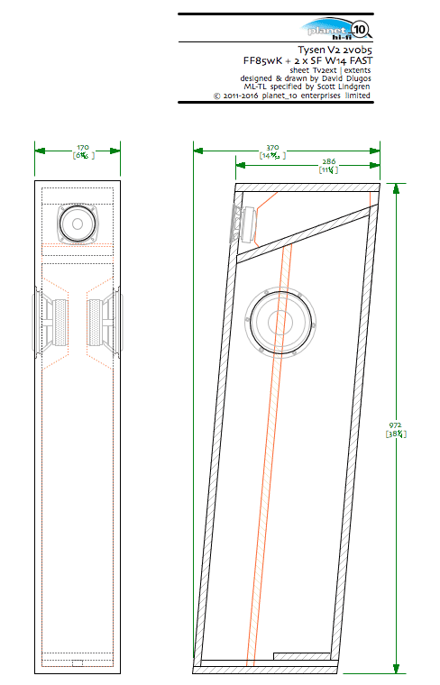

Here is one of ours. Heavy taper to minimize length (or more accurately to be able to maximize the available length). Bass is 2 5.25” push-push ML-TL. XO 250-450 Hz.
dave
With a midrange or midTweeter TL (i call them midTLs) your goal is not get bass extension, its purpose is to suck up all back wave so that none comes back thru the cone. Damp more densly towards the terminus. You are aiming at an aperiodic alignment.
dave
