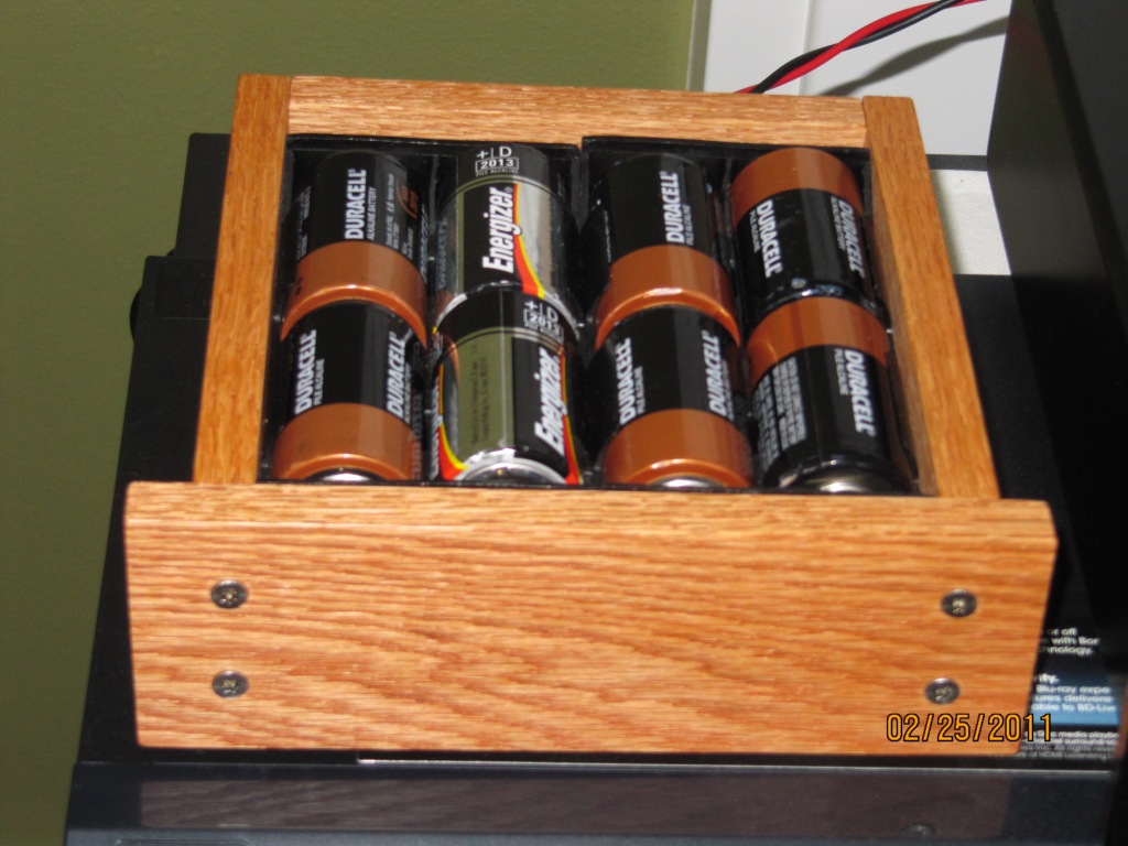

Up and running battery pack...the diy cable is a repurposed CAT6 with connectors for an SLA battery supply.

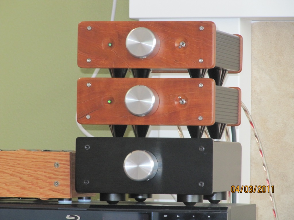

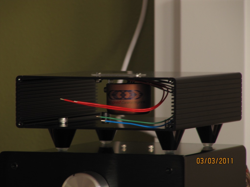

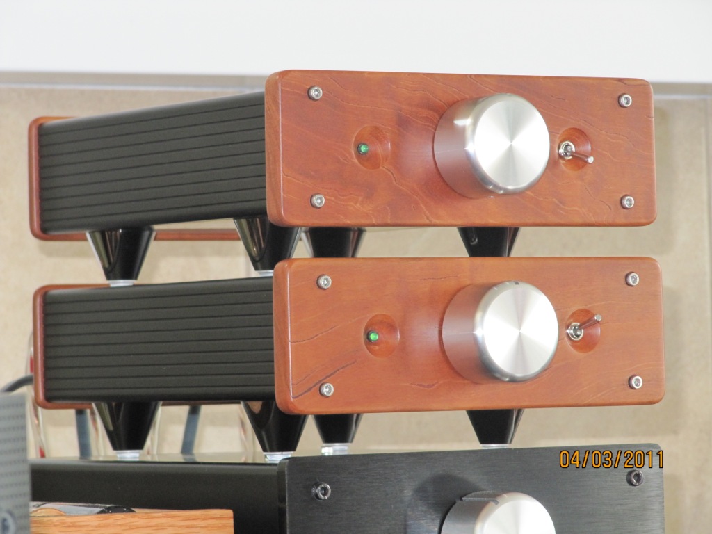

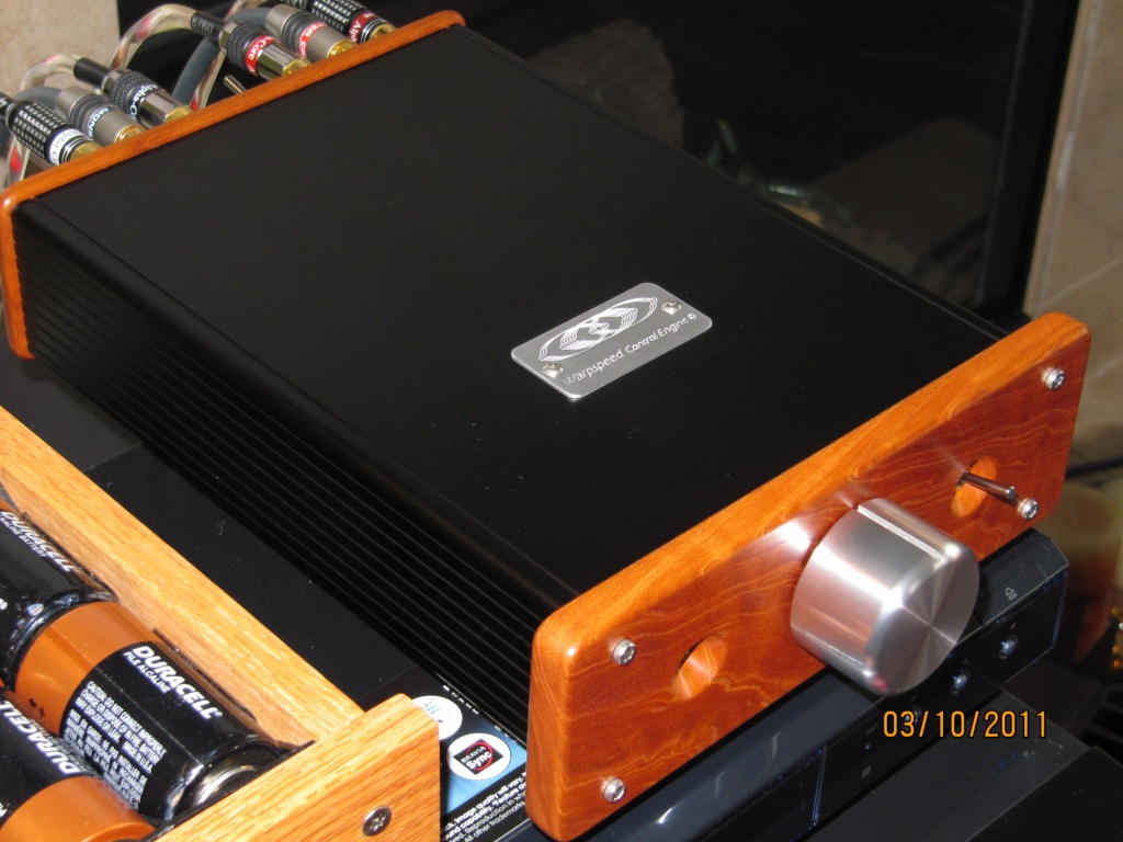

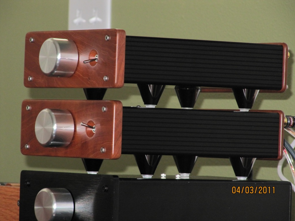

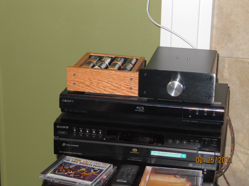

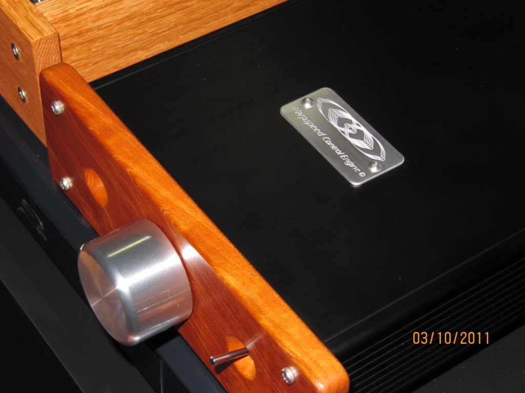

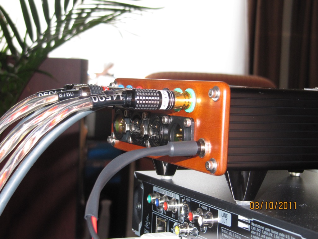

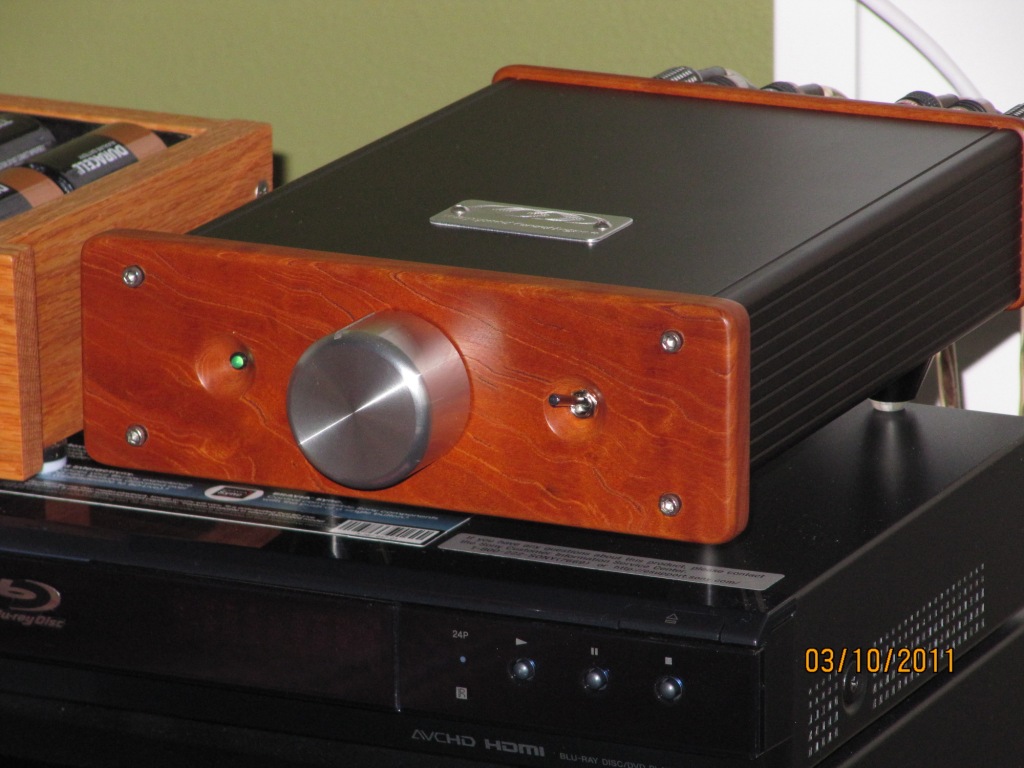

To answer several queries, here's a brief description of the completed Warpspeed (pics above)...
*It has a switchable Balanced/Unbalanced functionality; XLRs Pin 1=Signal Gnd, Pin 2=+, Pin 3=-
*2xQuad matched Silonex optocouplers
*Unbalanced has 1 input with 2 outputs paralleled for bi-amping; XLR pins 3 and 1 are shorted via a switch for Unbalanced
*It can be DC powered with an SLA battery at 12V with 5Ah or more capacity
*The power switch and power indicator flank the volume control in front
*The feet are machined black chrome stainless steel; the 'Squid is now in copper; the chassis body is anodized extruded aluminum; the volume knob is a 1.75" lathe-turned aluminum; the connectors are gold-plated Neutrik; silver on copper alloy contacts on switches; wire is silver-coated copper in PTFE (Teflon) insulation on 'Squid; and panels are cherry finished in oil and wax from an OR craftsman...planted a cherry tree this year to replenish😀.
Due to 2x quad matched optos being harder to come by, and my desire to get the product right, this Balanced/Unbalanced version is available as a completed unit only. Please email or PM for availability...Thanks!

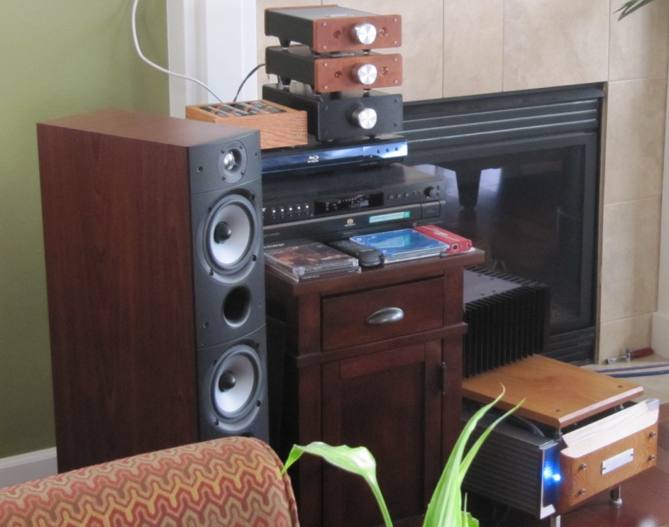

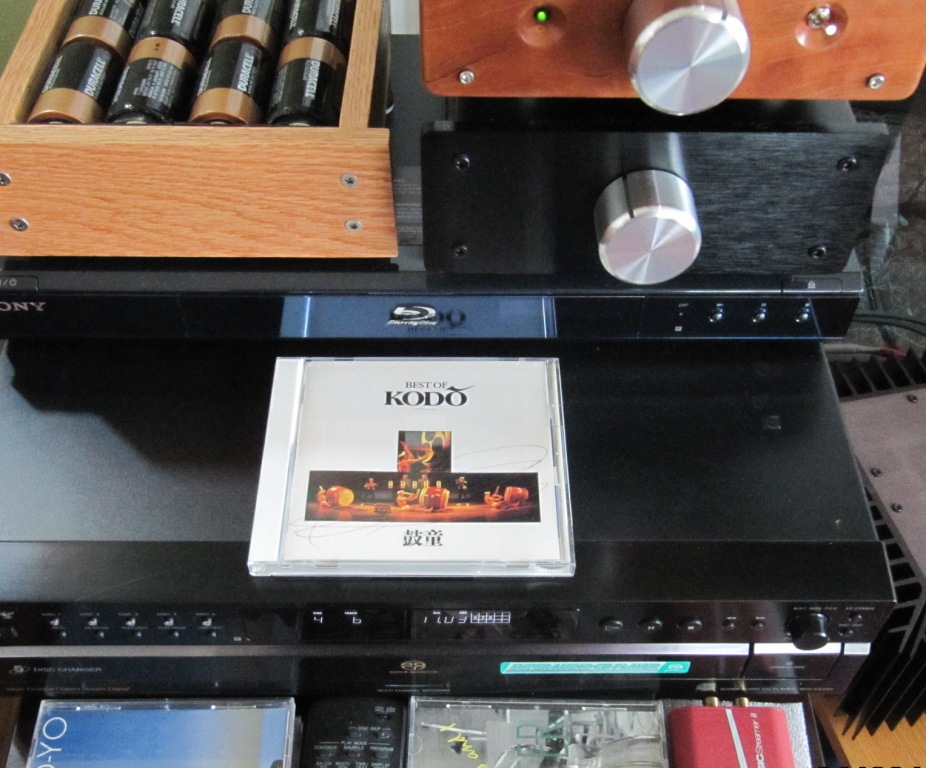

Here are some pictures of a newly completed unit getting a workout with Kodo (taiko drums) which is also my tribute to the Japanese people's resiliency and discipline in the face of tragedy and hardship. Picked up the cd in Akihabara during my visit in '98...very warm and respectful people.
