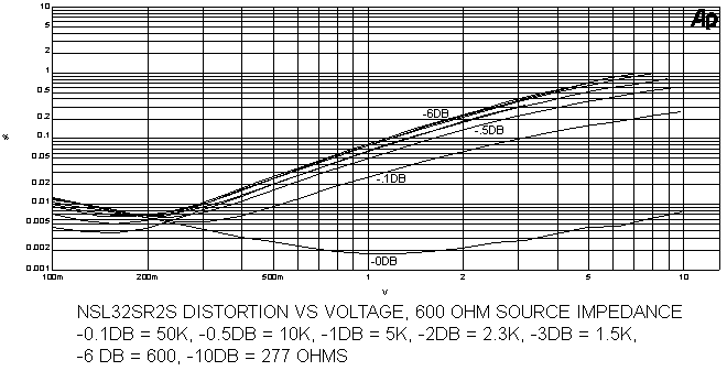

"measures badly" I would not consider .01% 2nd harmonic a bad measurment, at full level 0dbu from a cdp which they never reach on normal cd's it's still only .1%.
Then consider the lack of distortion "diode rectifcation effect" a pots wiper contact gives which can't be measured, this is why so many say the Lightspeed is the cleanest full bodied sound they have heard. Trust your ears as well as the analysing equiptment.

Going back to these postings by Mr. Pass http://www.diyaudio.com/forums/anal...uator-new-passive-preamp-134.html#post1520950 and the attached %THD vs V curves...if you look at it, most systems would operate in that valley region up to 0.5V.
With an amp with a gain of 10 this would already be 5V at the loudspeakers very loud even for moderate speaker sensitivity. Voltage peaks this high will only be instantaneous hard drum whacks very short in duration so it's not like you are listening to a continuous 0.025% distortion like if it were a sine wave fed into the amp. An F5 at gain of only 5 will also be already loud.
Correct me if I'm wrong Mr. Pass, your test set-up was the 600R source with a shunt LDR? Will there be an improvement with series-shunt LDRs' distortion cancellation especially at series LDR = shunt LDR values?
