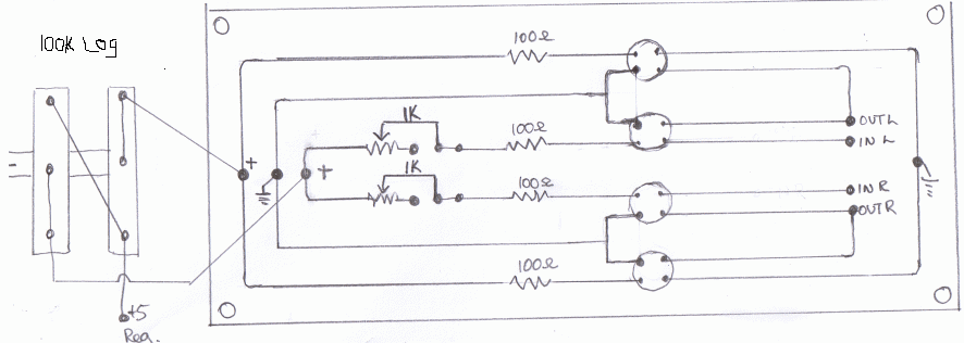

Hi Ondesx,
The pdf shows the shunt connected to + and -. How will that change the sound of the balanced ldr pre? Is the shunt controlled by the pot? That doesnt make sense to me. I am looking for circuits to improve the ps of the ldr preamp. The 2 posts you point to do not have any circuit info. I am not that knowledgable about this stuff but am willing to learn. I find the single end ldr pre I made sounds very good and would like to finish the balanced one someday soon.

Well, there are two different ways to go balanced. One is the schematics you already have, the second is the so-called "floating balanced" which is represented on my figure.
The two series and the shunt are controlled as they are in your own circuit, i. e. series in one polarization and shunt in another. In this approach not only you'll save 2 "matched" components but it is easier to control.
You have to "imagine" that "a virtual ground" is somewhere in between the bridge figured by the shunt LDR.
Perhaps to help you understand the things in a very simplistic way, please go do it with "fixed resistor values" (not LDRs) for a given attenuation factor... You'll see that the voltage of the +/- input side is really attenuated by the expected value at the output side...
The best way to understand is to experiment...
The 2 posts you point to do not have any circuit info...
I'm afraid that even if I provided the circuit this wouldn't help you unfortunately, because the heart of this attenuator is something not easy to deal with in fact...
Suffice to say that the "linearity" and "stability" of LDRs are far from to be the "better parameters" of these components. As you probably are aware, it's necessary to always give an adapted current to the LDRs for ALL the attenuation steps. There is no "analog method" which delivers "continuously" the correct currents for all the working range (this is what was tempted through the potentiometer method...). Then you must either "manually" or "automatically" determine these values. Last, all these data are stored and used for each required attenuation.
It'll be near impossible to derive a correct working balanced device for all the attenuation range by the use of a good potentiometer, even a very good one and even by the use of the "floating balanced" approach... Unfortunately.

A much better schematics for balanced LDR use in audio is presented on the following figure... Then you just need 6 instead ! A working high precision stereo balanced LDR based on this circuit is presented in the LS thread posts #3703 and #3705.

Ok, I looked at the pdf.
Now please explain to me what's so special about it?
To me it looks like standard series/shunt configuration with current sources?
I'm doing current sources as well, I have a big knob (well actually two since I have balance as well) and distortion due to a psu shouldn't be a problem if you know how to design a psu?
It's possible I'm missing something here but I'm just not seeing anything special?
I don't want to be a bad sport, I'm just not seeing it? Please explain?
