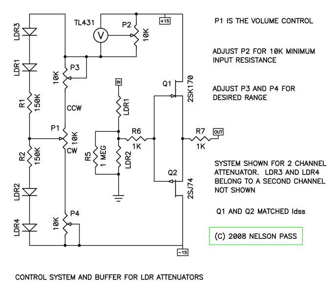

Blues, is this the circuit you worked out with Nelson over on the lightspeed thread, circa post #1360's?
Thanks,
Russellc
Hope not as it's got copyright, illegal to use for monitory gains
Cheers George

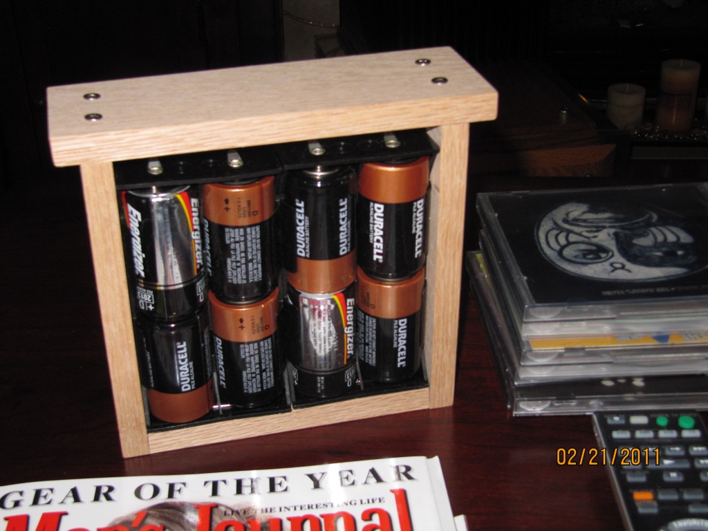

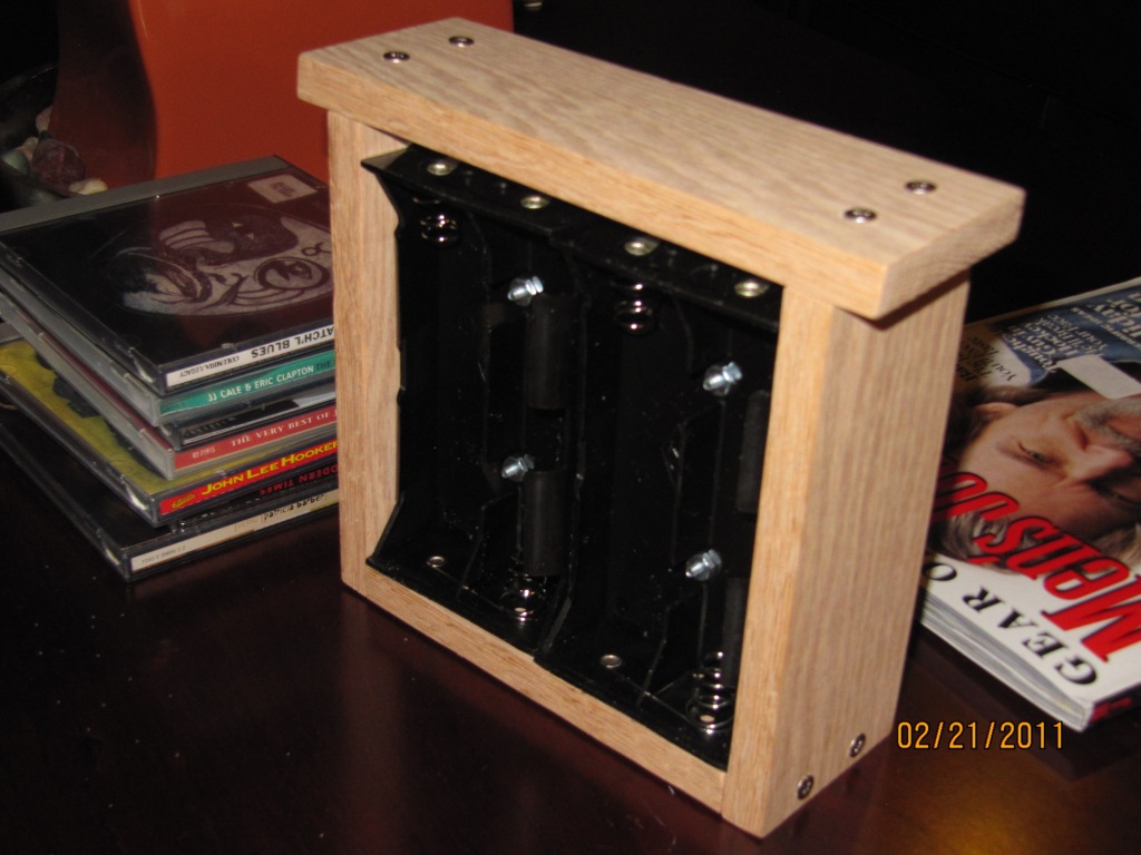

12V Battery Pack
Here's what I just built for the alkaline batteries...it will be wired up series and parallel 12V//12V.

I'm not sure if we should worry about slew rate with a pure DC supply. It also does not supply an amp or a circuit with fluctuating voltage/current demands...so no caps here. The DC supply is also not in the signal path.
Thanks for the quick answer. I have to admit, that my experience with battery packs is limited to my RME ADI-2 DAC, which can be easily driven by different kind of AC- or DC-sources. I ran it with 18V selfmade battery packs. The performance became very clean (duh!) and more coherent, but also a bit dull. With the original supply the show was far more direct and fast, not to say a tad more aggressive. So I changed back to the supply. 😉
A few months ago I got the chance to run the DAC with commercial cap-bypassed battery packs (made by Thel Audio Germany) and considered this solution "the best of two worlds".
Just some subjective impressions. Of course a DAC is a totally different kind of device. I'm still a greenhorn technically and happy to have the chance to learn at this excellent place. 🙂
