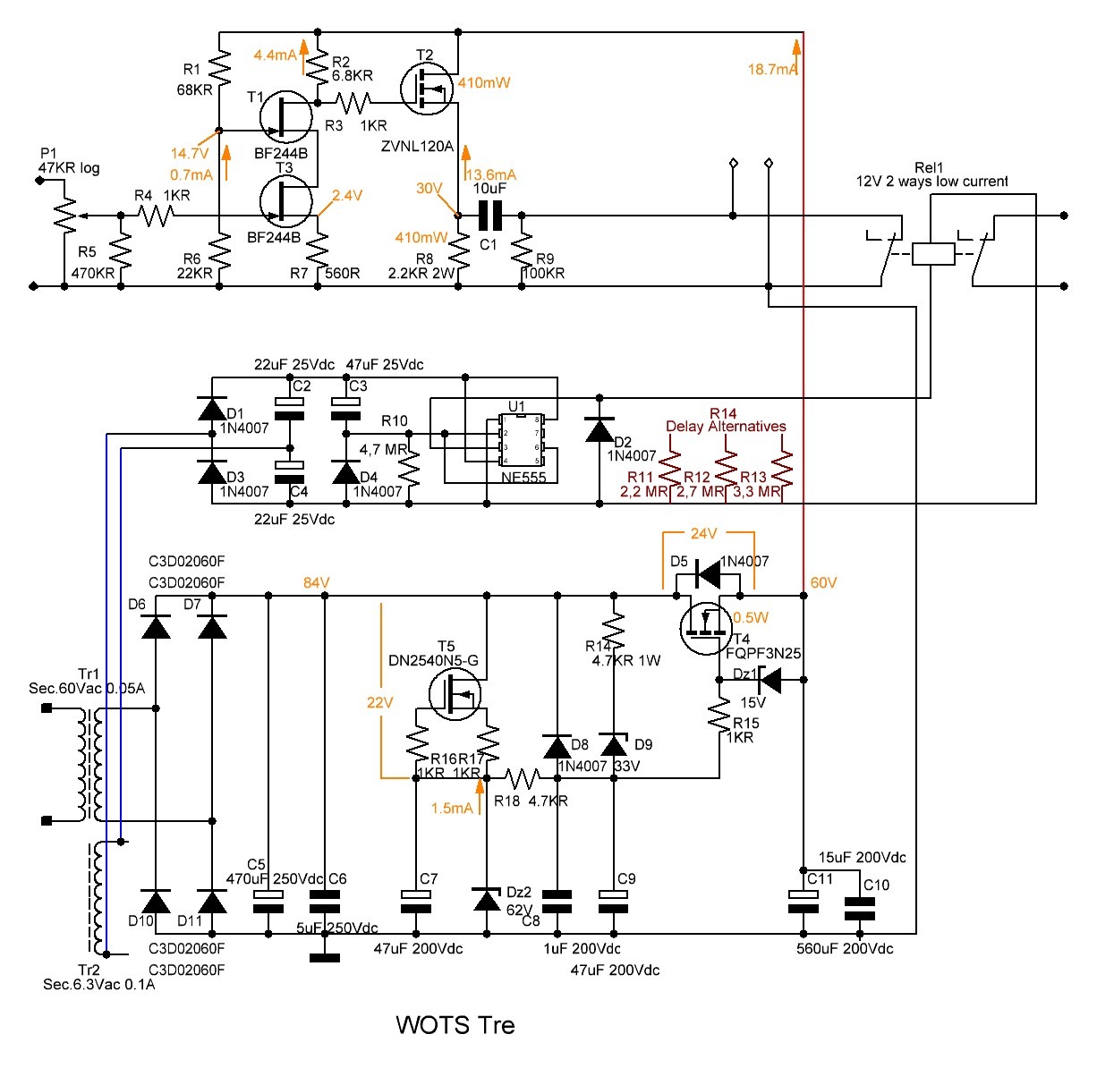

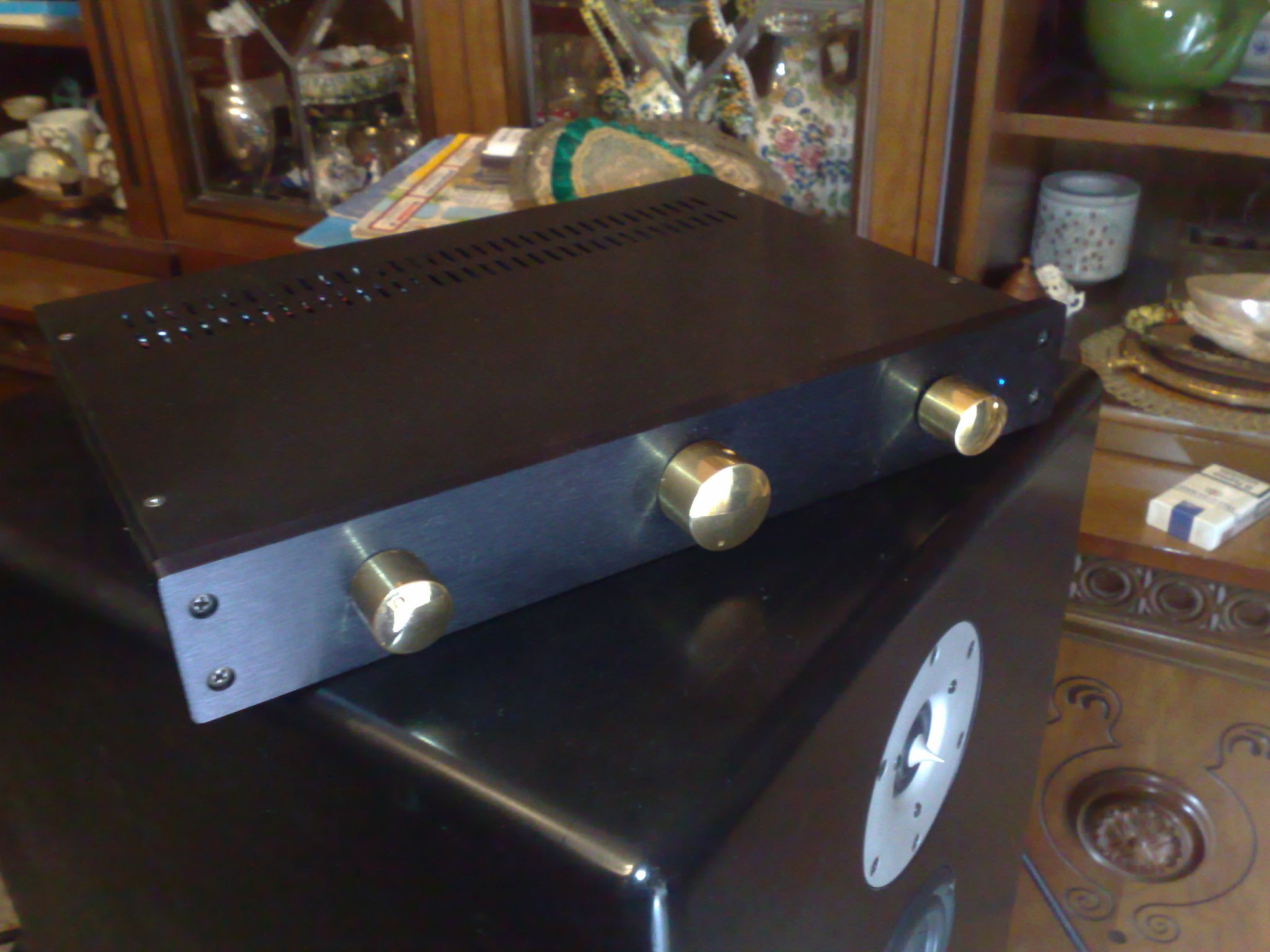

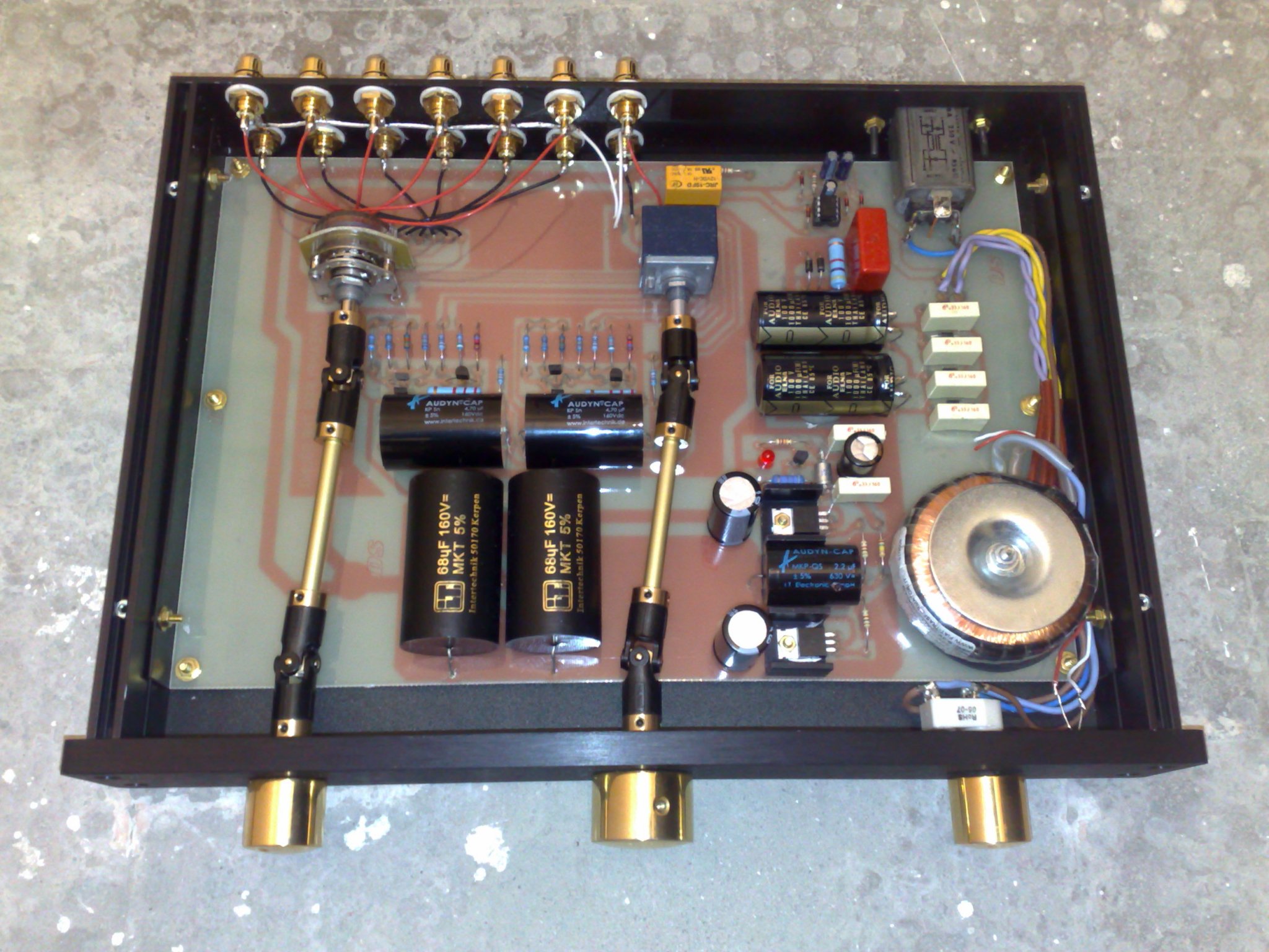

Here are the schematic and 2 pictures of the WOTS Tre in a tiny cabinet. The build, at that time, 2008, had only one power supply to feed both channels. Should I build it again nowadays, I probably would choose a dual mono configuration.
I designed the Tre for a friend of mine who was in love with the LeGrand version but didn't like to work with tubes. We spent a whole day choosing the resistors on the cascode (R2, R7) until we got the same sound as the LeGrand version. The Cout we used was an MKP aluminum foil AudinCap.
The bad: the semiconductors used were obsolete even in 2008, nowadays you can find them only on eBay. For buying these semiconductors I would trust eBay. Or you can try newer components, just keep in mind the features on the datasheet of BF244-B (A and C versions are not suitable) and select a T2 mosfet with a very low input capacitance. I tried mosfets also on cascode but I didn't like this solution, JFETS are a lot better.
Trimming: R1 or R6 must be chosen to have 1/2 Vb (30V +/-10%) at the source of T2.
That's all for now. Let me know if you want to go on in a PM, I have the PCB Layout and the schematic both in CAD version and some suggestions. I do not want to bother here some susceptible fella.

can a BF245B be used?
what would be the max Vpp output with decent distortion?
Would 20VPP be possible?
The BF245 is not perfectly the same but it seems you can use it without changing the Tre's sound, provided it is the BF245-B version (the pinout could be different).
I didn't measure the maximum possible output voltage. I think it will be possible 15Vpp. It is not designed to drive a buffer, its gain is something more than 20dB, if you increase it you will lose the musicality. But you can try.
I'm designing about driving a buffer, I'm using Aikido's schematic with 12AX7 followed by a 12AU7 with a Vb of 300V; I'm sure it will allow a clear 110Vpp output voltage with a gain of something more than 30dB. So the output Vpp is a little more than Vb/3. For the same reason, the WOTS Tre should sport a 22Vpp output.

Perfect I will try it. 15vpp is plenty for my high sensitivity speakers.
For the output mosfet, would an irfp610 have too much gate capacitance?
I read the datasheet of the IRFP610: the Cinput is 120pF, not bad. But, actually, you do not need a power transistor as a follower. Very important is to have the lowest possible Cinput. Remember: you are following a cascode, which has a very good band, but a very high output impedance. I wouldn't change anything, using components very different from the original ones.
I forgot to mention, you have to select the JFETS in order to have Vb/4 at the common point Dlow/Shigh. They cost$5 x 10 pieces on eBay, so it is not a problem.

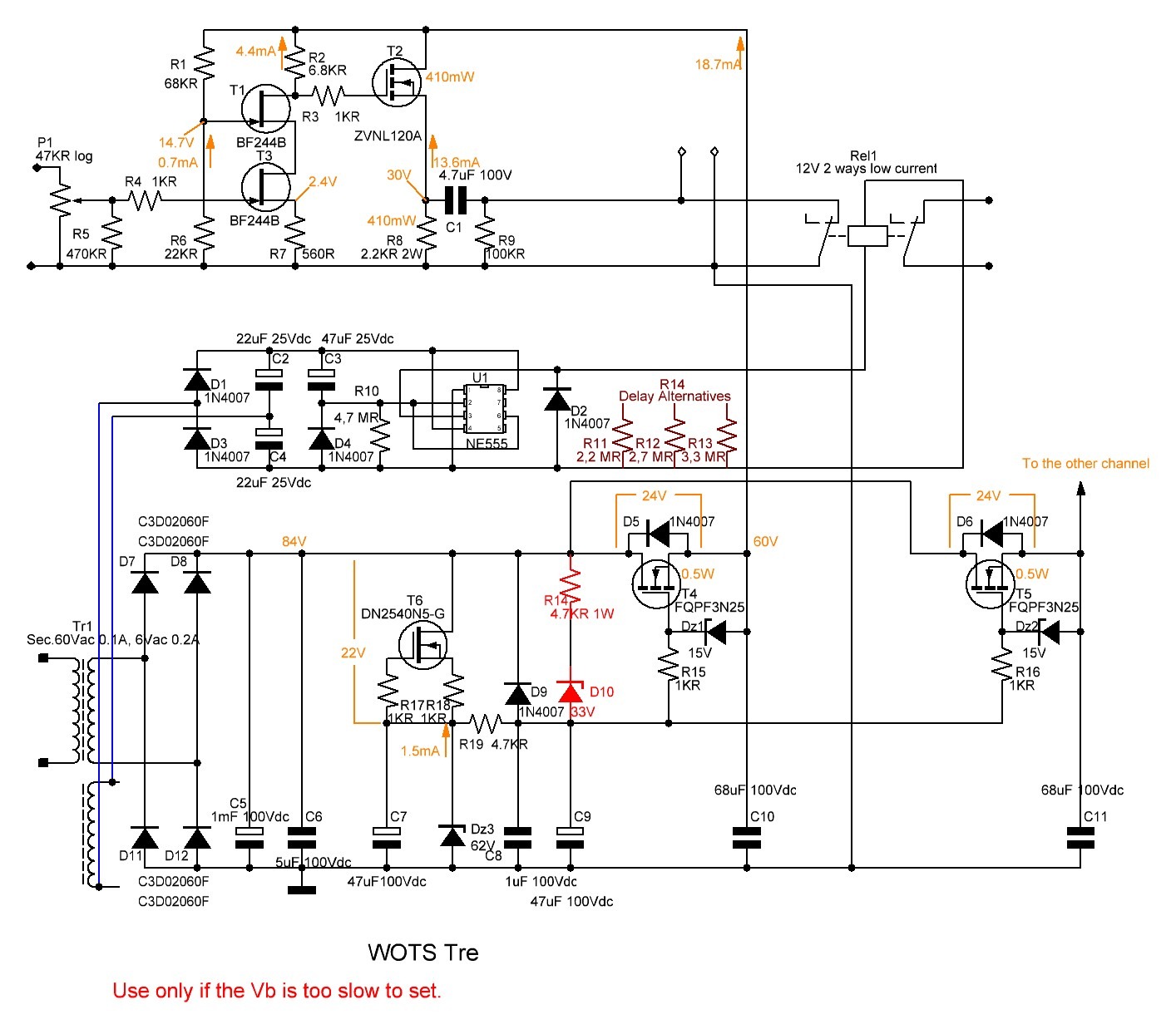

I must apologize, the Tre schematic had some errors in the Power Supply section because I copied the Le Grand one. The schematic here enclosed is a better one. Being a Class-A design, a Dual Power Supply is not as important as in Class-B designs. A double regulator can be used as well.

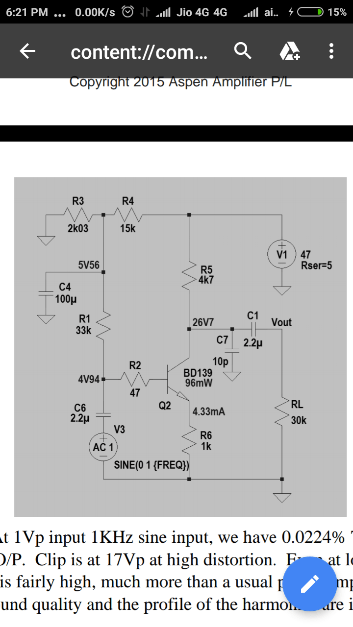

Another preamp that should give warmth to the sound should be ths but never tested. Credit to Doug Shelf
I don't know where you live, the BF256B is available also on US eBay, but you have to pick the right seller. They are not available on Mouser and Digikey.
D.Self is one of the best audio experts, I studied on D.Self's "Audio Power Amplifier Design Handbook, 6th Ed" when I worked on a Dartzeel NHB-108 clone. Take a look here: https://www.diyaudio.com/community/...matic-build-this.134362/page-105#post-6819080 . The schematic is a little tricky, if you are interested, I documented the building step by step with pictures and have an easier-to-read schematic. A folder I can send to anybody interested in building that monster.
About the schematic of D.Self you posted: I really like D.Self, but in this case, I would add a buffer to the BD139.
