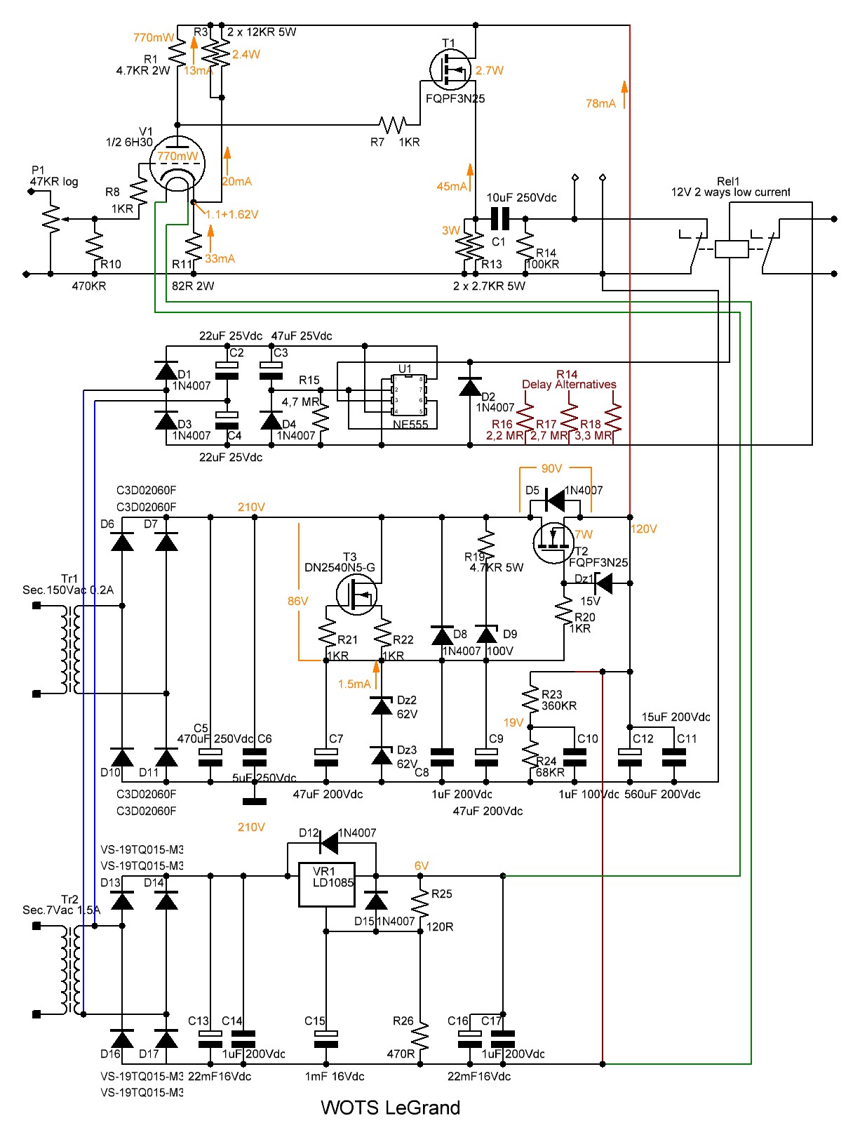

I stop here, the schematic speaks for itself. A handful of components ... not so much a "handful", not the components runnning in your drawer, but high quality goods. There would be a lot to say about a simple topology with unconventional configuration, but I will do only is somebody is interested and asks for it.

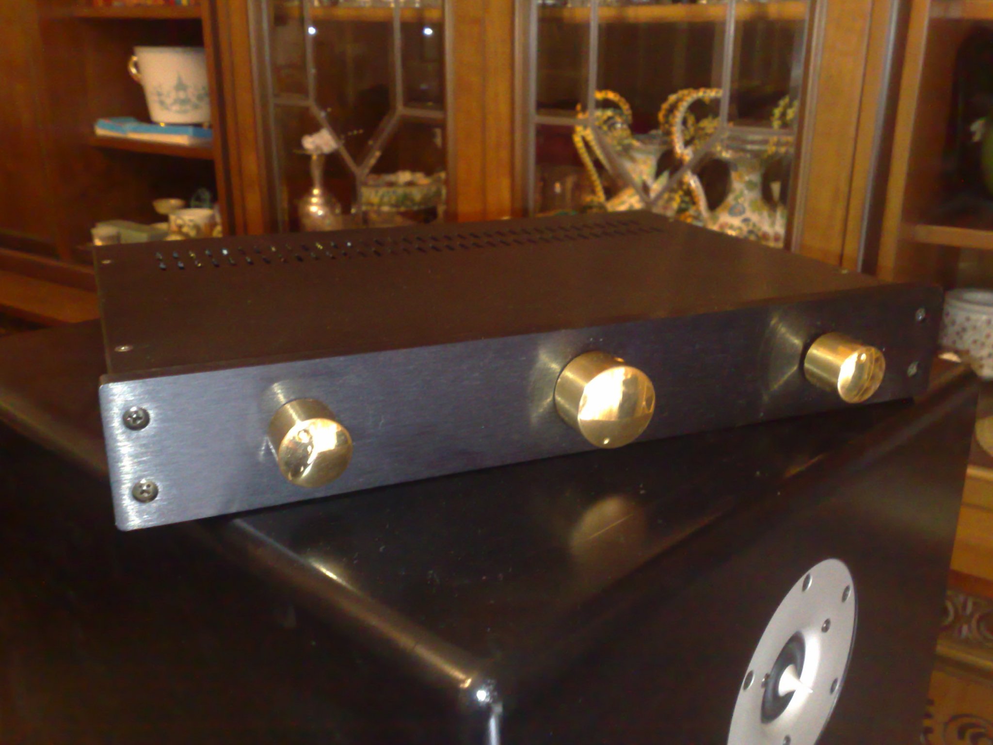

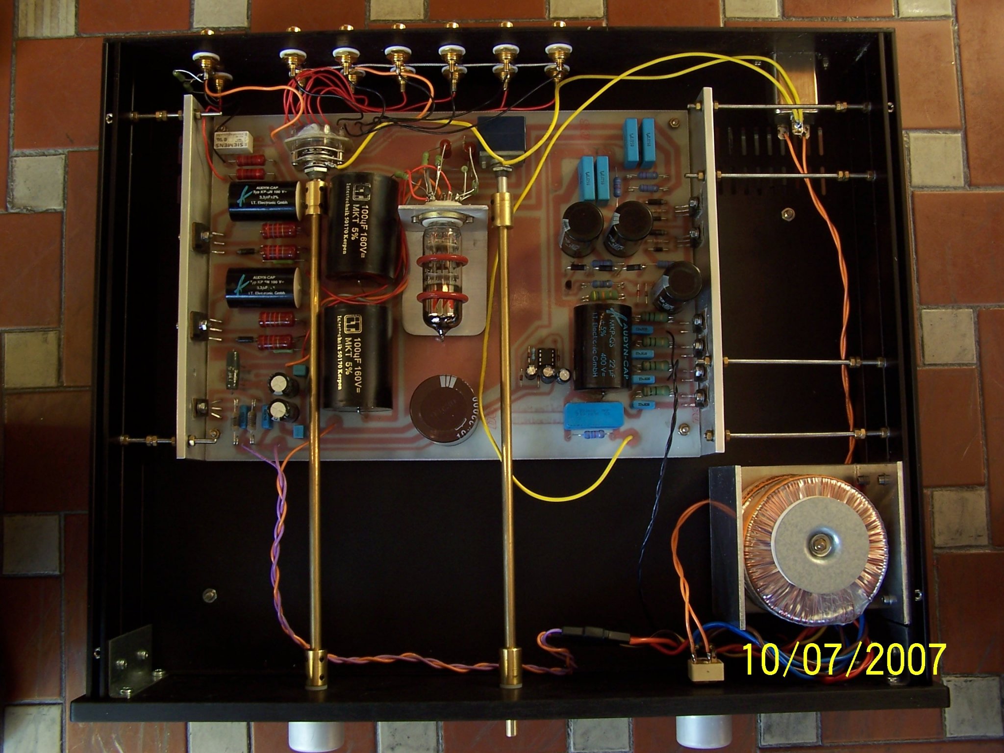

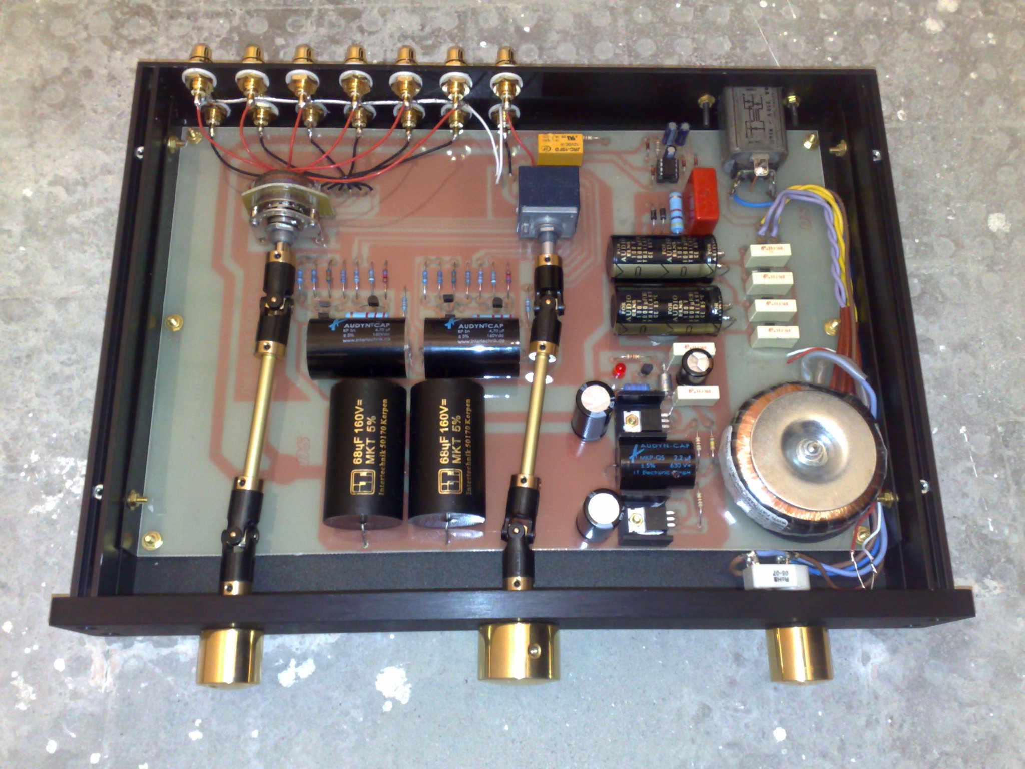

It was the year 2003. The pictures are related to mine, 2007 build.
You will excuse me if I don't dwell on it, if I don't tell you the philosophy of the project, the various phases of analysis ... The truth is that “WOTS LeGrand” was born as a joke! Just a couple of concepts put together.
The success of this joke was great among my audiophile friends and friends of friends. One of them, dear Franco, who now listens from up there, forced me to design a solid-state version because he didn't like working with tubes. But he asked me that its sound must have been the same. Thus was born the “WOTS Tre”, which we developed together during one whole day to find the polarization with the best sound, the same imprinting of “LeGrand”.
The delay you see in the schematic is mandatory, it shorts the output for a pre-configured time to let the eqipment settle stably.
Simple schematic, impressive sound. You have to try. Oh boy, you have to!

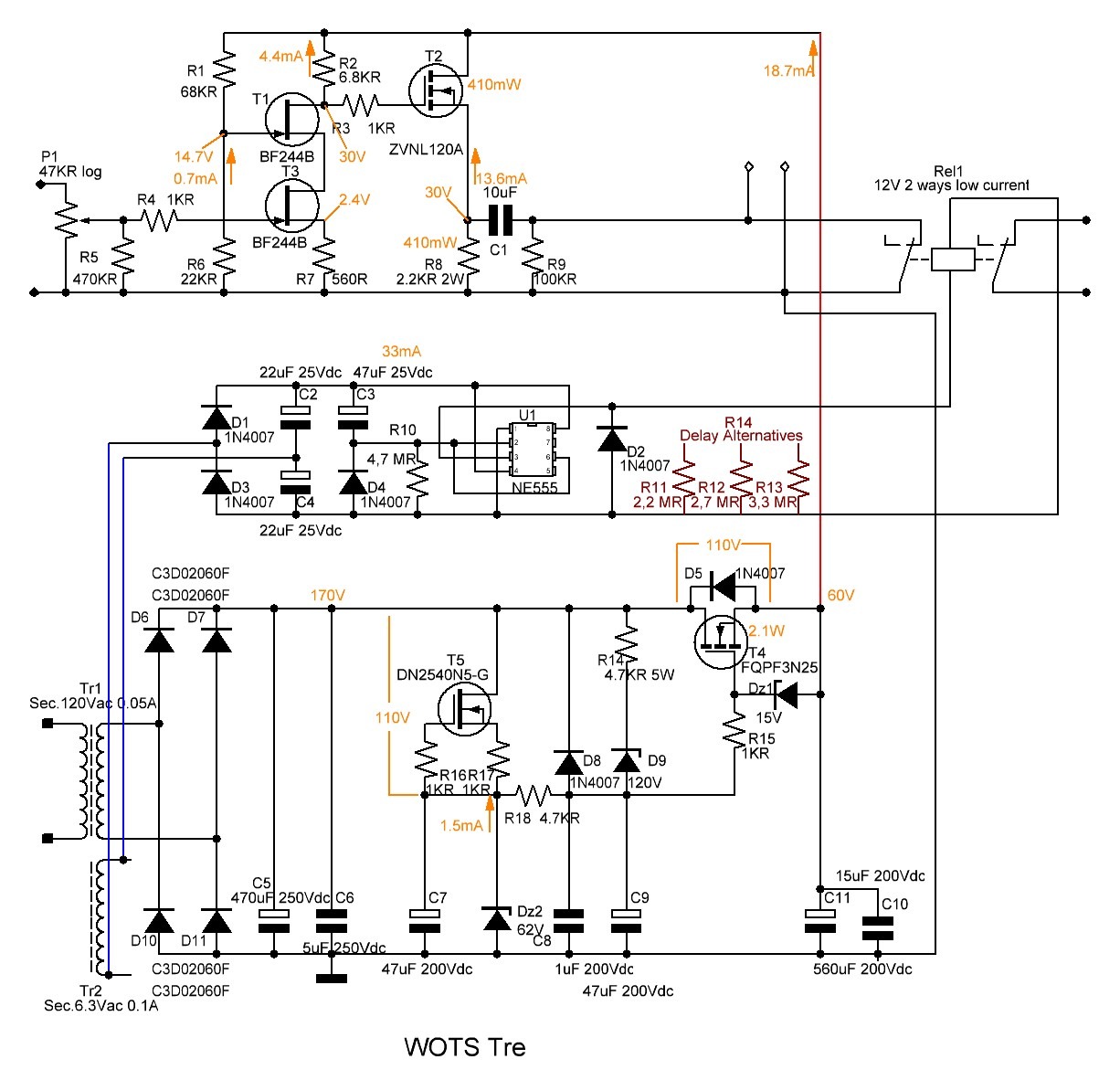

The sound shaping is made by the topology and, minimally, by the technology.
Look at the schematic of the "Tre" posted here: it has the same sound of its brother LeGrand.
The key points are two:
- zero feedback;
- current inside active components as high as possible.
Obviously, a good power supply is needed, my preferred is the "Virtual Battery".
Another important point is to limit the number of stages. So you have to forget about a non-inverting preamp because, if you want the input and output signal to have the same phase you should use a more complex long-tail or cross-coupled circuitry, or add another inverting stage. Take a look at the ARC LS22 schematic, for example, how complicated to have an inverting no-gain second stage to rephase the signal. I sure prefer to swap the speakers' connectors.

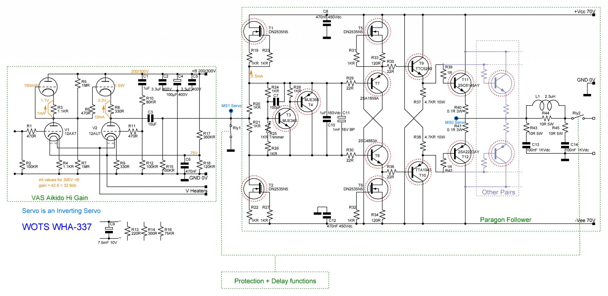

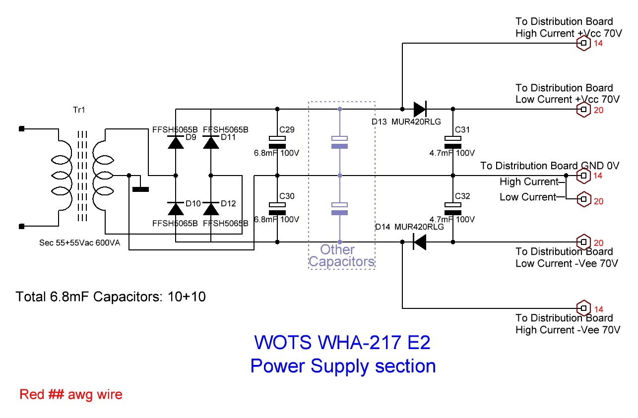

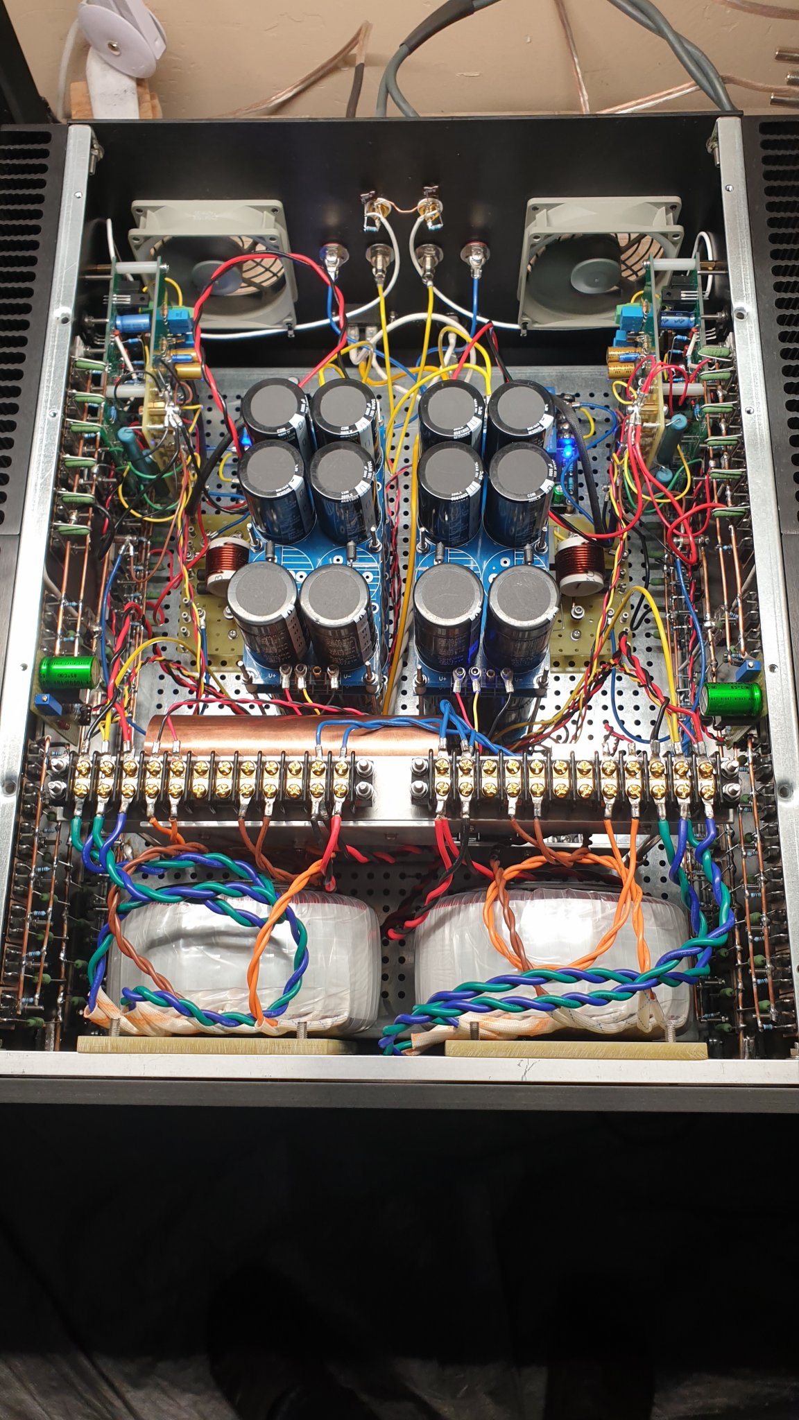

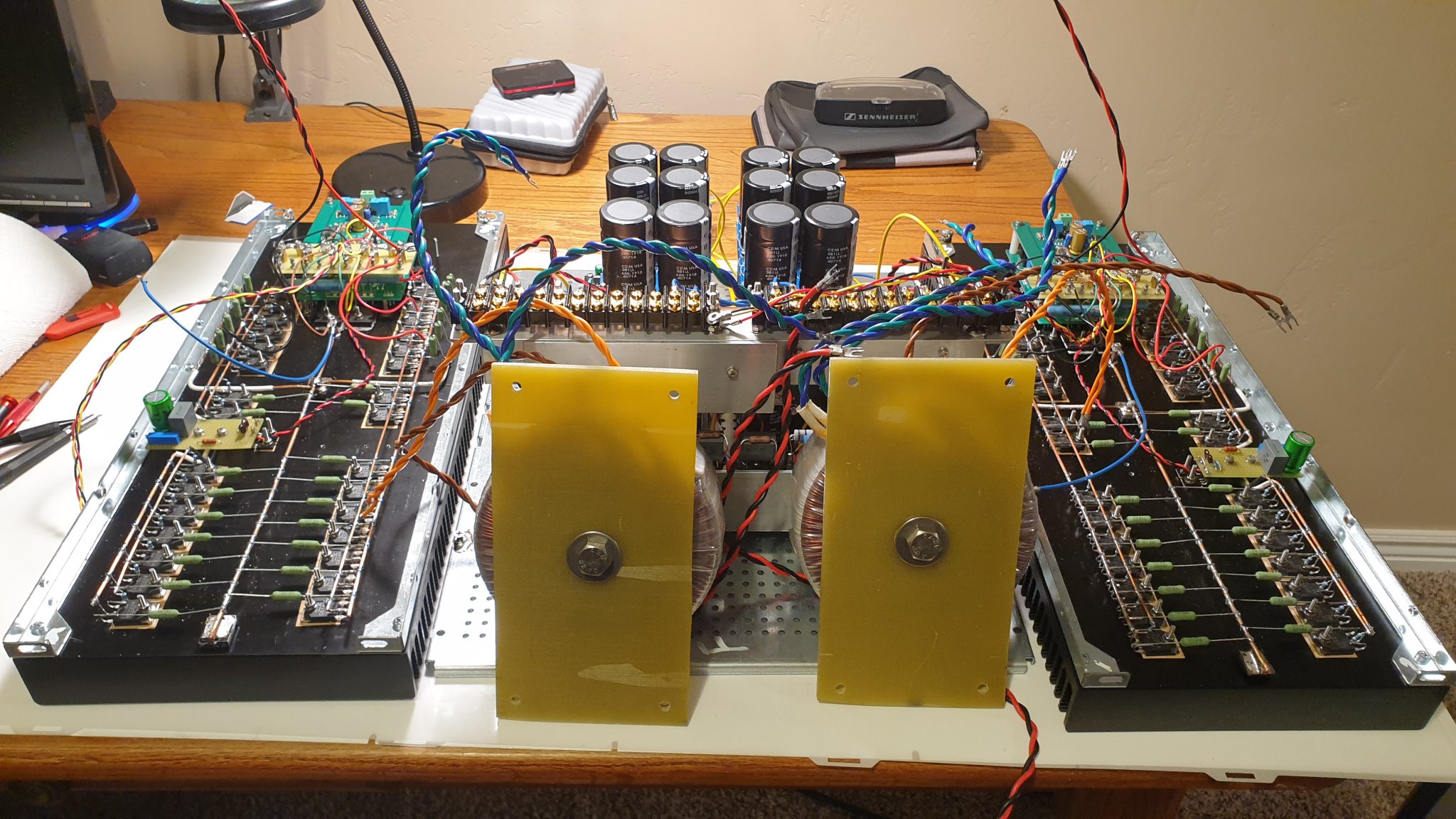

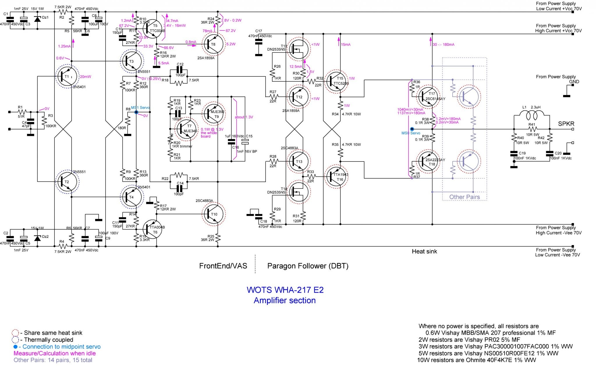

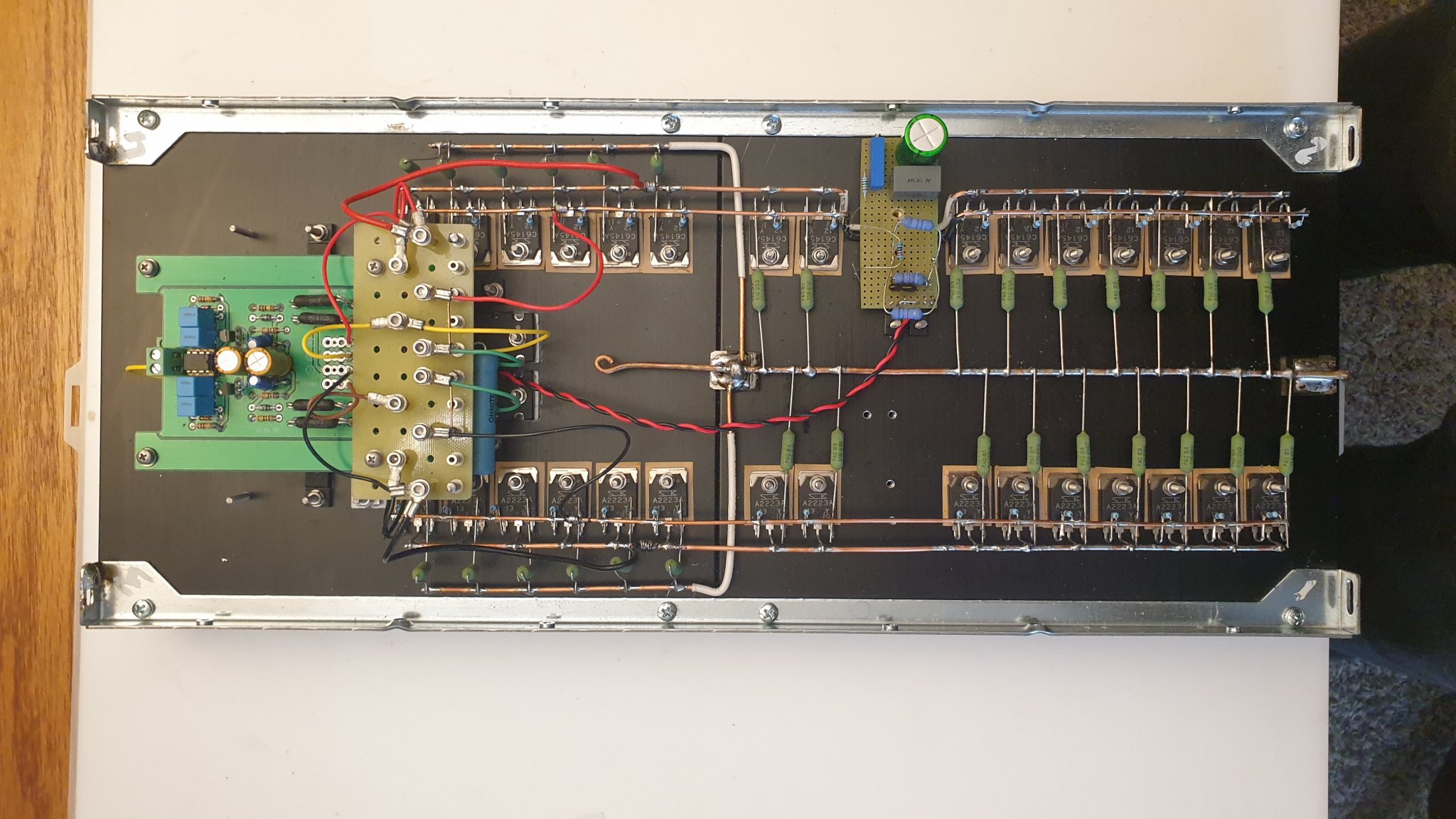

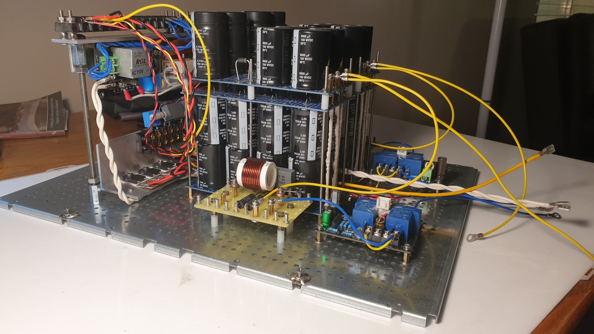

"WOTS WHA-217 E2" (was posted on NHB-108 thread).
This is a 200Wrms/8Ohm main amplifier I made on the NHB-108 base.
Main feature: no feedback from the speaker output.
Read the "Read Me First - WOTS WHA-217 E2 Project.pdf" document you find here enclosed.

Hi Marino,
Interesting, this WOTS legrand. Can you tell me what gain this preamp has?
kind regards
kind regards
It is a line preamp (or post amp according to someone's suggestion in this thread). Someone else finds it boring. I know, it seems to be the usual follower to anyone looking at it without any attention. Just another follower, I saw thousands!
I'm glad to receive your interest. As per schematic and values, its gain is around 20dB, perhaps a little less but it is suitable for the purpose. The key is to use a tube able to drive the capacity GS of the following mosfet.
