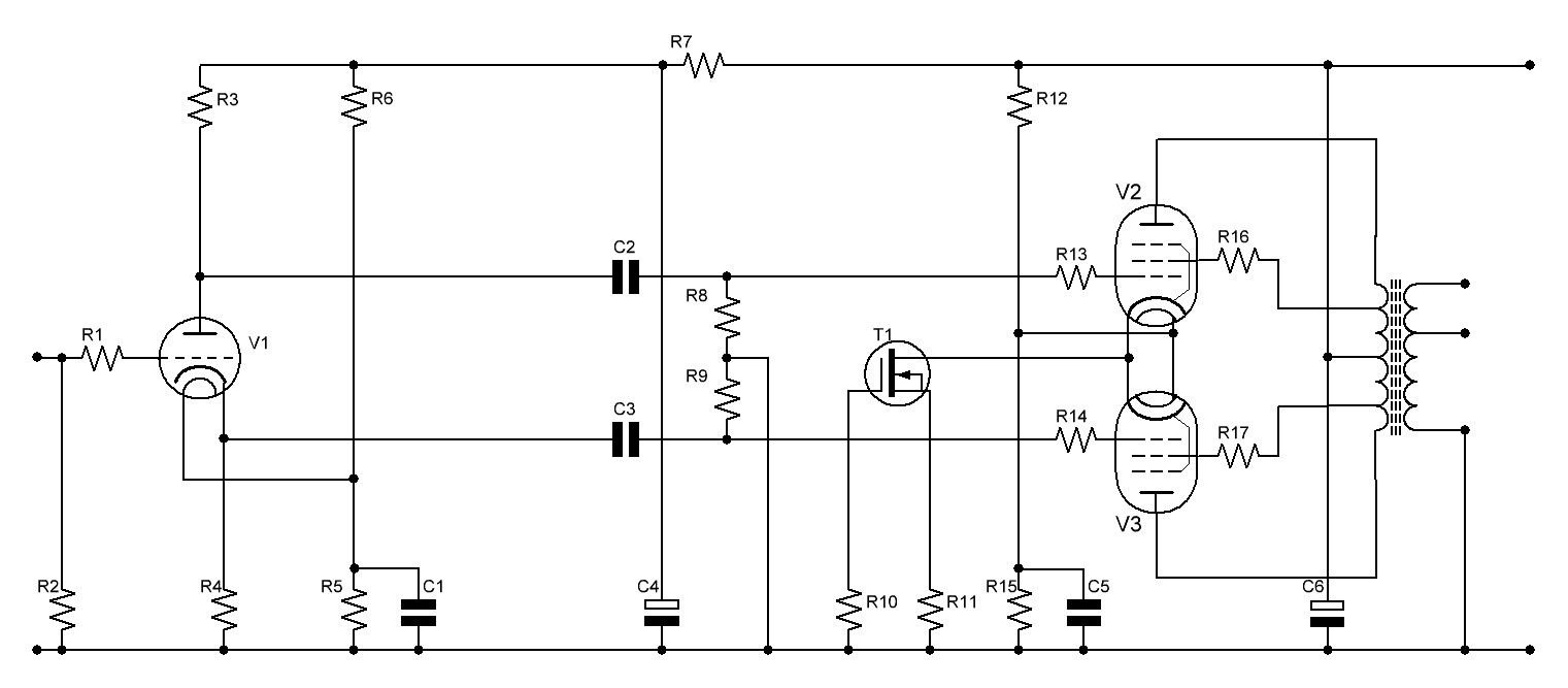

I was close to posting a new schematic with a particular approach, here it is. Boring too? It seems to be a cathodyne driving a UL class A stage... impossible. Or, maybe, is it another thing well possible? The sensitivity is line level. Perhaps not that boring.

In my neck of the woods WOT means "With output transformer" so I was expecting to see a thread about that. I was curious because I have designed a number of line stages with output transformers so I was excited at the prospect of reading about a new transformer coupled design. It seems needlessly complex for a 6H30 design with a follower output. The 6H30 by itself should be a pretty effective line driver given the low Rp, have you tried one by itself?

No signal transformers here, sorry! Yes, I did, here is the schematic http://www2.audiokit.it/ITAENG/KitElettr/AUDIOKIT/AkiLine1/AkiLine1.htm
But I was expecting something more. So I added the follower. Then I removed the negative and the choke. A lot better!
I must say I don't like very much output transformers with gaps. All SE I listened to 2A3, 300B... were punctually overperformed by something else, push-pull or OTL. I have no experience listening to a line stage with a transformer (with a gap).
