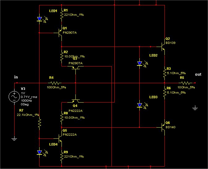

The SOTA buffer
I have run a simple simulation of the WJ Buffer and it's just Ok is it possible to tune it to a SOTA buffer I have attached a copy of the image from multisim I hope it will be visible,
Anybody who is in the design game look at it and give me some reliable tip.😎

The SOTA buffer
I have changed some resistors and transistors same results low distorsion I even changed the LED one or more between the bases of the output devices but no same results low distorsion.
I suspect it is something " voodoo" in this design something must be wrong or maybe it's the ultimate amplifier I will run it on my breadboard and do som serious measurements with my HP 3580A I will even run my PC spectrum analyzer to se if it is obscure hidden illnes into it.
